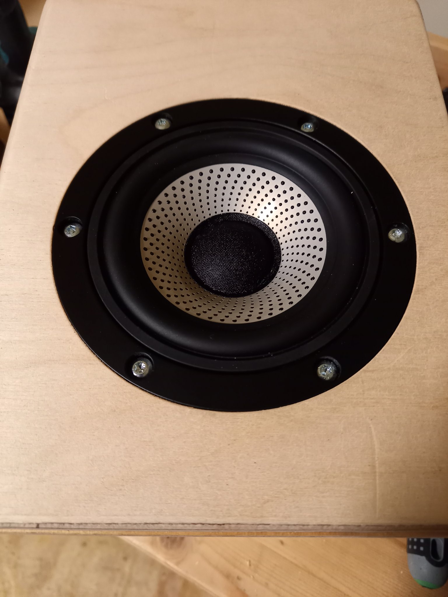

I recently built a pair of open baffle speakers with the Eton 4-318 ARCOSIA performing mid duty. It does sound fantastic. It has a very detailed and refined sound. Transients are fast and hard-hitting.
These ETON drivers are very easy to integrate into multi-way speakers because of their wide bandwidth. This allows me to use first order crossovers.
I have not heard the ScanSpeak Illumnators for comparison, but looking at the ScanSpeak frequency response they seem much harder to integrate, requiring more complex crossovers.
I would use the 4" again in future builds. I would also love to try the 7" Arcosia but the price on that one is really steep.

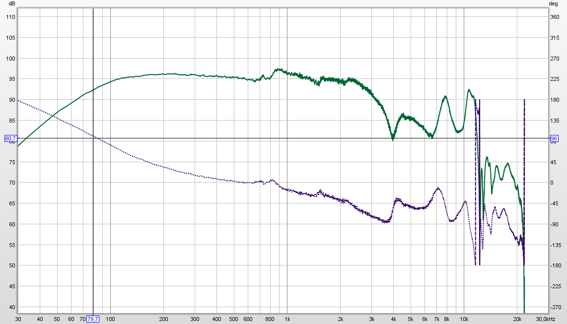

And here is the measurement results (eton arcosia 4-218) Testbox was closed 5 liters. 30% filled by sonofil.
Measurement level is set to 87db (about 2.83V). Desibels measured by desibel meter at 1kHz tone.
Nearfield response and phase
Response (1 meter) and phase

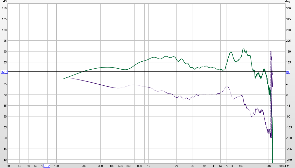

And polar response. (there was little techical issues and level is not same in all measurements, but you can see directivity from this)
Gating was 3,3ms, and No smoothing.
I listen driver at full range and it sounds quite good. Cone breakup is not sounding bad.
From the directivity measurements i think i can cross it about 3.0 - 3.5 kHz to T25B. (But this is another story)

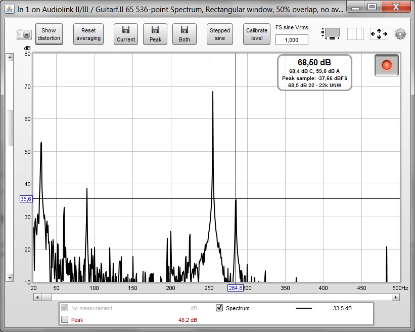

Arcosia 4-218 IMD measurements:
30hz + 255hz 4:1 (about 2mm cone excursion)
This is interesting. IMA2 (255+30) is at higher level than IMA2 (255-30). Something similar i have seen in this forum by dayton epique.
IMA2(255+30) is about -33 db level. and other side spetrum is -43 db level. Not as good as PTT4.0 but better than seas W12CY006
IMA3(255+60) is very low level (cannot be seen). But IMA3(255-60) is shown here at -46db level. So IMA3 is not that good as W12CY006 but at in same level than PTT4.0

Overall arcosia driver is designed to have very low 2nd order distortion to achieve low IMD distortion. (you can see from seas W12CY006 measurements how driver makes 2nd order IMD, and 3rd order IMD is always much lower level) That's why this driver sound so good when listen. Also cone is finely damped and having very little of stored energy. Arcosia also have better effiency than W12 or PTT4.0
