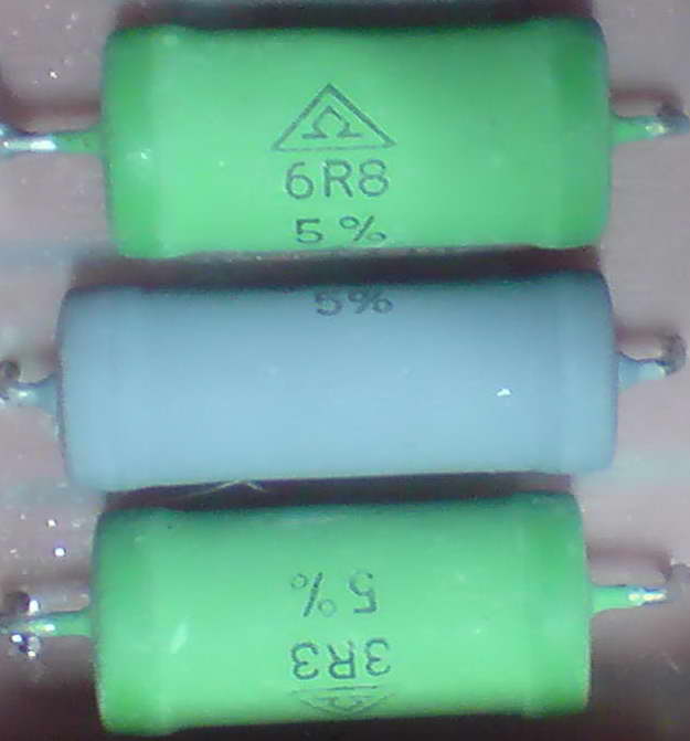

I need to source them but didnt know what brand, otherwise I need to change all (nearly 200psc) instead 4 burned
It have logo they remind me bennic logo or vishay, but i was not able to find them, but maybe somebody know it will help me a lot.

Thanks wrenchone, unfortunatley i wasnt able to find them on Roe. they have similar look to Vishay PAC ressitors at best. but they are not the same. Can anoyne tall which company logo is printed on theese resitors?

on our railroad we use 40-80 watt resistors for heat sources in gate motors ect to fight frost.
most have that stamp(triangle ohm sym)and name ohmite. might not be the right spelling. however might be sub contracted to a subcontractor ect..... so not sure if its helps.

Thanks I surfed throught ohmite website also its production on farnell with photos but no resitor have theese stamps neither look similar
I checked around, and those are "Resista" resistors, at least the one with the Omega symbol in the triangle for a logo. Roederstein was bought out by Vishay a while back, so those resistors aren't made any more, or maybe in a different form by Roederstein/Vishay subsidiary Draloric.
wrenchone, thanks again , I already searched yesterday for roedernstein resista, no results not even datasheet or pic.. 🙁 seems i will need desolder nearly 200 resitors

hm... enetred draliric and i see something very similar from apearance 🙂
VISHAY DRALORIC|AC05000002208JAC00|RESISTOR, 5W, 5%, 2R2 | Farnell Ireland

I will buy few and desolder few working genue and will measure in same paraleled chain to see if they behave similar under temperature changes. what is surprise that resitors i need is mountened in 2008 years manufactured product and I opened few others -they use the same resitors. either manufacturer like so much NOS resitors or they still are available. all other parts seems new and fresh brands..
I think Ohmite is correct.
Anyway those are very probably MOX (metal oxide film) resistors!
From the size I`d guess they are about 4W.
If so, VITROHM PO591-0 could be a replacement.
