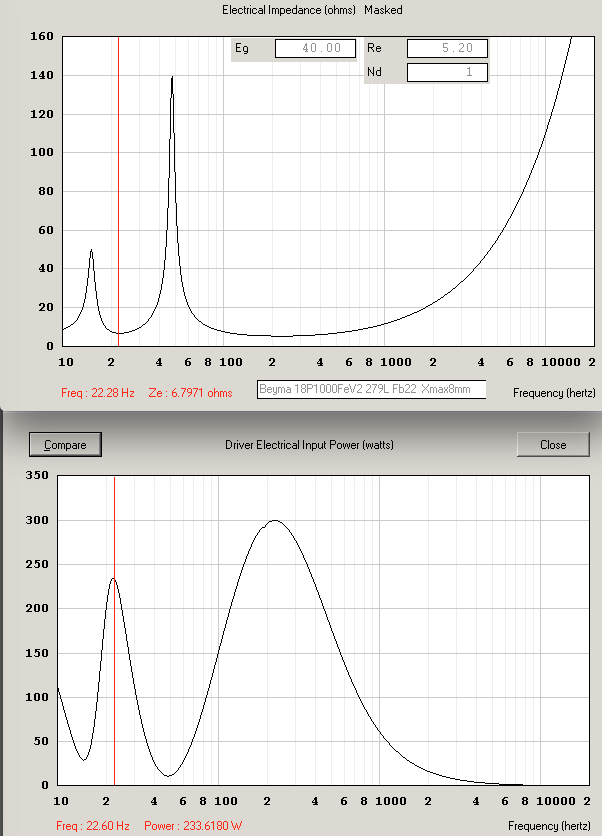

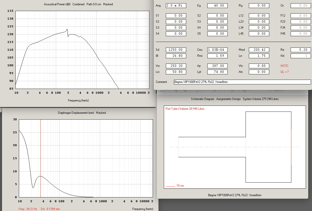

I am seeking your help on using Beyma 18p1000fev2 subwoofer for home theater. Is it good idea to tune the box lower, say closer to 22hz? It's for home theater. Spec can be found below

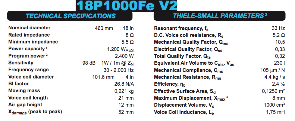

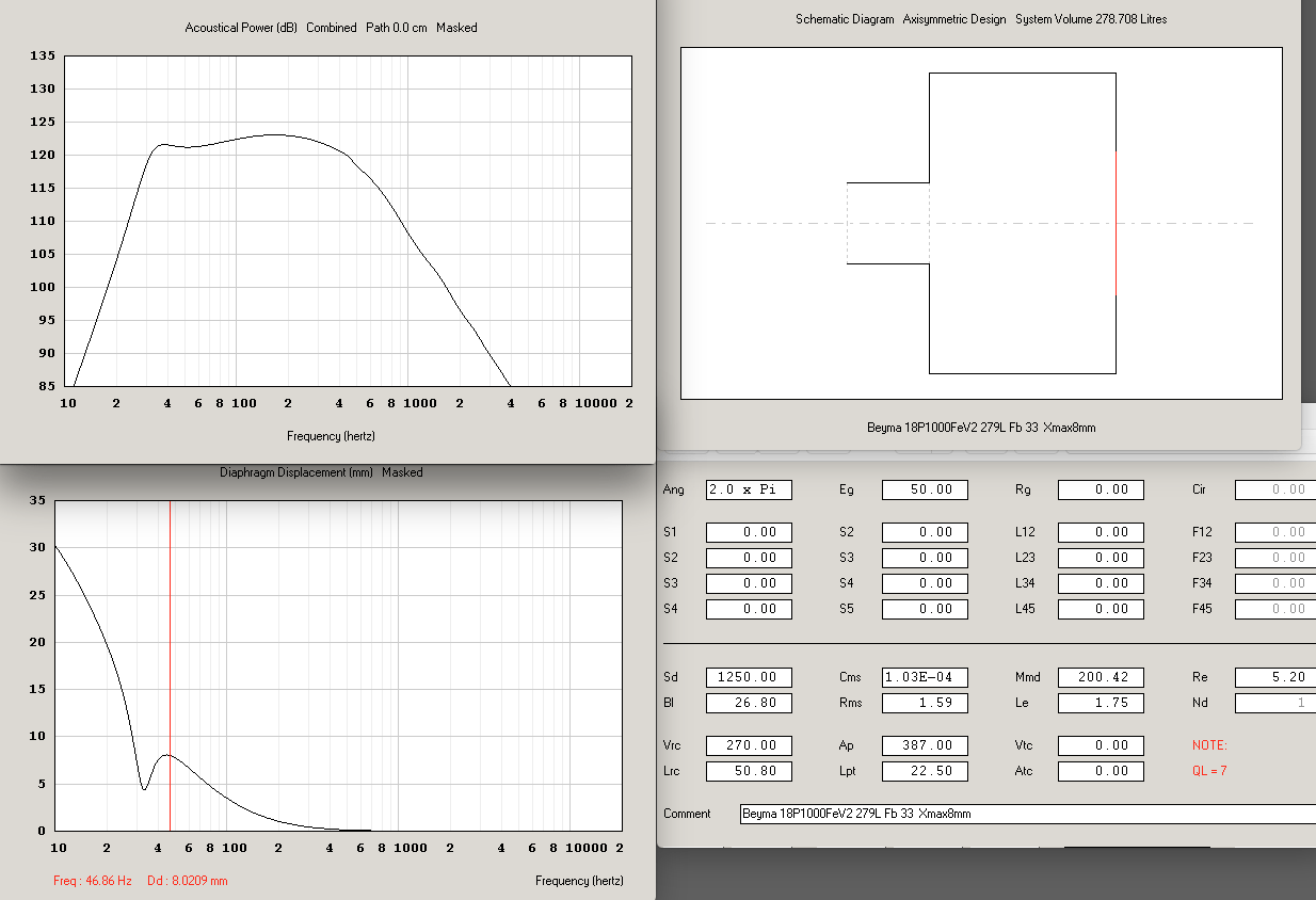

The 18p1000fev2 has plenty of power handling, but little Xmax, it runs out of excursion well below it's power handling.I am seeking your help on using Beyma 18p1000fev2 subwoofer for home theater. Is it good idea to tune the box lower, say closer to 22hz?
When box tuning (Fb) is dropped below it's Fs of 33Hz in the same net volume enclosure with an Fb of 22Hz, the (clean) low end potential drops considerably, in the examples below from around 118dB@30Hs to 112dB@20Hz.

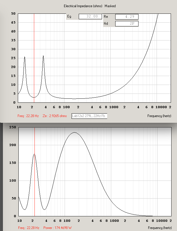

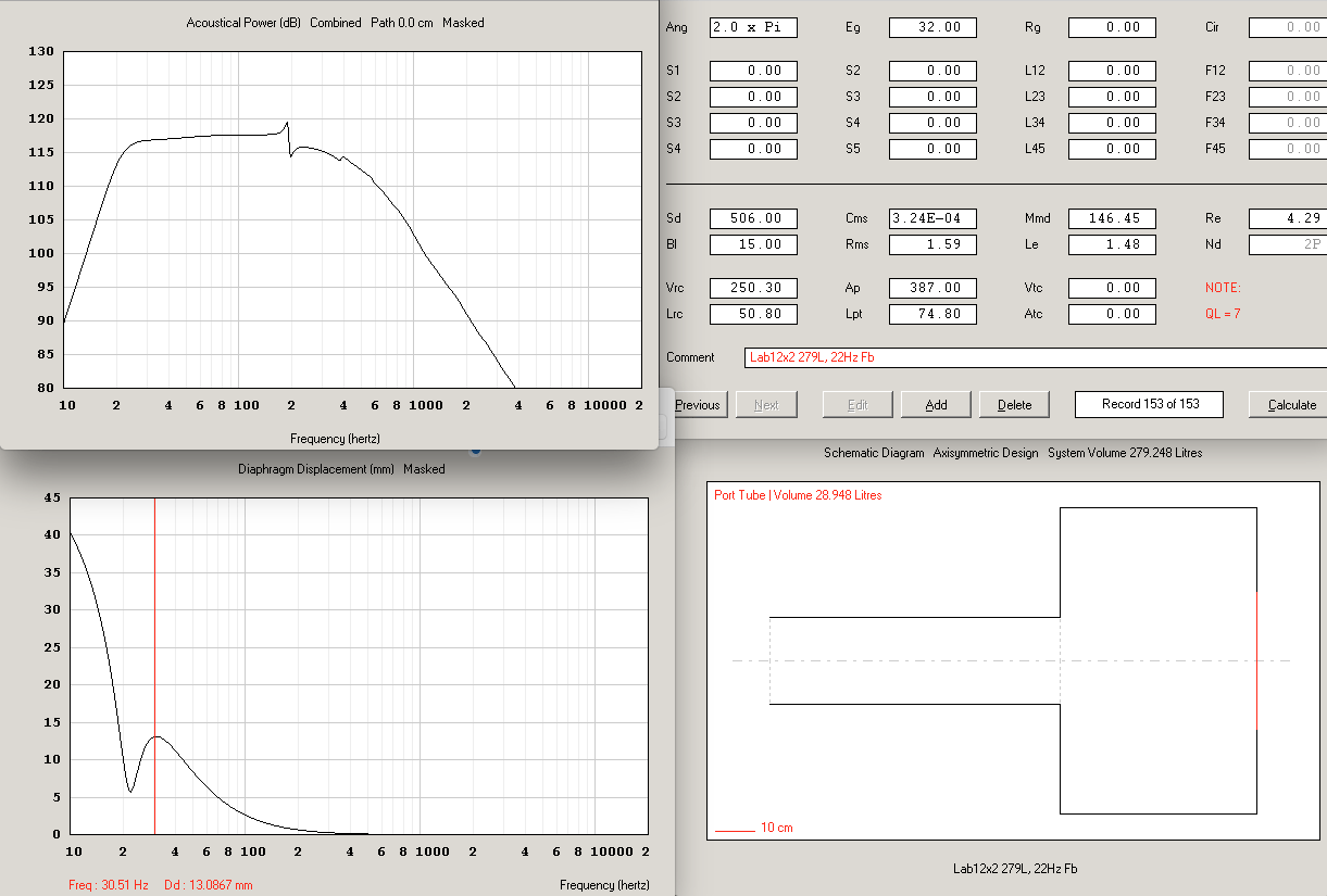

And for comparison, a pair of Eminence LAB12 drivers in the same box and Fb:
Note the voltage ("Eg" in the Hornresp simulations) to reach Xmax is far less on the lower impedance LAB12s.
A HP (low-cut) filter below Fb should be used to avoid excessive excursion which potentially could tear up suspension parts.
Art
Might be because your sim has the LABs wired in parallel, which is going to present a low impedance to the amp. What if they're wired in series?Note the voltage ("Eg" in the Hornresp simulations) to reach Xmax is far less on the lower impedance LAB12s.
Thank you for your response.The 18p1000fev2 has plenty of power handling, but little Xmax, it runs out of excursion well below it's power handling.
View attachment 1057161 View attachment 1057162
Art

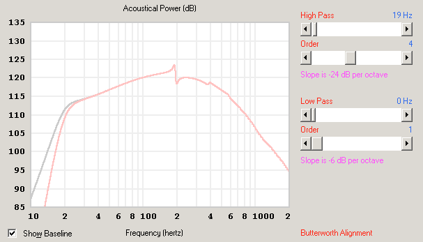

May i know the power signal at which this simulation was done? Also, is the 112db @20hz is without any HPF's. Could we expect a 5 db loss after applying HF filters? Since I do not expect it to output at reference levels at 20hz, will it serve the purpose to the least? I am looking to avoid a disappointment after I realise that this driver may not capable enough for HT use.

The "power signal" is voltage ( voltage is "Eg" in the Hornresp simulations).May i know the power signal at which this simulation was done? Also, is the 112db @20hz is without any HPF's. Could we expect a 5 db loss after applying HF filters? Since I do not expect it to output at reference levels at 20hz, will it serve the purpose to the least? I am looking to avoid a disappointment after I realise that this driver may not capable enough for HT use.
Voltage squared divided by the impedance (resistance in Ohms) (divided by the number of drivers) equals power in watts.
The impedance curve of a ported cabinet will always be at minimum at Fb, with higher peaks on either side, so power drawn is maximum at Fb, dropping on either side.

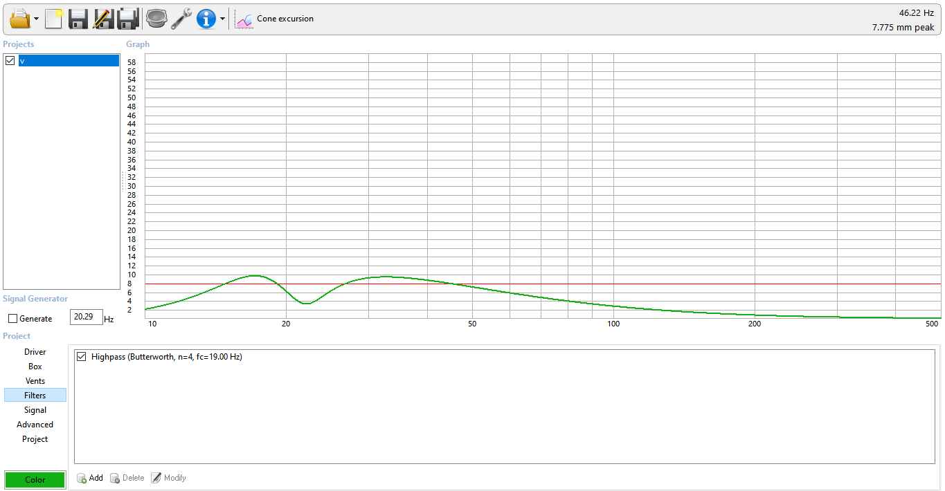

A BW24 HPF filter set around 10% below Fb will keep excursion under control with hardly any loss at Fb, under -3dB at 20Hz with a 19Hz HP and 22Hz Fb.

Thanks for your time and explanation.The "power signal" is voltage ( voltage is "Eg" in the Hornresp simulations).
View attachment 1057883 View attachment 1057884

I guess had never listened LFE that loud in close proximity (home environment) and probably unaware of what it would be like to experience 100+ db but going by your high confidence level response, it sounds promising to build an enclosure around 10 cu.ft to get a good decent bass.
Regarding cone excursion, I saw it exceeding at 2 places. 1 around 20hz and another between 27 and 46 hz. Now, applying just HP around Fb (22) only alleviates the exceeding excursion little bit but it does not bring under its limits (8mm). Similarly, b/w 27 and 46 hz, it exceeds above 9mm - could you explain how does it work in real time scenario where the driver exceeding 1 or 2 mm above its limits (xmax). Does it depends on which freq range whereit exceeds that decides whether its a risk for the driver, (i.e. able to sustain the excursion violation? like around 20hz high risk and and above 30hz low risk) or Is it fine if it exceeds beyond its limit for 1mm or 2mm and wont cause damage (at half power)? Below image will better explain my query

Xmax isn't typically the hard limit you seem to be implying. It's normally an indicator of the range for which the magnetic system is linear. Some drivers play cleanly beyond Xmax, while others don't. From footnote 4 of Beyma's spec sheet:
"The Xmax is calculated as (Lvc - Hag)/2 + (Hag/3,5), where Lvc is the voice coil length and Hag is the air gap height."
Some drivers have little extra room in the suspension beyond Xmax, but most have a decent amount. Some have a lot. Xmech is often the term used to indicate the mechanical limit of the driver. In this case, Beyma used the term Xdamage, and it is quite large compared to Xmax for this driver (though Xmax is normally a peak measurement, and Xdamage in this case is peak-to-peak).
As mattstat wrote, don't worry about a few mm beyond Xmax, but pay attention to Xmech.Is it fine if it exceeds beyond its limit for 1mm or 2mm and wont cause damage (at half power)?

Apologies everyone for not being active on this thread as I have been busy with office work. Thank you @GM, @MrKlinky for your valuable responses. So the latest development on this is I have not heard any news from the local dealer on the Beyma driver, therefore, I am now inclined to think other alternatives, which is to get 4 x 12 inch subwoofers which are made in India (link below) and build 2 ported enclosures (EBS - slightly bigger) inheriting 2 drivers each to be placed on either side of the room.
Although I would prefer 18 inch sub, availability and selection of right drivers are a major concern where I live.
Although it looks great on winisd, it would be good to have it reviewed by experts here so that I am aware of any limitations that I need to be aware about before planning build. The TS parameters is attached here and can also be found in the link.

Well, frame size wise looks like you got a 12" * (4)^0.5 = 24" dia.. and the various specs line up close enough, so any sim will be as good as the specs actually are, i.e. seen some really far off India made drivers over the decades here, so 'caveat emptor' applies.
Anyway, another one that ideally needs to be tuned > Fs to get much power handling and a single driver T/S max flat alignment is ~142.24 L tuned to ~22.48 Hz, but can only handle ~108 dB/m/100 W to get down to ~20 Hz/2pi plus with the relatively tiny cab it takes a 175 cm^2 x 60.1 cm long vent to do it at an acceptable vent mach.
Of course if up against a wall or better still, in a corner, it will be more and just build two speakers in one box to double again (+6 dB).
In short, no need for a shelved EBS, you're good to go as is as long as the specs are ~accurate.
