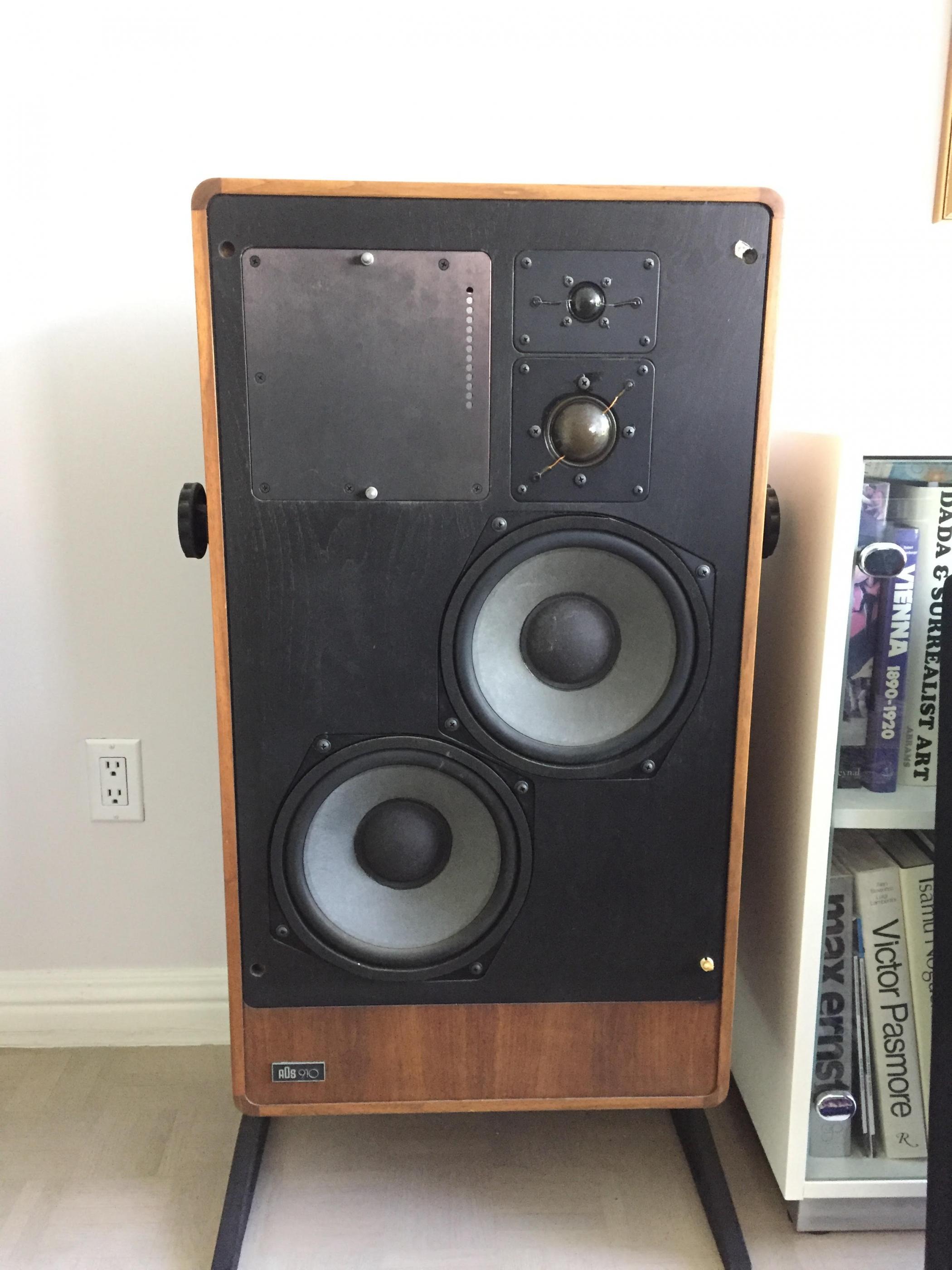

After you work out the problems with the electronics I would strongly suggest you turn your attention to the loudspeakers.
The speakers are using what look to be fine Braun/ADS drivers. These are very good quality (assuming the rubber surrounds are okay). I am sure that the crossovers are full of polycarbonate or mylar capacitors. If you want a big bang for the buck,replace these with polypropylene caps of the same value. No need for exotics here. You will be happily surprised at the improvement.

Not sure about Braun/ADR, 'cause Grundig successfully did their own R&D in those years.
I'd change capacitors in the xovers only if they were electrolytics and if their actual values were off, due to degeneration, and leave film or foil types alone.

As I said before, Grundig developed and made their own drivers those days. And yes, you're right, the Compact Box 650 sounds amazingly fine, especially WRT it's size. I own a pair, too, but don't run them at the moment.
Check the 'lytics in the xover networks for capacitance deviation. If they have grown out of tolerance, replace them by film types if they're in the signal path or by new 'lytics if they're in parallel with the driver and there's a resistor in series with it.
