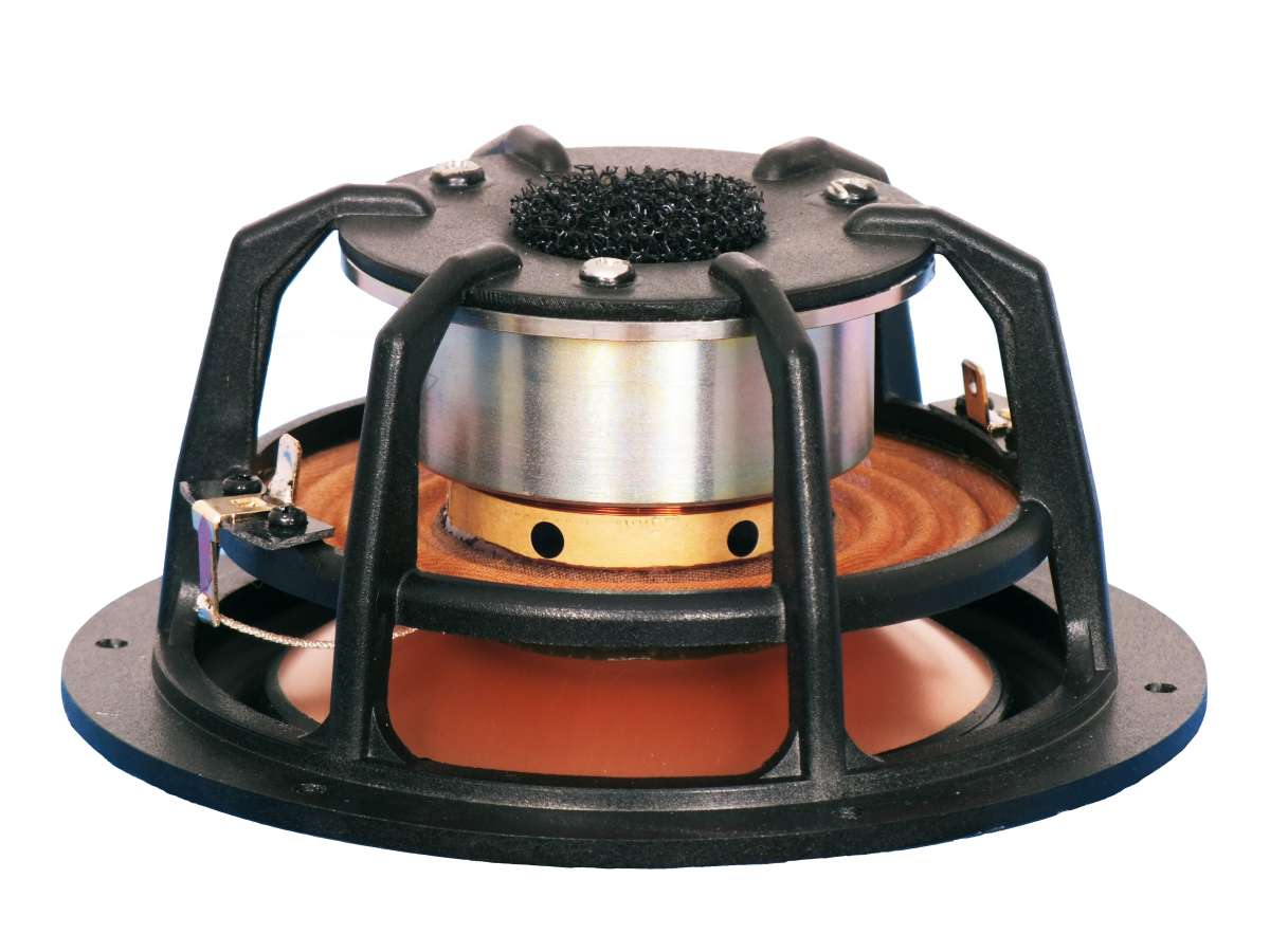

Suppose for a moment that much of the R&D is done; thanks to the hard working folks at SB Acoustics, @USXX and @5th element
What custom midrange would you buy from SB Acoustics?
The basics-
This will be a 4 ohms, high sensitivity pure midrange.
The sensitivity will be ~93dB/2.83V.
It will capable of ~200Hz to over 8KHz.
Here’s how you can play a part in making this a reality.
First, put ONE vote to nominate the size of your midrange, or coaxial, custom made for you.
(Options 1-4)
For your second vote- please choose an alternate cone eg. NBAC (black aluminium cone), or if you prefer, one of the other cones eg. paper, Norex, polypropylene, carbon.
And finally- add any comments and queries after you vote. All are welcome!

Geometry is of vital importance.
Suppose the smoothness matches the catalogue standard SB15… or SB17…
This is where you vote your favourite model.
And assume for a moment; that without the dustcap, the response is NOT negatively. affected.
And the tweeter that takes over the spot of the dust-cap doesn’t affect the midrange response.
And we want a nice and smooth treble response- we don’t want the midrange to negatively affect the treble’s response.
Furthermore, we want the treble’s directivity to match the midrange, because controlled directivity is what we want- a smooth on-axis response AND smooth off-axis responses.
A midrange-treble unit whose polar response is controlled, and is matched in both vertical AND horizontal directions.

The SB17CAC is already a really great driver above 200Hz (see testing by Erin Hardison at link below). I own a pair. Changes in the motor to reduce the gap and increase sensitivity would probably make it a top performance, high sensitivity midrange.

SBA - the 5 inch driver should be equipped with the 35mm coil of the bigger brother for even better cone control!
