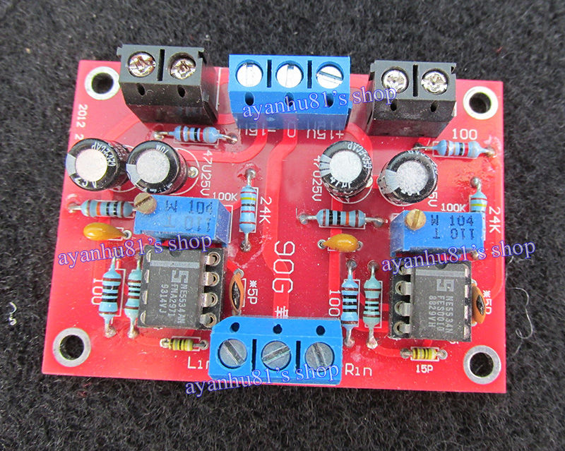

Now I'm trying o find a tranformer that fits in my chassis to power the simple NE5534 pre, pic atached using the tps7a4700 dual pcb board
The size being dependant on current draw, could someone hazard a guess and what sort of power draw is expected of the pre in the pic,
Stu
Darn, thanks for all your help... BUT... just realised I am not center tapping after all!
Will supply each PCB with one of the secondaries, I presume this means that they do not need grounding and that the signal arriving through the preamp board will be the only ground,
sorry for clogging up the forum!
