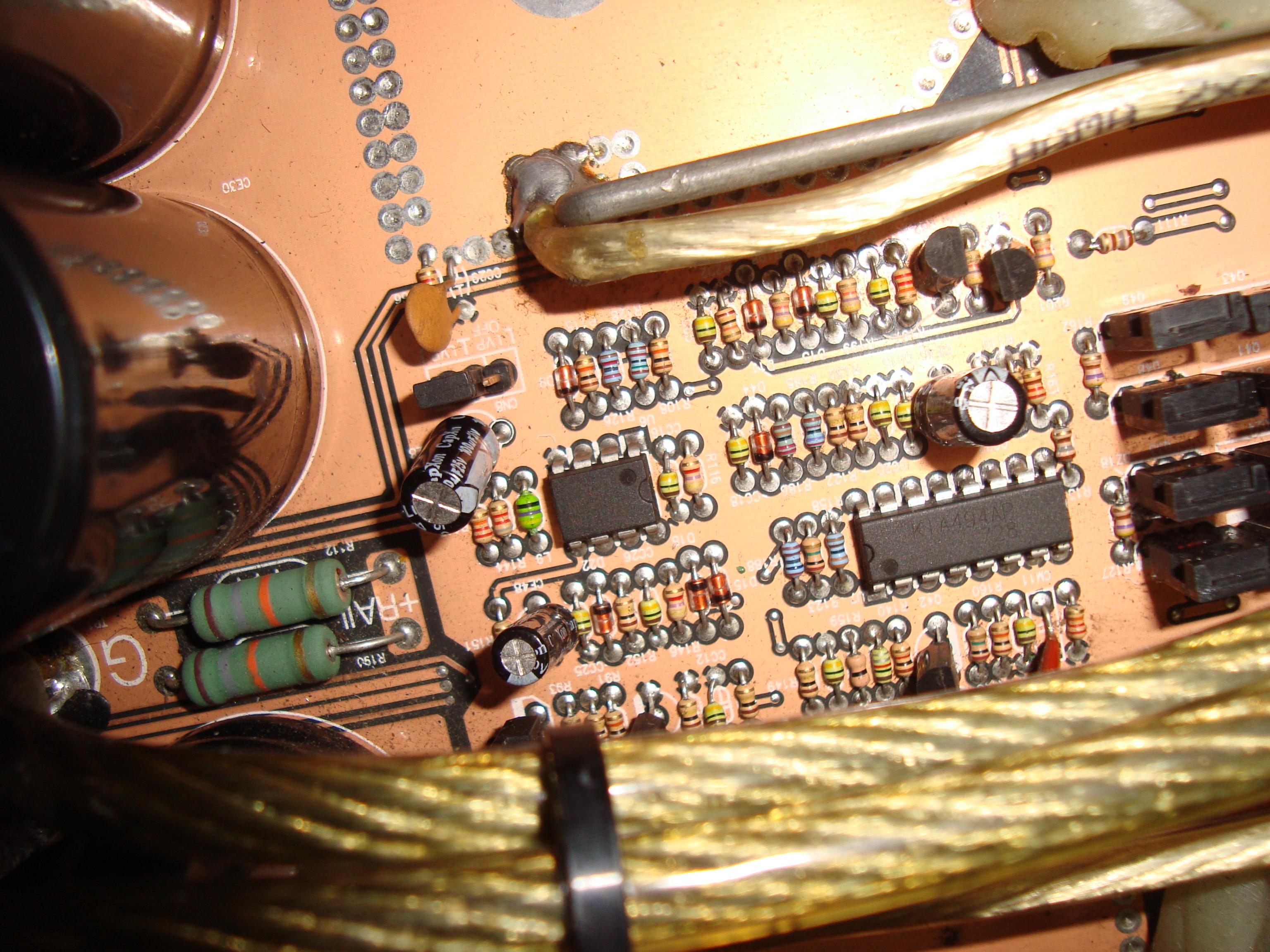

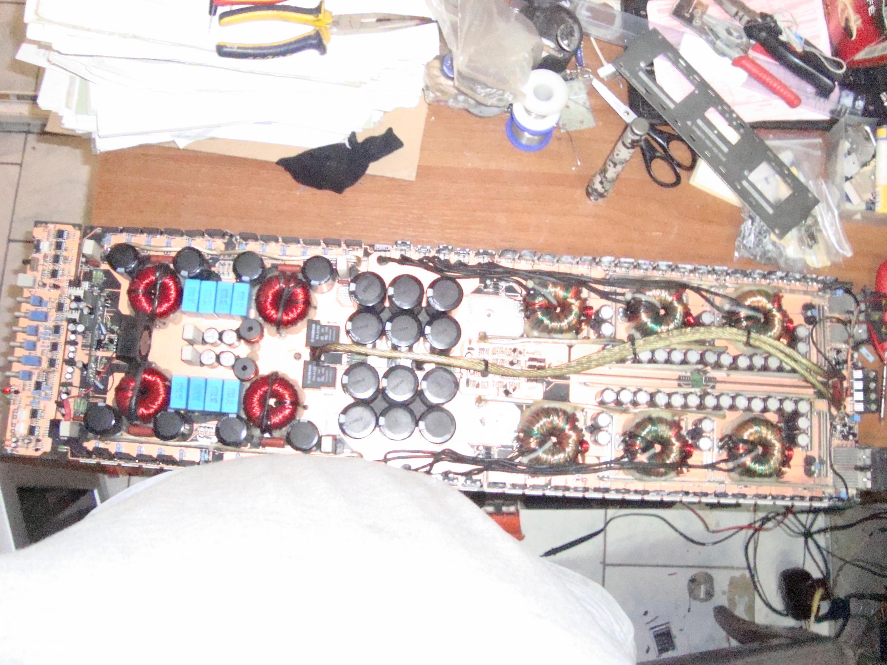

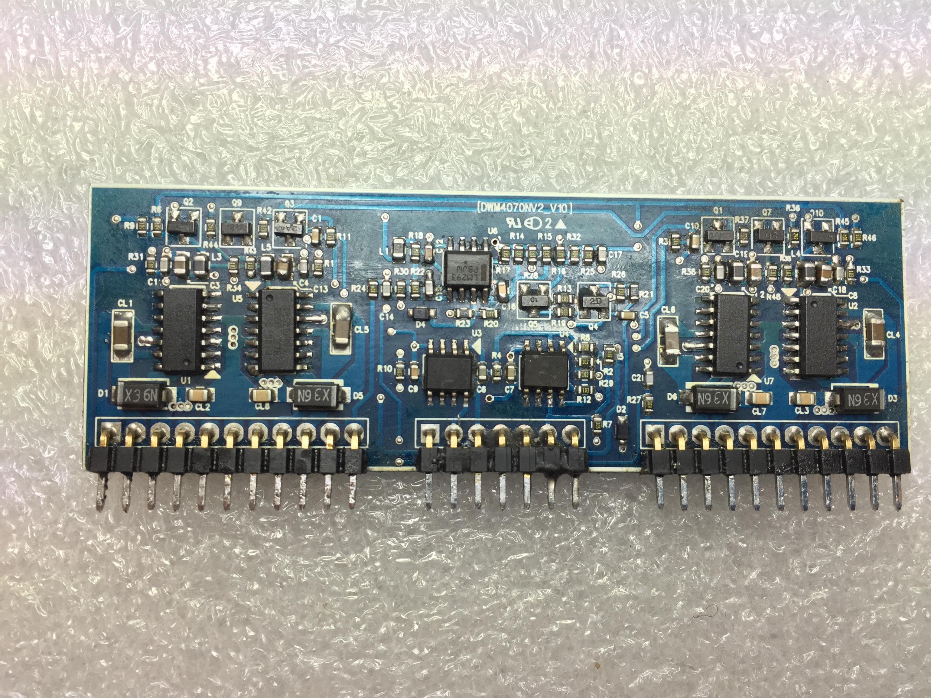

Hello for all members..I have a ground zero 1.10k and i have power suply broke.Amplifer had a output transistor broken and driver board broken.i change all output transistor/gate resistance/ audio driver/tl494 and driver transistor for suply.The transistor drivers from supply i changed with bd140/bd 139.When loading the power suply(12v) the output raley coupling and the red led light stay ON but very dime.

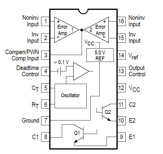

Imeasured voltage on ic tl494.
1-0
2-4,9
3-0
4-4,31
5-1.58
6-3,59
7-0
8-12
9-0
10-0
11-12
12-12
13-5
14-5
15-5
16-0.65
I don t understand why no have output signal from tl494..

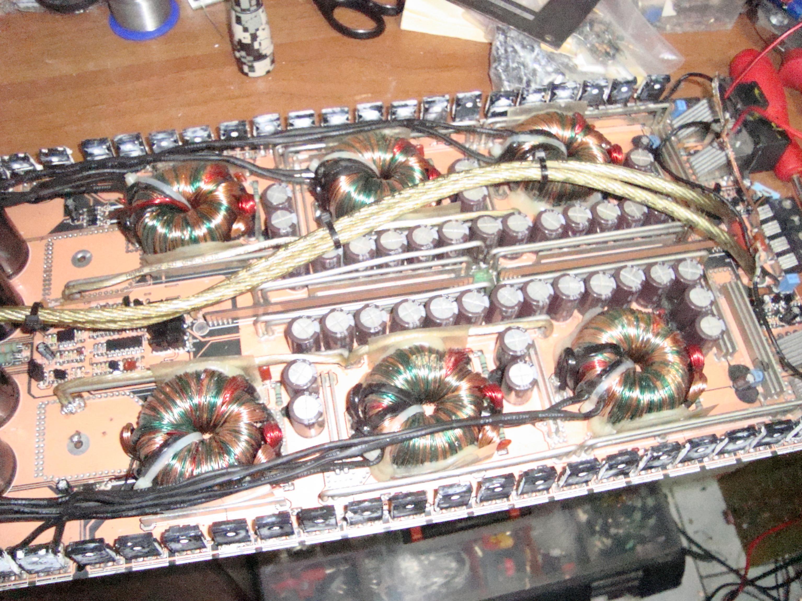

i remove the transistor...whe connect power suply :
-The led is green
-I have around +0-50v(power suply is from transformer 12 v ~5A)
-3 pcs output transistor heat up.

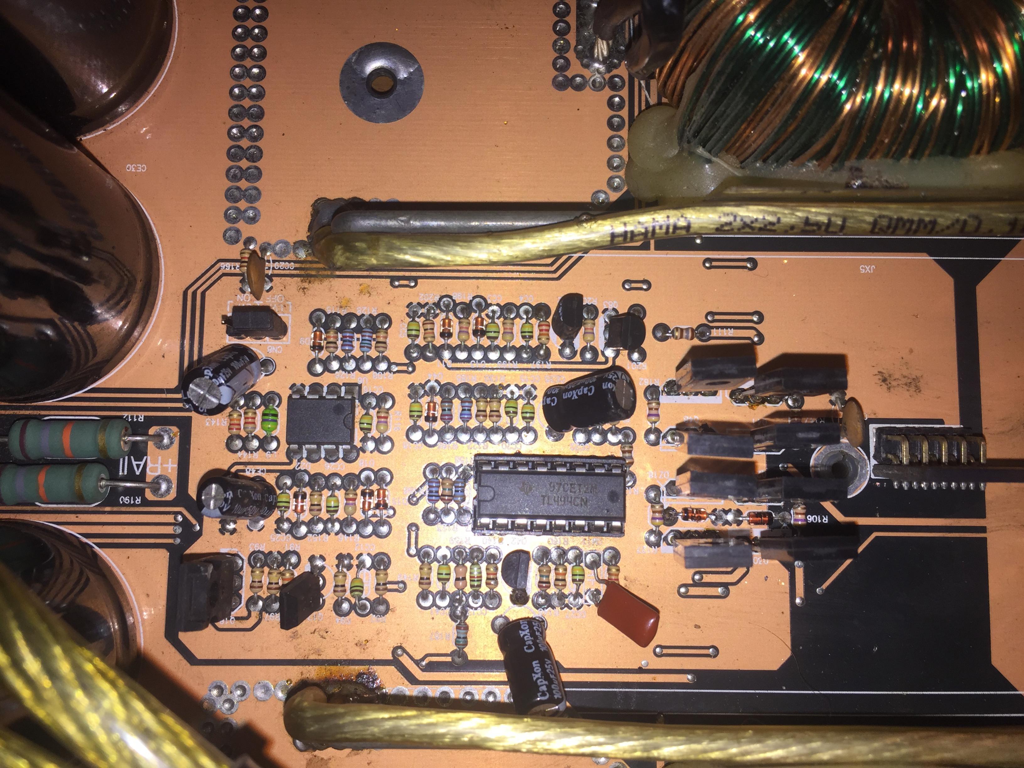

I think the problem is from driver board because before i changed audio driver(4pcs)irf(smd)..because before was burned all audio driver and all output transistor, and me i changed only the audio driver and output transistor
i remove the audio driver board for make a photo?
i m sorry for my bad english.if you don t understand something ,ask me.thank you for all

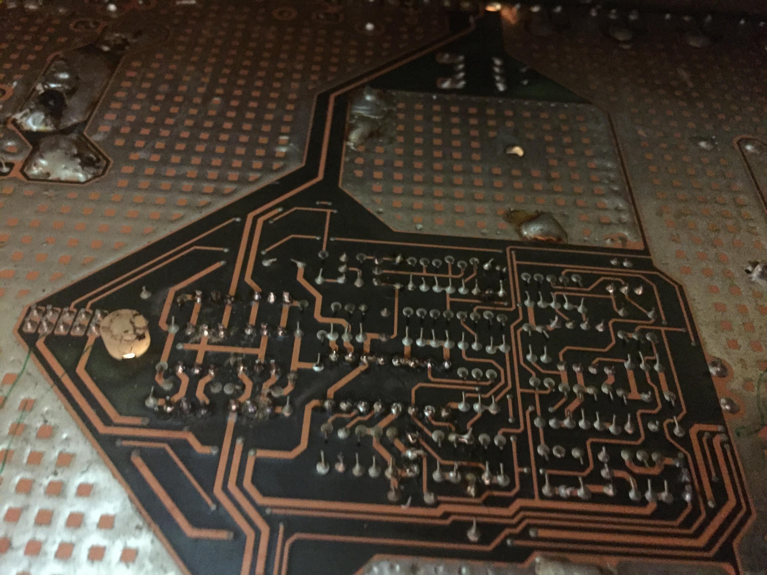

I would recommend when troubleshooting output driver card, install "socket" on the main board, so you can pull it off many times as you want, so you don't need to desolder it from the board.
Which transistor you removed? Amp doesn't go in protection with DC on the outputs?
You mentioned, that you have failed output transistors, you rebuilded output driver card? If so, what did you replace?
When outputs fets fail, you MUST have to replace their drivers IRS21844 and check carefully all driver card.

i removed the driver card and is big problem..all driver irs21844s is broken,all rectifiers smd is broken and 2 transistor ....but i don t know the name of transistor q2 and q10....i will buy all components ,tl072.4xirs21844s,lm293.x6n(rectifier) andQ2,Q10...Somebody know q2 and q10..thaks!!!!
