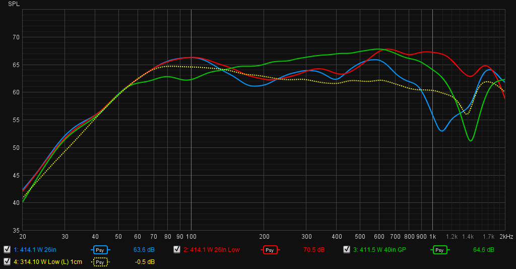

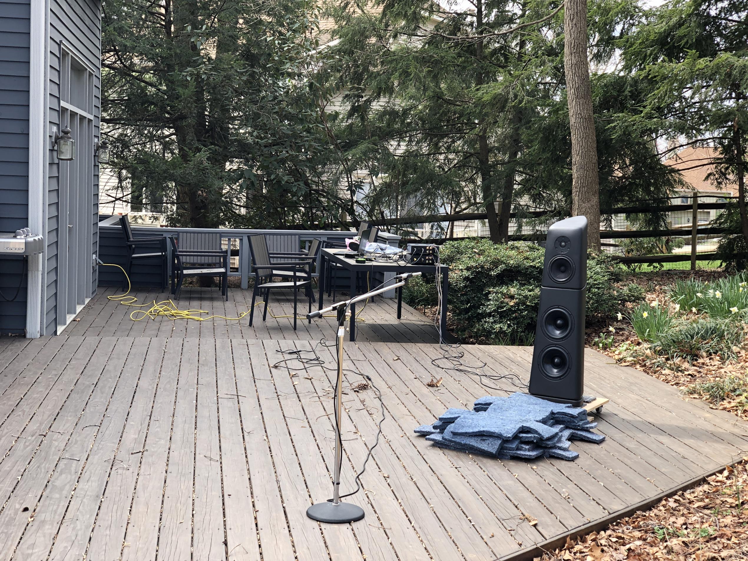

I have managed to spend some time outside measuring speakers lately, have gotten fantastic results measuring midranges, and would like to share my process (active system using MiniDSP).
In the first attachment, you can see the blue midrange GP + farfield merged measurement I used to create the EQ. In green is a GP measurement I did with EQ, and in red is a 30" farfield measurement to confirm that both the merge operation and EQ are correct.
I can run through this procedure in 10 minutes if I’m lucky, or an hour plus if I interpreted the merge wrong and have to rethink it or measure again. I consider this result just about perfect, and didn’t have to model or account for the baffle step at all.

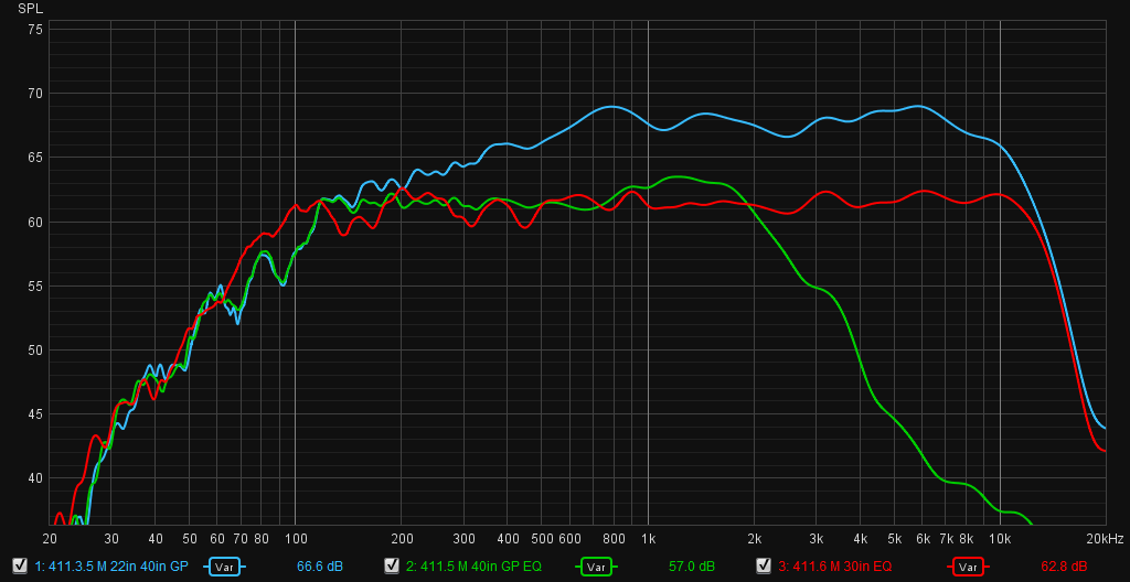

Here's my problem: this process does not work for my stacked woofers near the floor. Ground plane measurements suggest a baffle step, but using my process results in far field verification measurements with a downward sloping response, with the mic at any height or any distance. In fact, the only way to get a good final response is to assume there is no baffle step at all.
In the second attachment, you can see woofers on the design axis in blue, the mic at the same distance but woofer level in red, and GP in green. Notice the dashed yellow nearfield measurement seems to be a mirror image of the groundplane for most of the passband. I know the (too small) box alignment is not canceling out the baffle step, but leveling the GP measurement is going to do bad things to the other traces.
I don't know what I should try next.
I am still trying to make sense of measuring woofers, and here is an idea; please post your thoughts:
- At high frequencies, a woofer has 2pi radiation just like a mid.
- Below the baffle step, it transitions into 4pi, also like a mid.
- However, the woofer will also transition back into 2pi at a point defined by its proximity to the floor.
- If the distance between the woofer and the floor is greater than the width of the baffle, then you will end up with a U-shaped response. This could explain my far field measurements.
- If the distance between the woofer and the floor is the same as the width of the baffle, then the two will cancel each other out and the measured response will remain level.

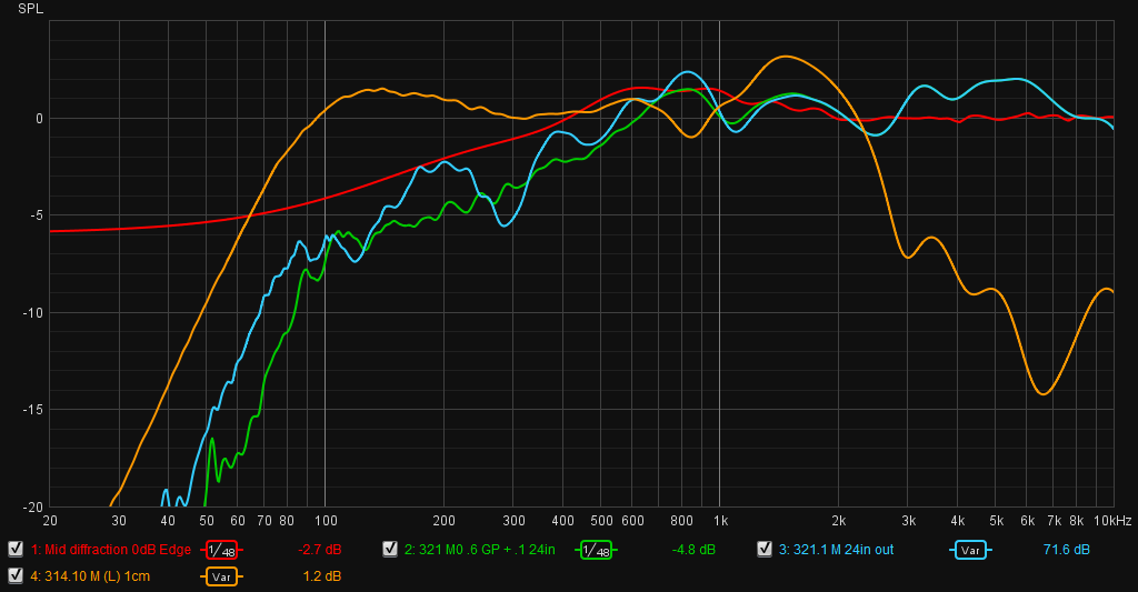

At least as for my midrange measurements:
The design is a TMWW with FIR LR2 crossovers at 2.5kHz and 300Hz, augmented with a sub via IIR LR4 at 80Hz. I keep meaning to post a complete design thread, except I spend all my time tweaking or enjoying them.
- Edge predicts a diffraction peak just above BSD, and my own measurements show something similar, although the measured transition point is at least 100Hz higher than predicted.
- My ground plane measurements remove all the ripples through the entire baffle step. I assume this is because floor bounce is eliminated.
Did you model the enclosure tapering shape and edge round overs using edge software?
If you apply a baffle step shelving filter 4-6dBs between 300 - 800 to the midrange so the midrange hopefully measures flat and then re measure what do the new results look like and do they provide a better understanding of what is occurring with the ground plane measurements?
Do some people carry out ground plane measurements with the speaker laying on its side, then all drivers are as near as possible to the plane.
The image shows a conventional setup what does the response look like with corrections applied once windowed to show a 300 - 20Khz response

I do not see the problem. Ground plane measurement method is 2π (given no absorption) and has a bonus: it is 2π (almost) full bandwidth, just like a real free field measurement (no boundaries) is 4π full bandwidth. There is no 'baffle step effect' on behalf of the ground plane, because the microphone is ín that plane. Given the ground plane is sufficiently large of course, a few square feet and some won't do. But with appropriate gating even that aspect is manageable, with LF resolution as a sacrifice.
Laying the speaker on it's side eases off-axis measurements in the vertical plane, but you'll also need to appraise the horizontal plane. A turntable with a tilting option helps speeding up measurements.
No news this all though. I even have seen people suspend their DUT some six feet above the ground plane mike. Given a high ceiling and ditto lifting construction that can work out just perfect too.

What I meant was that I did not want to loft my speakers way into the air in order to move the floor bounce out of the woofer's pass-band. If I did that, then I would also remove the floor boundary reinforcement that is part of the woofers' intrinsic response.
Edge let me do a taper, but not account for the roundovers or sculpting of the baffle. I have tried a few other applications and they produced similar responses, so I did not save them. I just wanted to have a guide for interpreting measurements in REW. If I narrow the simulated baffle quite a bit, then produces a response that starts to look like my GP measurements.
Look at the first attachment in my first post. The red trace is after applying EQ to the midrange baffle step and then measuring in the farfield to confirm.
