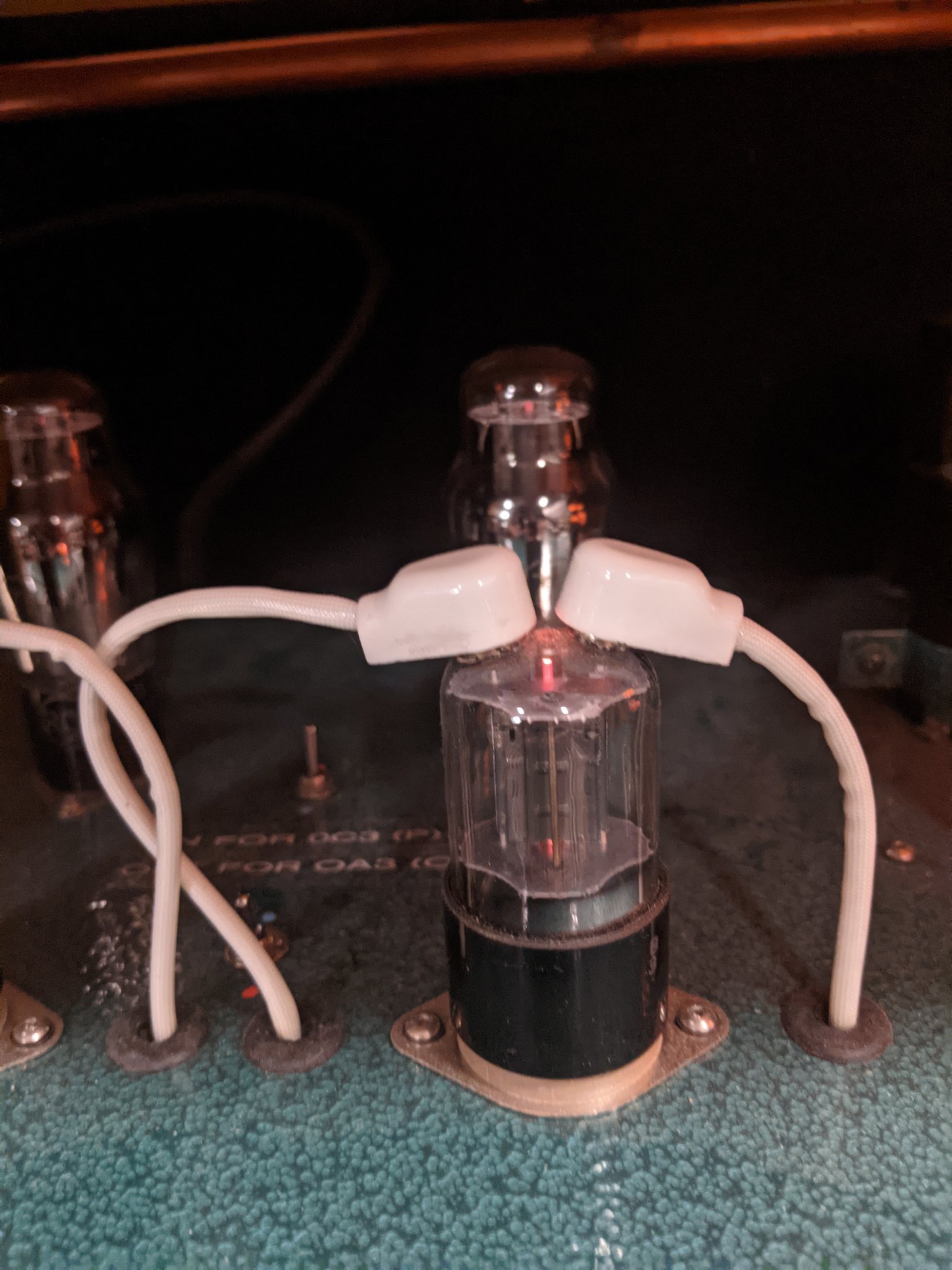

I did this on my 2C22s. Slid a covering of white fiberglass insulation and a bit of heat shrink to hold it in place. The whole resistor and connections are fully inside the ceramic cap. Seems fine.I'm very fond of the CV1135 - I thought it the best of the 6J5/6SN7 types.

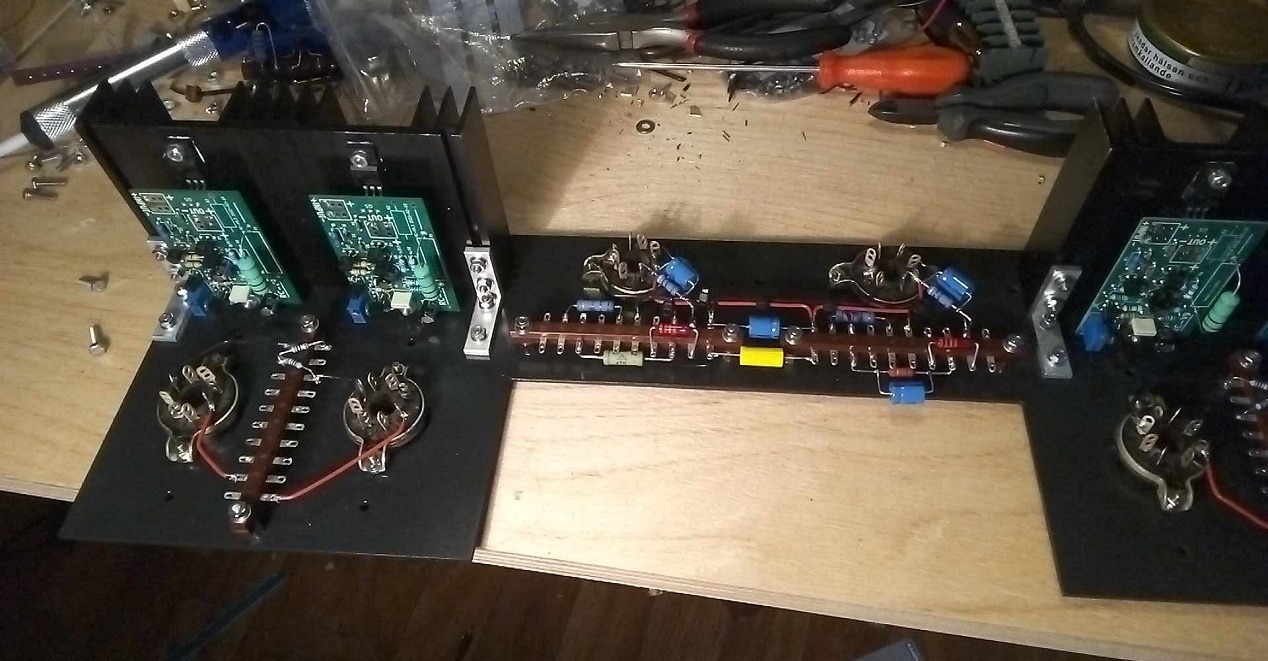

I soldered the input stages last night (will post pics soon) but didn't put any stoppers inside the chassis. It won't be any problem to add stoppers close to the grid connectors, I just thought it would look better with a plain wire.
