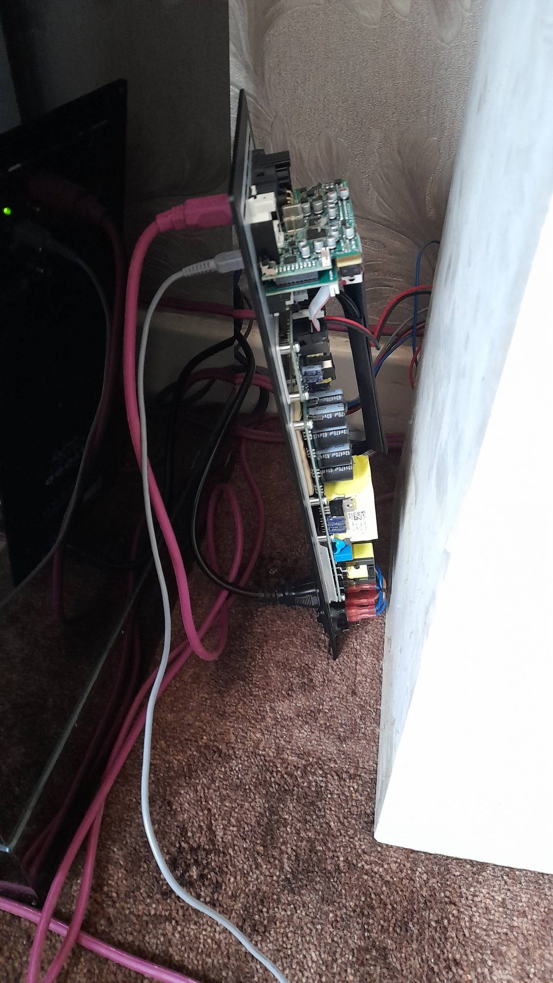

FA253 being tested which will be fixed to back of cabinet in next few days

Volume is 74.8ltrs so allowing for drivers and other bits in there should be close to Volts specs for ported design. Info downloaded from their site a few years ago gave Volume 70ltrs, Vent dia 7.5cm, Vent length 11cm, should give -3db 35hz .
