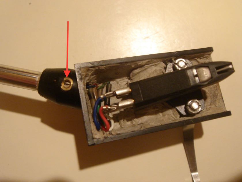

Hello All
I too am messing around with a 707.
Interested about the comment above regarding rigid headshell.
Since the headshell of the 707 is integrated and non removable,
Im curious, do you perform surgery on the 707 (Im good with that) and
somehow put another headshell on there or is it a matter of modifying the
existing headshell?
Curt
Take out the azimuth adjustment screw and it may just twist off. Obviously protect the arm tube and bearings from any torque. A sensible use of a hot-air gun may help. [I am trying to remember back over 40 years!]
A solid sheet alloy shell insert - filling the shell as tightly as possible - will help, but a solid metal rigid shell will be much better.
The pic is taken from a google search....thanks.
