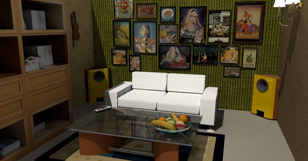

Just look how cool these ol things can still look today... I mad a picture in sketchup for inspiration...Oh and also to compare to the rectangular box, which looks horrible.
