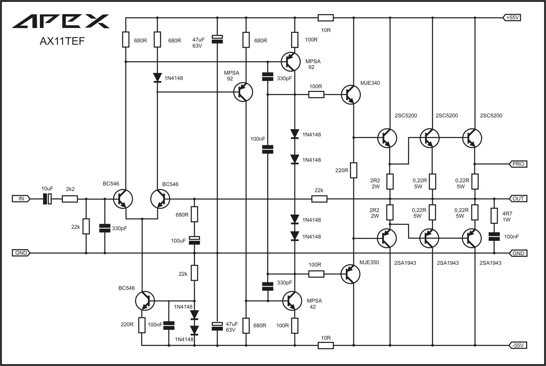

AX11 and FX8 are probably simplest.
Want something more sporty? AX11TEF
The Apex FX8 is very simple and easy to build lateral MOSFET. This thread has dozens of amp designs, almost all easy to build and sound great.
http://www.diyaudio.com/forums/solid-state/164093-100w-ultimate-fidelity-amplifier.html

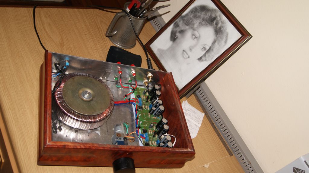

I threw this amp together for a few local fans in 2009, It may be of interest to you. It is the kind of amp you build and it works first time. It is a simple single board design that contains the power supply as well. Power transformer can be around 35-0-35 VAC. The attached graphs are really short term power predictions, and useful to someone who listens to music and not pump sine waves at full power for hours on end.
You are welcome to ask as many questions you like, I will try to answer them as accurately as possible.
Everything you need to do the PCBs are contained in the files, even Gerber plots. This amp is a lot of fun and sounds pretty nice.
The amp shown in the picture is one my brother built (he is not an electronic guy at all) using the base plate (2mm thick) as heat sink - it is super simple amp.
EDIT: There is a wire link under the board connecting the ground at the terminal the the start ground at the other end of the board, just to keep things tidy.
EDIT2: Just in case someone asks the question. The picture is of my wife of 40 years and still going strong and hated my hobby since the day we met.

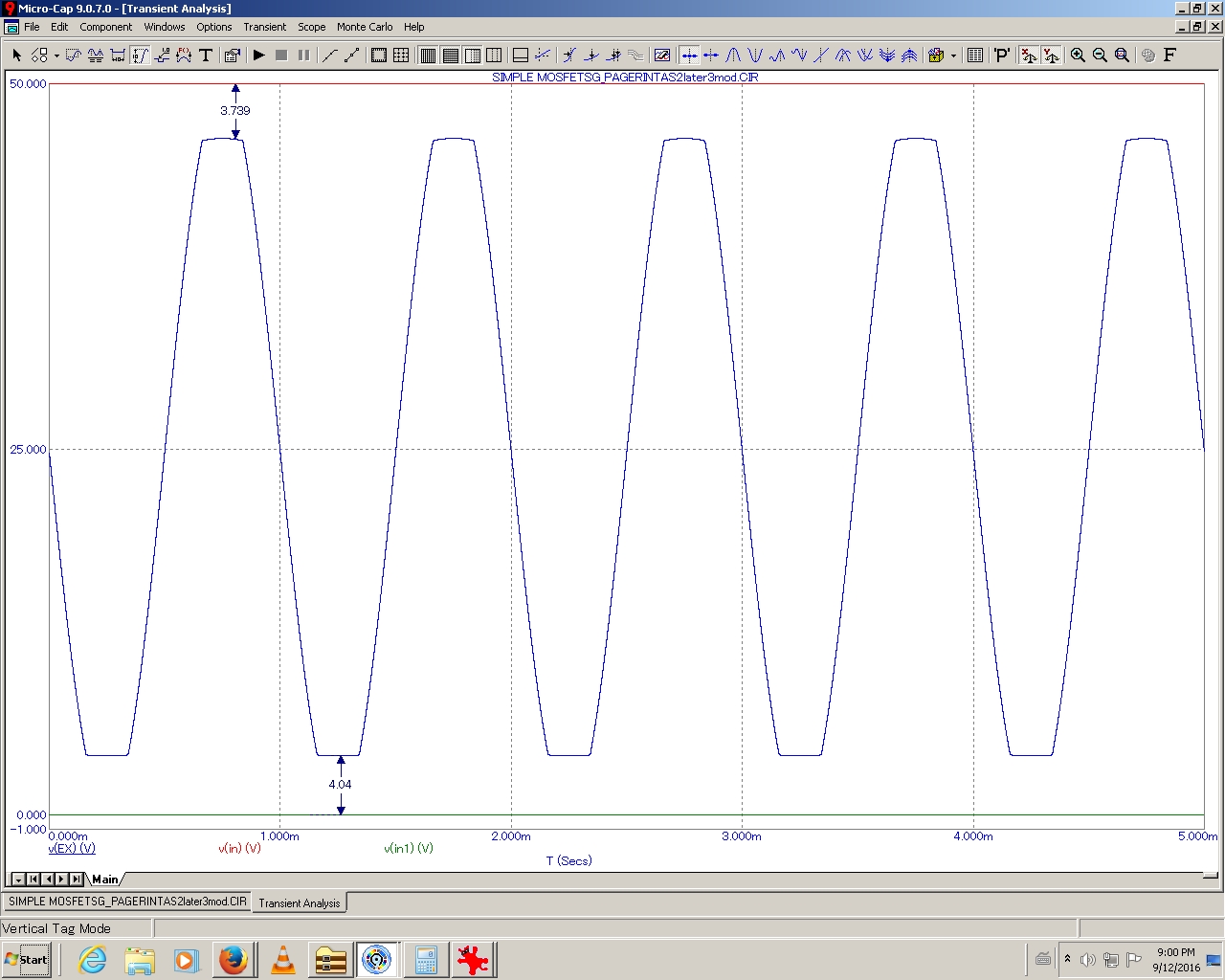

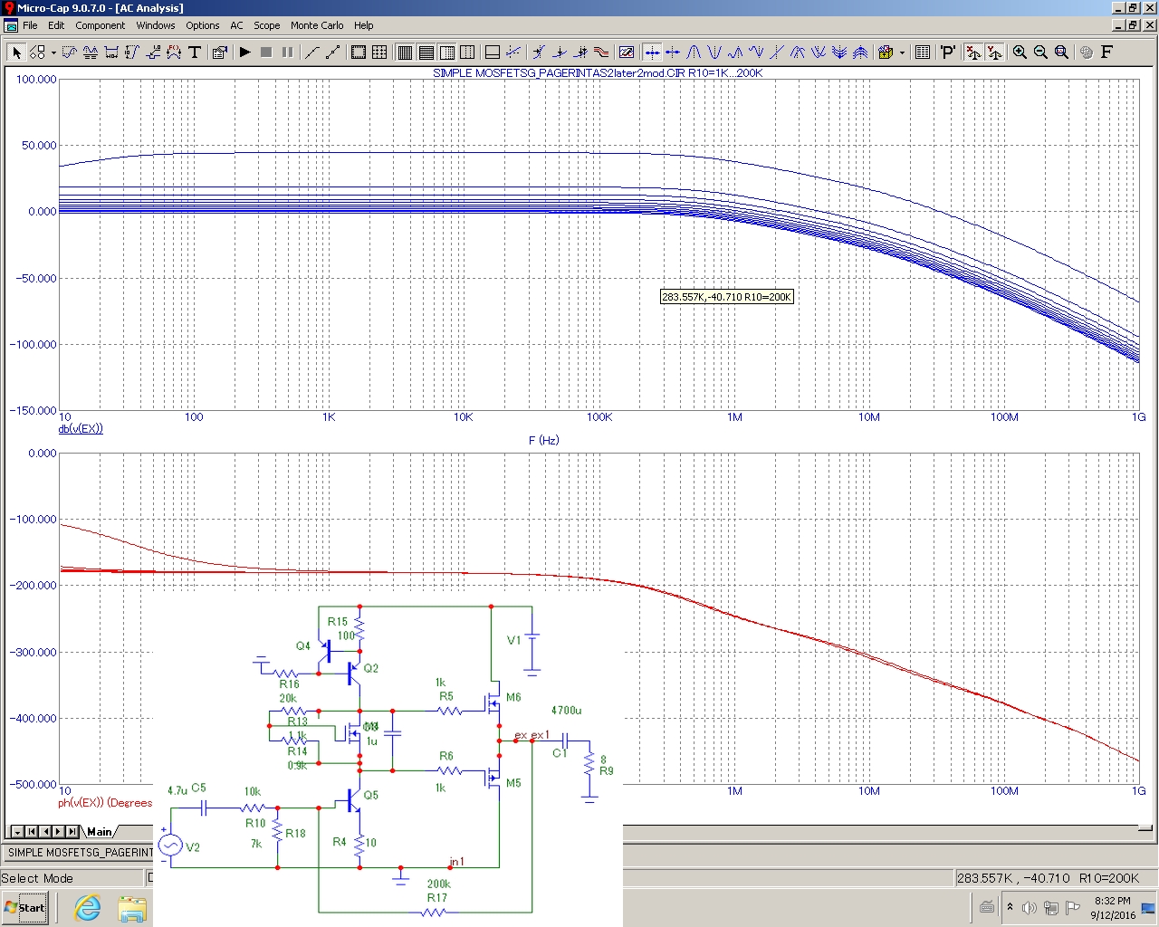

I recently made this amp. Super simple build and excellent sound and predicted performance in sims is quite amazing. Clean squarewave to 200kHz. Inexpensive IRFP MOSFETs.
http://www.diyaudio.com/forums/solid-state/294834-cfh7-amp.html
Schematic (note that a 2.2k needs to be added to input between 10uF and 22k):
As built:
As built:
