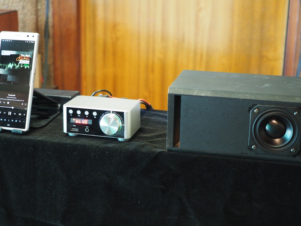

I'm using it with Xperia8, AIYIMA B2D1957 (Bluetooth amp) and PEERLESS PLS-830985 (2.5" fullrange).
It costs about 60€ for an amplifier and pair speakers.
It produces enough bass for my needs, but you can boost it with the graphic equalizer on your phone if you think it lacks bass.

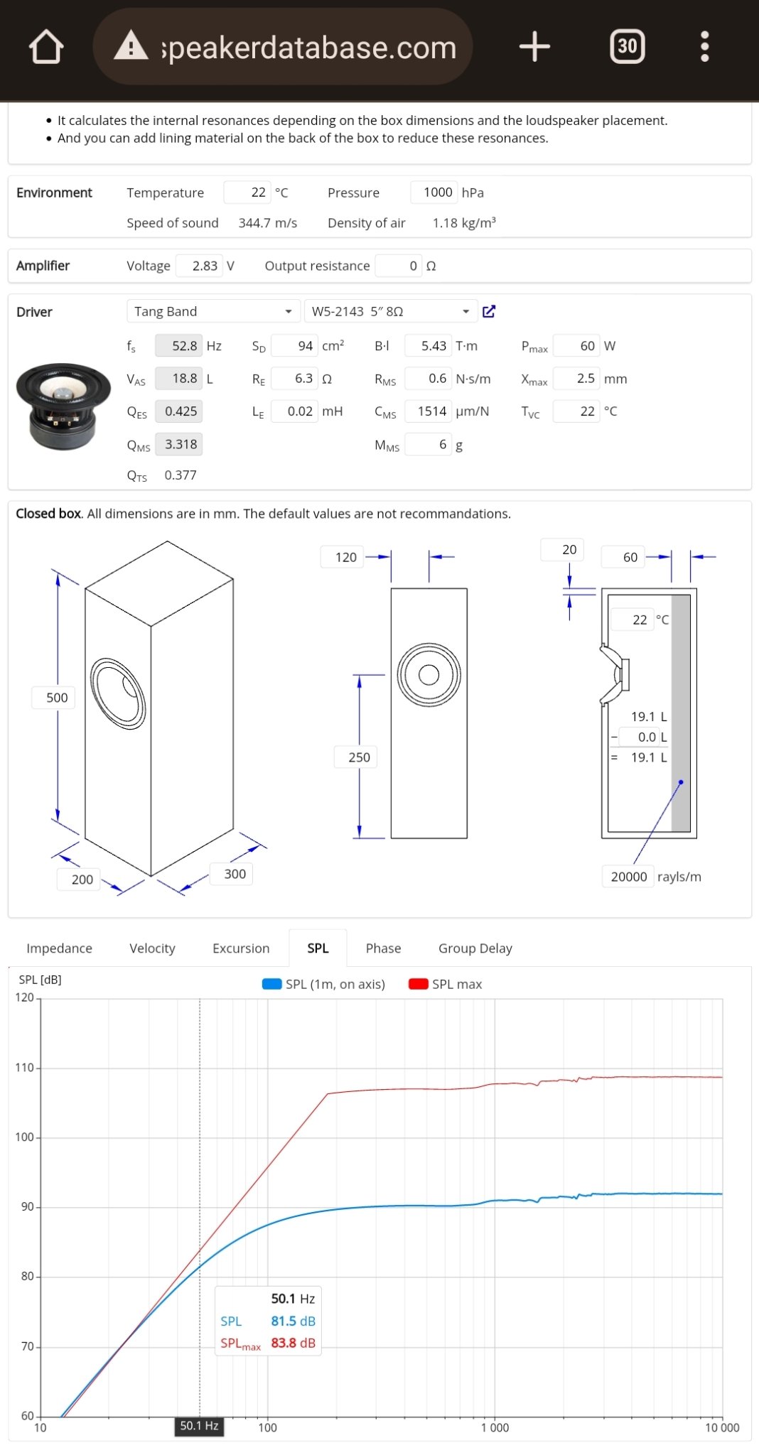

this driver can do around 50hz in a closed 19L enclosure https://doc.soundimports.nl/pdf/brands/Tang Band/W5-2143/pdf_Tang Band_W5-2143_1.pdf
this doesnt sound too bad with 2,5mm xmax and i guess i can make the enclosure a little smaller (maybe 10L ?) and use a little EQ to still hit 50hz

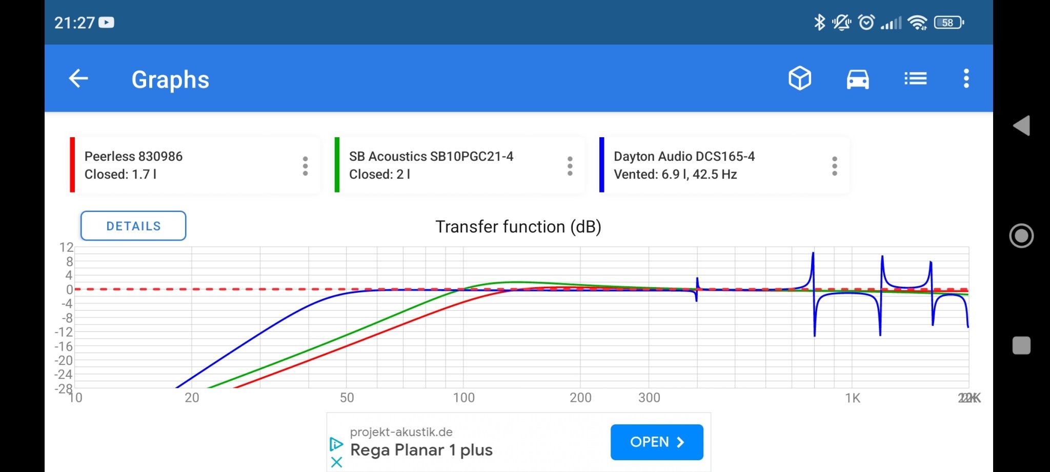

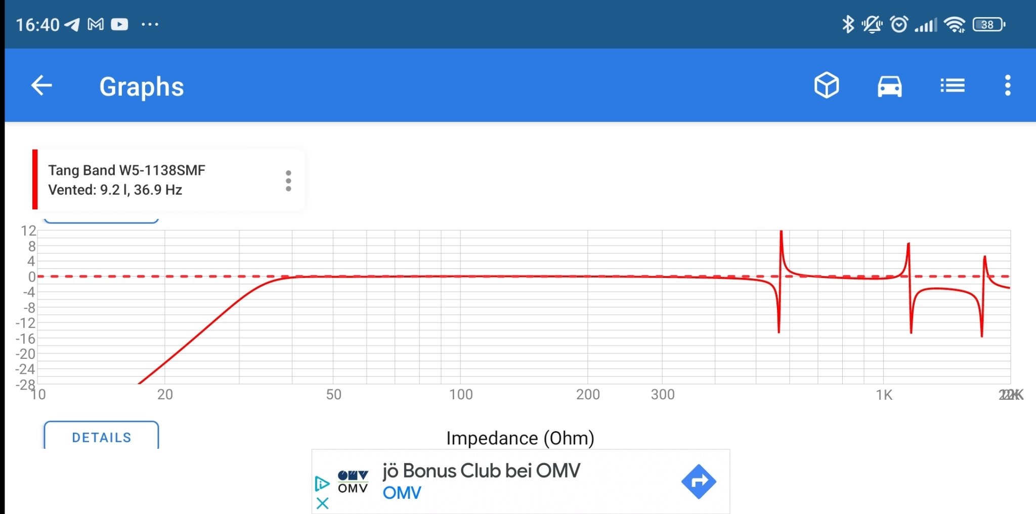

What's your SPL expectation? W5-2143 will hit xmax at just above 1W in a 19l closed cabinet at 50Hz. There's no headroom left for eq.

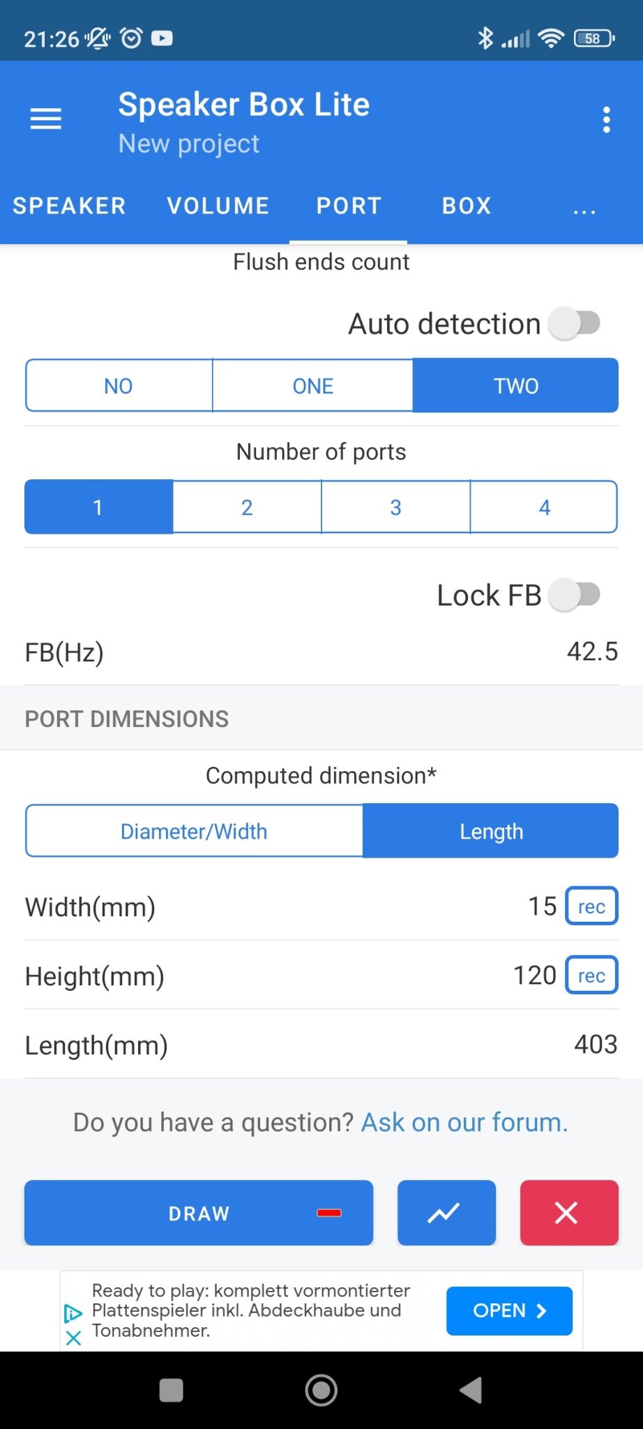

I'd suggest you simulate your prefered driver in WinISD, Vituixcad or Hornresp or similar free software to see what you get.
If you want low end extension you're gonna have to use a bigger driver, bass reflex or passive radiator.

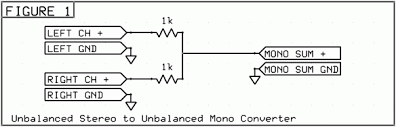

You need do to it right, with a schematic like here:yes i have the same thinking, but im a bit worried about phase stuff messing things up if i route left and right channel into one mono channel

Or even better, use the dsp to go to mono. Most can do that very easely and without phase issues.
