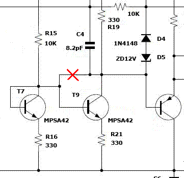

These diodes can be connected this way, but when conducting,
they will be in serial with R19 , thus being less effective to limit
the relevant voltages...
R5 should rather be 30K and not 3K as in the amps 100% accurate
schematic..
Other than that, this amp as the 9.2 , is quite fast at 60V/uS SR,

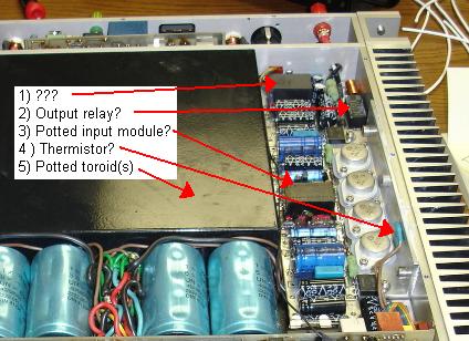

I have a few questions about the layout in the photo:
There appear to be three "little black boxes" per channel. I assume one is the input module and one is the relay, but what is the third?
The little blue thing on the heatsink looks like a thermistor, but I don't see any on the circuit diagram? Is it maybe something to do with biasing, or the protection circuit?
I'm also curious as to what part of the circuitry is in the separate compartment at the back of the amp. Is that just the protection circuitry?

dadod,
You are correct because if we follow the schematic T7 and T9 are no longer a current mirror.

It's OK, there's a compensation cap across T8. Nagys did mention that different models were slightly different. Then again, it might be smart to allow for a cap there on the PCB - just as an option for tweaking.Hi Nagys,
There is an error on mimesis3 schematic, base of the T9 should be connectet to collector via capacitor (probably 10pF) not directly.
Yes, the connection between the base and collector of T9 needs to be cut to fix that.... T7 and T9 are no longer a current mirror...
Another small detail: maybe C11, C14, C18 and C21 could be a higher voltage rating, just for reliability.
Otherwise, it's looking good.
Wahab and Dado - Thank you for catching the mistakes. I've been working late last night and can't always be 100% perfect. R5 should be 33K. The Base and Collector of T9 should not be connected. For the PCB, I will leave mounting holes in that area so that if for some reason the amp is not stable, a 10pF capacitor can be installed there. The Goldmund Mimesis 3 does not have a capacitor there, but the Goldmund Mimesis 9.2 does. It's probably all dependent on PCB layout. Please see the corrected Mimesis 3 schematic below:
Godfrey - The back circuit board has part of the protection and line filters. The front circuit board has the logic circuits, delayed turn on, thermal shutdown, etc. The first block is the A1 module. The second block is the S1 module. S1 houses part of the protection circuit. The third block is the relay. Yes, the blue thing is a thermistor.
