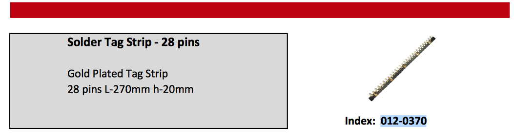

Jantzen Audio have them in their catalog. 28 pins, gold plated. Contact eg. Parts Express since they sell crossover parts etc. from Jantzen.
Make sure that you distinguish between true gold plating and gold flashing. The latter will not survive a few connections/disconnections.
Personally, I use brass which also doesn't tarnish and doesn't need plating. Crank down the terminals with some torque and you get an airtight connection.

Thanks, but it's one of the few Jantzen components that PartsExpress doesn't carry. Yet another reason to believe I'm on a wild goose chase.
