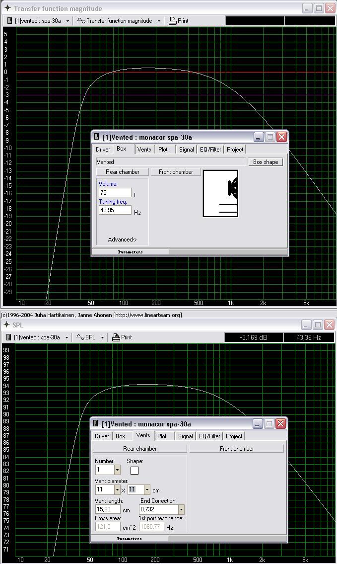

I have a great tip monacor spa30a, meets perfect your requirements.
MONACOR INTERNATIONAL
roduct detail page
Here with simulation and reflex port dimensions. 75L so that means a box of 60liter with stuffing.
Great alu frame and bottom price super price performance.
Mid frequency. 93dB.

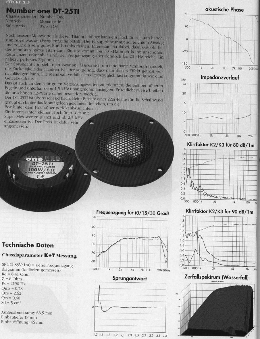

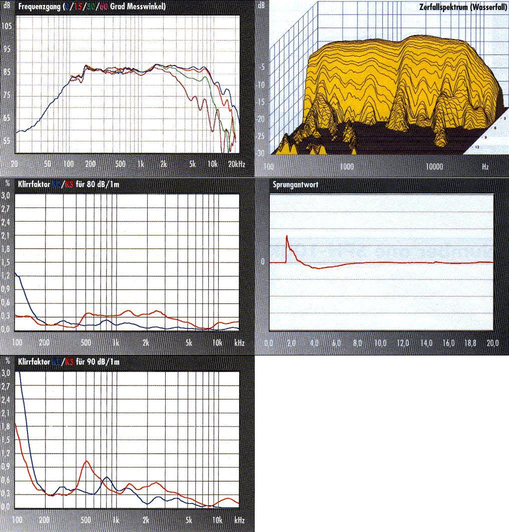

Papercone mid MSH115 monacor. low distorsion flat response. Medium price.

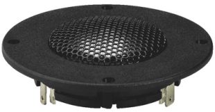

And the super measurements of the monacor dt25ti.

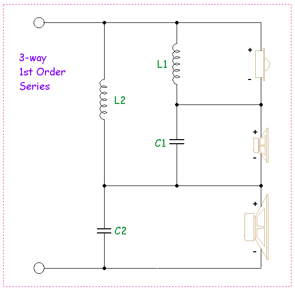

Helmuth... an impresive amount of suggestions! I must say I love the idea of a 1st order series crossover, I was also thinking about it, or a 1st order series everywhere, and second or third order for the tweeter only, if I have to cross it low...

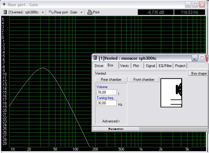

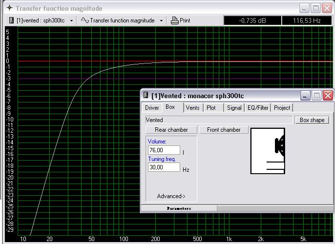

sph-300ct only connect one coil to have 8ohm.
Good suggestion that oberton chassis. Amazing price for such a cool chassis.
Again the sph300ct port tuned to 30hz.
And the port gain in the second picture.with the port near the floor it is possible to stretch the response down to 30Hz and that with 93dB/1wmtr. it doesn't get better then this.

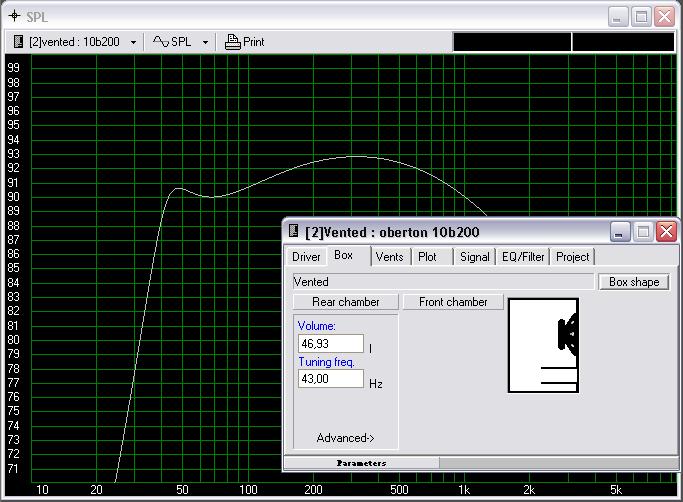

In simulation it shows that the oberton driver doesn't support 40Hz 93dB. it is 90 dBGood suggestion that oberton chassis. Amazing price for such a cool chassis.
Like some posts before when you want 93dB and cut off at 40Hz you will end op with the same group delay and port tuning and volume. Doesn't matter witch brand driver you find.
I did try it over and over again.
40Hz and 93 dB is a border when you go lower with the -3db point the efficiency will drop. The same as you increase the cut off upwards the efficiency increases.

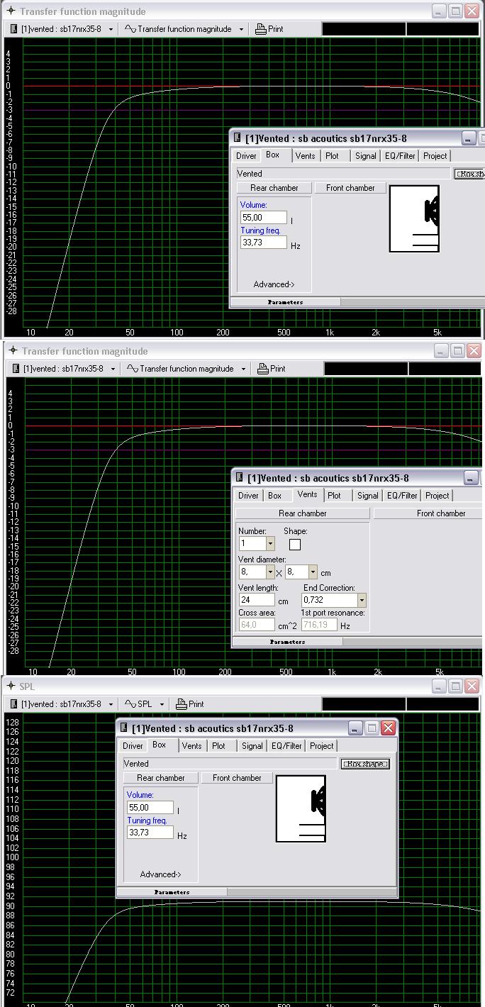

I think I'll go with 2 x SB ACOUSTICS SB17NRXC35-8 in parallel for each speaker. They seem to work great and go really low in 45-50 liters. Decent sensitivity, and I love the aluminium cast chassis, the low distortions due to a lot of cooper in the motor, and it has a paper cone. I'll mate it with an SB ACOUSTICS SB15 as a mid and a SB ACOUSTICS SB29RDC for a tweeter. I can't cross them first order, but I'm sure they will sound great!
SB ACOUSTICS looks like great drivers for the money. Are they available in Romania?
simulation calculates 91dB 1wmtr. SB-acoustics claim 89dB one driver that shout make 92dB for two drivers.
You can cross them 1st order why not maybe adding a notch filter, RC-RL impedance compensation.

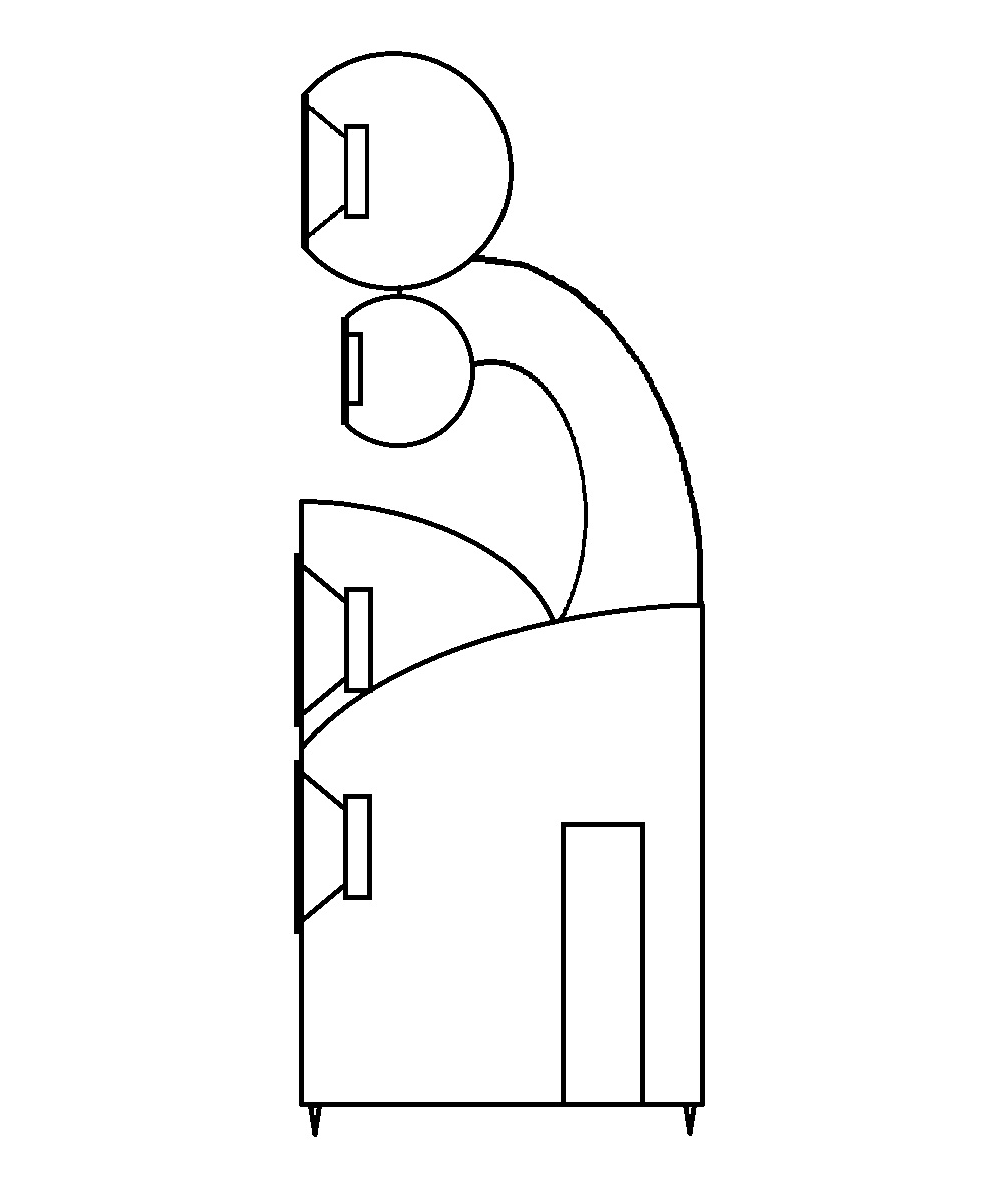

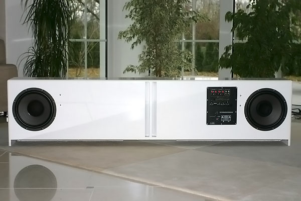

Now, I only have to decide upon the design, get some more money, and order the drivers. I saw a crazy, but very original, impressive and beautiful build thread on this forum, thread started by trusound:
http://www.diyaudio.com/forums/multi-way/169849-lowther-dipole-2way.html
I just love the bass cabinets and the arm holding the dipole in his project!
Also, I read a lot about the diffraction lately, and the fact that a spherical enclosure will cancel the diffraction better than anything else is stuck somewhere in my mind. So I was thinking about combining the 2 ideas, by building something like in the attachment (please excuse the crappy scheme, it's made quickly in paint). If not, I'll settle with a "classical" TransLam 3 ways tower, with a rounded cabinet, something like the "Sonus Faber Cremona M" speakers.
