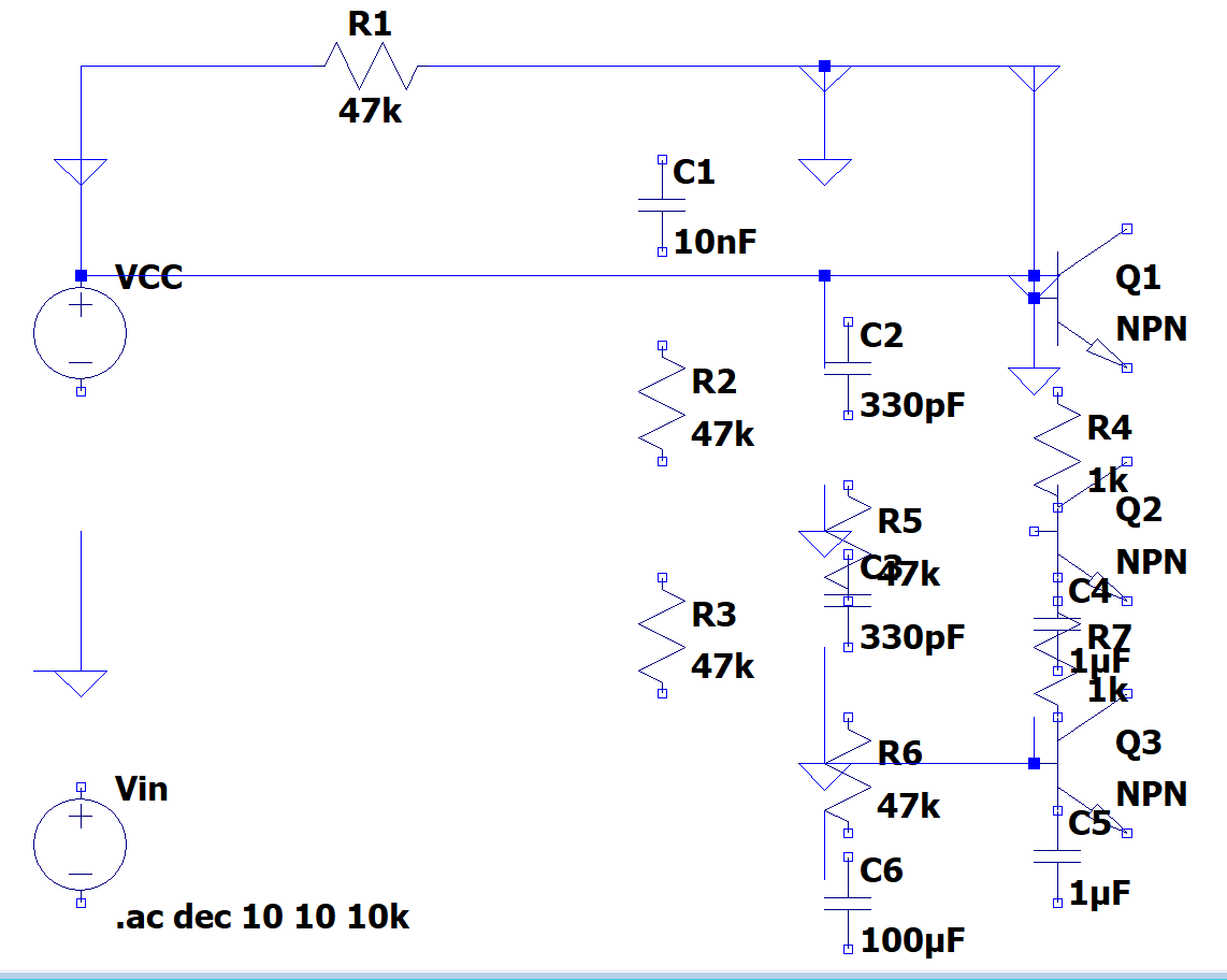

So Chat GPT can spit out Spice models for anything you ask it.
Like I asked it to generate a circuit for Phono Preamp that uses two transistors and a 18 volt power rail.
It can also output .cir files.
But try as I might I cant get the files to open in Tinia TI, Protesu, Or LT Spice.
The hint seems to be in the first line which starts with the words Version 4.0
Do you know which spice simulator creates .cir or .asc files with version 4.0 in the header.
Here is the .cir file it created.
If you want the spice model files it created which I cant open I can share that too.
I think it would be a great asset if we could get AI to output the modells. We then open those in LT Spice and do the final tweaks and checks. You can also prompt the AI to output in a specific format. Like create a LT Spice XVII Model for xyz. And it will change its syntax.

Jan i get the same results.
Like I posted you can also ask chat gpt to generate spice modells which you then save as a .asc file.
It does that too. If you want I can share the .asc files it generated.
Its possible that its an issue of version mismatch. I was kinda hoping somebody with an old version of LTSpice would be able to open it.
Chat GPT is getting better and better at this by the day. When I first tried this back in Jan of 2023 it would not even attempt it.
But AI is improving by the day.
I have now started to use the other AI platforms also. Like right now Im on Bing.
Bing handles images also. And it seems to do a lot of things better than chat gpt.
Its only a matter of time before this starts to work.
Meanwhile Im confused.

I use LTspice for sims, everybody here seems to do that, it is free and has a huge support base.
I also have Proteus but only use that for schematic drawing and PCB design.
Forget about ChatGPT in this context. If it puts together a text from text fragments it finds on the 'net, it is still text.
With asking it to assemble a spice model or circuit from pieces of models and circuits it finds on the 'net, that cannot but created nonsense.
Even if it 'looked' OK, how can you be sure it is a working circuit?? Or that the model is kosher? Forget that.
And unless your current CAD misses something you absolutely need, don't switch to another system, you'll lose at least a year in learning. Unnecessary.
As you say, at a certain age, you don't want to waste months or years. I'm also in that group!

In LT Spice, you just run the AC analysis instead of transient, and the frequency start-stop is part of that command. AC voltages have separate values for transient and AC stimulus analysis.

Because basically, the way it works is it looks at all the data it's been trained on to find things similar to the question it's been asked, and works out from that data what is most likely to be given in response. For a lot of plain English questions this ends up working well. For more technical things, it yields plausible-looking nonsense. It doesn't really understand what it's saying, even if it looks like it does sometimes.; it sees that people asking for Spice models are given responses that contain certain things like "WIRE -448 80 -704 80", so it cobbles together something containing similar text without knowing if it makes sense.Why does it generate garbage ?

Chat gpt can't be trusted! I also palyed with C programing language with chat gpt and found that chat speak nonsense, you need to tell him 5 times the same question and every time before question you need to tell him that he is wrong, after few - ten times sometimes you get correct answer! He apologizes a lot and when you criticize him for making things up and lying you get very interesting answers, like a living being manipulating you! Try that!

Sorry, not Cordell, I was thinking Corel, but its Cadence. They make you create an account to download the "free version", and hound you with marketing, so I just dropped it.What Cordell software? You mean his models?
