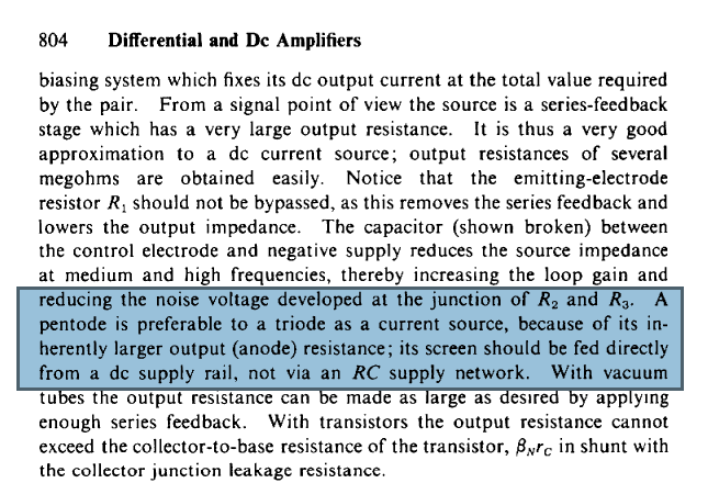

I ran across an interesting comment in Cherry & Hooper when I was developing my Bonseki 20/20 power amp design. See highlighted text in attachment. I ended up grounding G2 in the CCS because I didn't discover any difference in performance relative to resistor feed (from the V+150 rail). G2 ends up at the same voltage either way, and simplicity is often a good thing, but I would like to understand this issue better.
I believe I remember seeing comments from Wavebourn and Michael Koster indicating tightly regulated G2 voltage is preferable. Also VG2 relative to Vcathode, (leading to regulated cathode V). Is this what you're asking about?

A capacitor was deprecated because it was impractical to decouple the screen down to suitably low frequencies. These days caps are smaller and more reliable, but still, you can't maintain CCS action down to DC with just a cap. A zener diode (for example) solves these issues in an instant. The only thing you don't get with a fixed voltage is natural adjustment with age.I ran across an interesting comment in Cherry & Hooper when I was developing my Bonseki 20/20 power amp design. I ended up grounding G2 in the CCS because I didn't discover any difference in performance relative to resistor feed. G2 ends up at the same voltage either way, and simplicity is often a good thing, but I would like to understand this issue better.
The desired understanding came to me shortly after posting the quote from Cherry & Hooper. It's amazing, how this happens so frequently after stating the problem in writing! The CCS implementation in Bonseki has a minor design flaw. There is a small amount of subsonic common-mode current noise. That noise is cancelled in the output stage, of course, but it still interferes slightly with bias current measurement. When I was working with the prototype, I increased measurement averaging in my DMM to be more certain of the setting, but failed to make the causal connection.
This issue makes it more difficult than ever to justify the use of pentode CCS circuits. Bonseki is a fine power amplifier in any case, especially when its very low cost of construction is considered. More info in this thread: Bonseki 20/20 | Audiokarma Home Audio Stereo Discussion Forums
