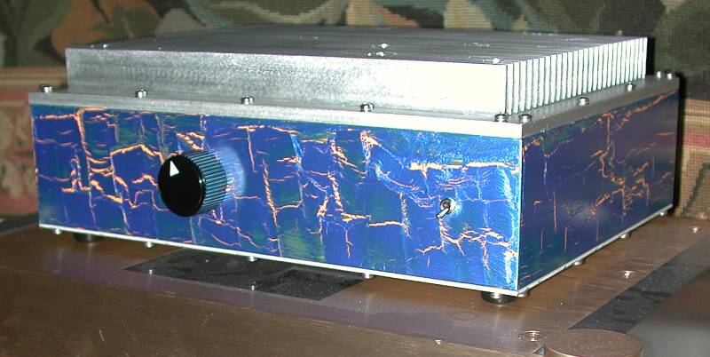

I drive a pair of Quad ESLs with my LM3886 amp daily. I put the standard parallel LR in series on the amp output and have never had the amp complain about the speakers at all. It sounds great, except that the 30W or so I am getting from the amp per channel is a little low for those speakers, limiting the distortion-free playback volume to something a little below bleeding ear drums level.
My amp is in an aluminum box with 1/4" thick sides and a cover that is all 10" x 13" heatsink with numerous fins. The amp chips are bolted to the cover of the box. I have never been able to detect more than 1 or 2 degree rise on the amp's cover, no matter how loudly or how long I play the amp. If I recall correctly, the transformer is a 320 VA and supplies both channels. I have about 112,000 uF in the power supply.
