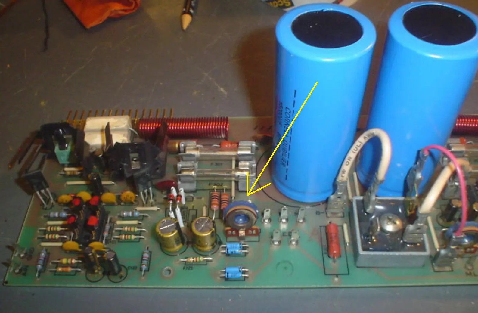

Hello everybody.
It 's my first post in this forum and I apologize for my English, I'm Italian and I use a translator to help me ..... the results are sometimes ridiculous.
I have also completed the modification of a Grandson following this tread .... then all the replaced capacitors and those of small value with silver mica except for 0.05 uf which have been replaced with 0.044 uf polypropylene. I used new Caddok 0.20 Ohms as emitter resistors and replaced the final transistors with ON MJ21193 -21194.
I have problems adjusting the Bias .... with the original pair (2SD426 - 2SB556) was not already adjustable over 10 mv .... but with the new pair the maximum value I can get is about 1 mv !!! :-(
the 1k r128 trimmer has been replaced with a new one of good quality.
I think it is necessary to change the value of R119 and R120, but this goes beyond my knowledge and so I would like to ask for help and suggestions to the friends of the forum ....

Hi Craig, thank you for answering me. Tomorrow I will measure the tension as you suggested. Yes the integrated mpq6001 should be working, in doubt I bought a new one and replaced it. Nothing has changed. Tomorrow (now in Italy it is night) I will let you know the value of tension between the bases of Q107 and Q108.

Well, I measured the capacitor C115 - C215 (located between the bases of the Q107 and Q108 - Q207 and Q208) and the values obtained are 2.08 v and 2.28 DC.
Qli MPQ6001 are 4 transistors in a single container. Before mounting them, however, I did a rough check with a tester and seemed to work properly.
The capacitor C115 (0.05 mf ceramic) that actually on the circuit was a 0.10 mf, was replaced with a polypropylene torque 0.022 mf in parallel ..... so it should be a 0.044 mf but I do not think it makes a big difference ... ...
