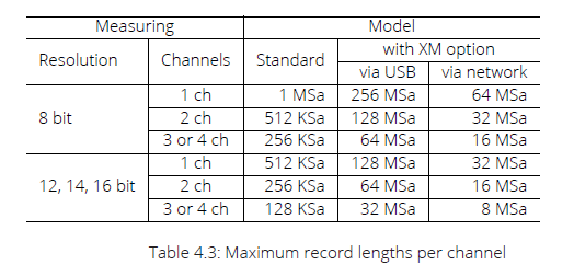

Recently I got myself a WiFi connected USB scope for total independence from any cabling.
Maybe that is an idea for your project as well - WiFi or Ethernet, same difference ;-)
Jan
AX tech editor
Joined 2002
I see. So that WiFi scope probably uses buffered streaming or something. It sure 'feels' like a regular scope.
Edit: yes, streaming rates and record lengths are lower with the WiFi compared to USB 3, if you have the extended memory model. With the standard memory it doesn't seem to make a difference.
Jan

I do not think your scope uses some USB-IP emulation for network access. A scope is not a continuous packet device like USB protocol is. USB 480Mbps sends packet every 125us, in proper operation none of the packets get lots. USB drivers can count on reasonable timing. If the USB-IP network layer between the USB device and the USB driver introduced large varying latencies, I would expect many USB drivers to fail. Especially considering the generally poor drivers quality for consumer devices...

Look at the measurement workflow described in LibTiePie: Main Page . The control software asks for starting the measurement, and then waits until the device -> library on the host indicates the measured data are available. This mode really does not require low latency and zero packet loss network - the software waits until the data are downloaded. No problem if it takes more time or if packets have to be retransmitted. That is a good design, suitable for wifi. But very different from how the USB works.
