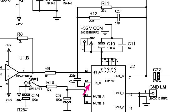

Please find see the attached schematic of my effort to reproduce the Cordell Super Gainclone using the LM4780 as opposed to the LM3886.
I have simulated the circuit in Proteus with some success and plan to see if it works in reality. Probably due to my lack of knowledge, the current mute circuit works in reverse, open circuit gives amplification. The output initially went rail to rail with SW1 circuit closed. Installing output caps C22 and C23 seems to have fixed that but I'm still unsure as to why.
I know it is probably futile to try to simulate the circuit as reality is always very different. I did this because it helps me to prevent catastrophic failure and wasted time.
I am not an electronics expert, and realise there are probably many errors in the circuit, therefore, I was hoping for any criticisms prior to embarking on silk-screening a pcb. I believe I need to separate the signal grounds from the power grounds.
Any input is more than welcomed.

Don't the "+IN" pins need a DC reference?
Pretty sure they do.

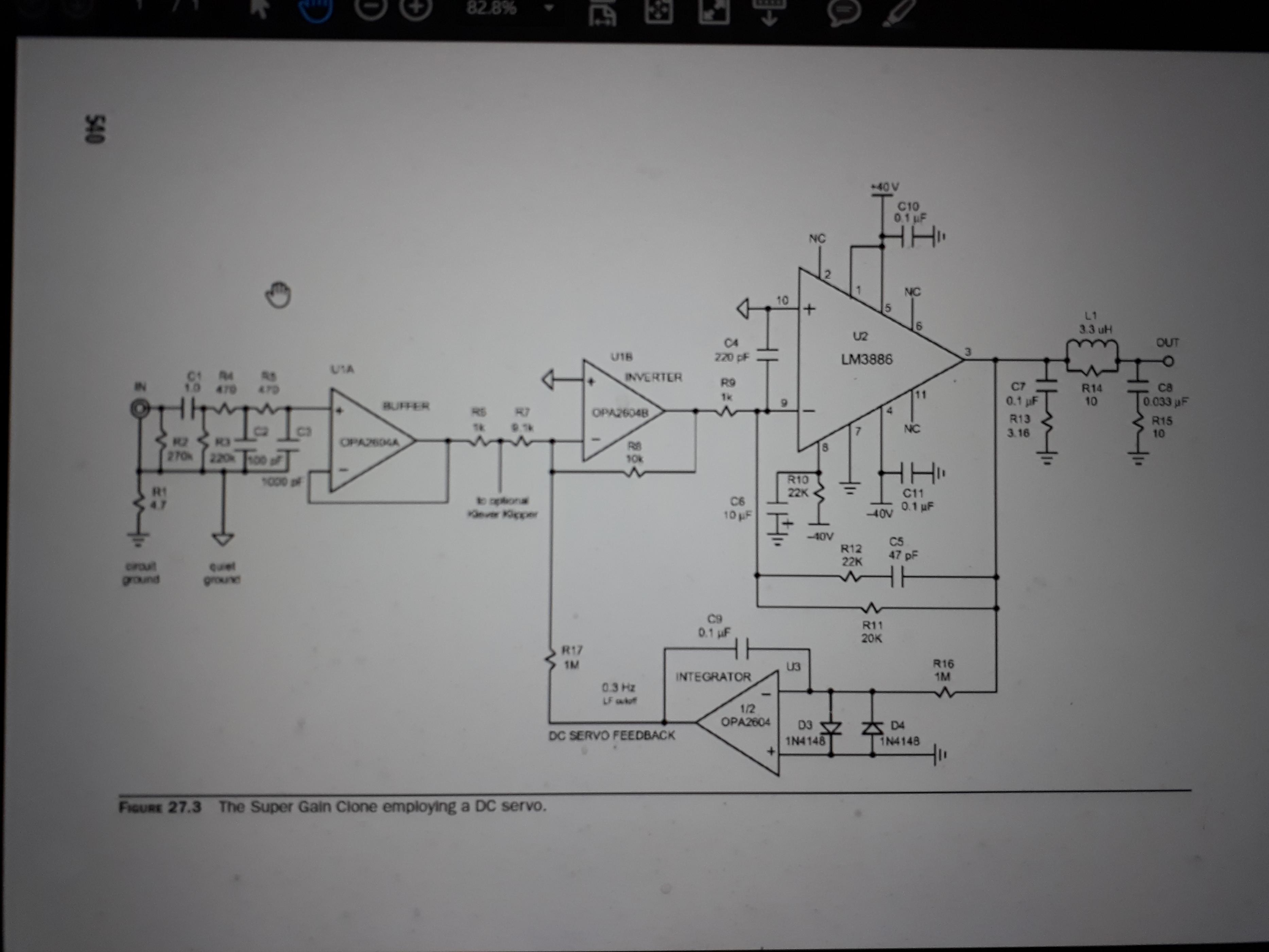

Look at the schematic on page 540 of Bob's book.
It's meant to be connected to the quiet ground. Pin 5 of U1:B and U4:B are also meant to be connected to the quiet ground.

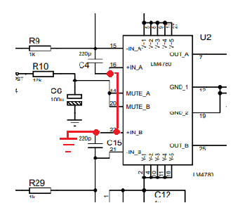

Pins 16 and 22, IN+A and IN+B should be grounded.

About the earthing?
Are you suggesting a single common ground? Bob's schematic has a quiet ground and a circuit ground. Quiet ground is connected to circuit ground via a 4.7 ohm resistor.

I've attached the DC Servo page from the Cordell schematic.

I have made the Quiet Grounds, please see the updated diag. I hope they are now correct.
Are there any other signal ground points that should go to the Quiet Ground?
The amp refuses to mute in this configuration!
