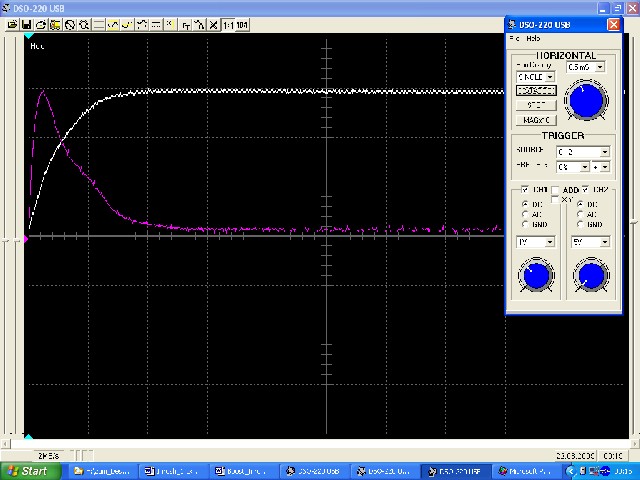

Encouraged by good support here, I decided really to set up
a SMPS for my sub. The SMPS will consist by a PFC boost converter followed by a forward halfbridge converter.
Typically such boost converters need a DC rail capacitor, which draws a heavy current peak during turn ON.
In my design this cap will be around 150uF and can already cause
a current peak around 140 A. My trials with 330uF even showed 180A
and flickering of my room.

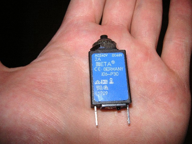

I found that bimetal overcurrent protectors seem to be able to handle this quite well.
Any experiences with such bimetal overcurrent protector fuses are welcome.
The attached screen shot shows the current pulse and charging of
the 165uF rail capacitor in worst case.
White trace: DC rail, 100V/div.
Colored trace: Charging current, 50A/div.

....well, at least nobody is crying: "Big NoNo! "
I forgot to explain why I am not planning to use a standard
glass fuse. I want to go for a safety class II design, without earth.
The related 2-pin mains connectors (like laptop SMPS etc.) are rated for 2.5A only. I don't trust a 2.5A glass fuse to charge 165µF/450V caps without inrush current limiter. Also these exchangeable fuses typically are replaced by somebody, without taking care about the proper rating....
After I found that these 2A bimetal overcurrent protections are able to handle the current peak quite easy.... I got a little bit concerned if they would trip reliably in case of an overcurrent.
But they do fine. When running them with 2.5A, they trip after 4 minutes.

I've used these bimetal switches for speaker protection applications. They are very effective in limiting RMS current while allowing for a high peak to average ratio. However, they seem slower than a conventional fuse during a short circuit and they are not going to help to reduce the inrush current peak so you may also need something like a NTC surge limiter.

The very slow tripping behaviour is matching to my own observation. And this exactly is my intension, I needed a fuse that can handle the inrush currents and still providing to trip at a rated current of 2.5A or less.

The short circuit protection, there is no limitation and in theoretical worst case some hundred A will happen and then this bimetal has to break it. Do such bimetal switches offer good "high breaking" properties? Or would I need a traditional sand filled glass fuse rated for 10A (so that it does not trip due to the current peak)....
