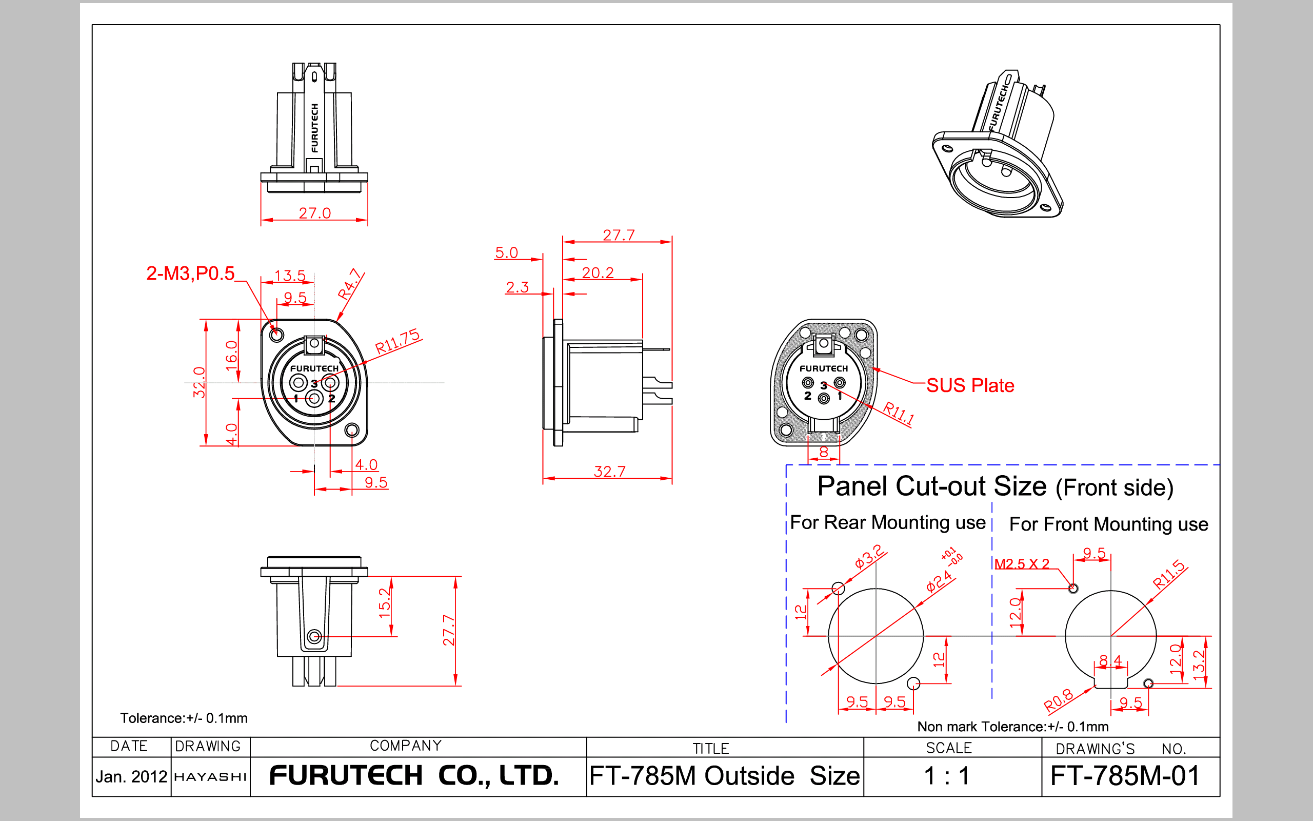

Came to mount these sockets on my prototype chassis tonight.
FT-785M(R) | FURUTECH
They feel like the quality socket I expected - however the 2 mounting holes are threaded, but no bolts are provided and the datasheet shows all dimensions but no info about what thread they are. Anyone know ? Perhaps M2 but I'd be guessing.
Astonished actually that a high-end product like this didn't come supplied with the correct bolts and nuts. Have mailed Furutech to ask for the data, expressing my surprise along the way.
Is it me ? Surely not too much to ask.

It looks as though these are designed to be rear mounted, so threaded holes will make assembly easy.
They appear to be a well designed connector, hopefully they fit a standard Neutrik 'D' size hole (24mm diameter) - but I imagine they cost many times more than wonderful Neutrik designs!
