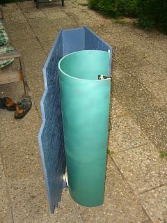

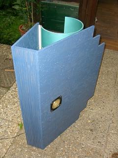

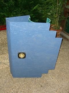

The speakers are attached to the wall. Angle is 30°. Drivers are FE126E. They sound like OB, not like BR or TL. The 2/3 tube forms some kind of horn. Bass is ok, I don`t find a sub necessary. Unfortunately the treble is far behind my Ciares, I would try the Supravox 135LB instead of the Fostexes next time.
Wow, that close to the wall! That setup looks more like some sort of TL ,venting at the top, I can't see OB there. Is the cylinder solid? The only scenario I can think of in that situation would be a flat panel baffle with your driver and lots of acoustic absorbtion on the wall behind. The frequency range of that tiny driver won't extend too low, where the absorbers have the least effect. Good luck!
AJ
AJ
The tubes are PVC inside and outside with some porous substance between that dampens very well. Front and rear are OSB, sides are Douglas fir to get good vibration transfer to the rear, where the vibes are swallowed by dampening material between speakers and wall.

The tube is attached to the enclosure via a hinge, so the horn throat can be adjusted. I was doing philosophy about my design yesterday: The horn is very short, so it is a hybrid between horn and BR. The compression chamber is open at bottom and top, so it is also a TL. The open design to three directions is like an OB. And the enclosure material (OSB) makes it a resonating enclosure. So it works according to all speaker principles I know. Listening to Stravinsky I found the bass is a bit tiny. I will build the recomended BLH design for the FE126E for comparison. I am no longer so shure that such a bit horn loading is a reason to use a Qts 0.25 driver. An alternative would be the the FE127E, the Ciare HX132, or the Supravox 165LB.
The Fostexes are not as bad as I thought. My glycerol threatment has showed results in the wet weather the last days. The cone has sucked up a lot of water and the treble is a lot softer now.
