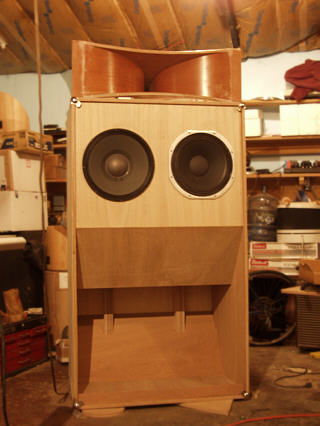

Another question. While looking for horn mids I have found a lot of info on the Klipschorns. I have some plans now and I was thinking they might be doable and I could put them in my garage in opposite corners about 18 feet apart. Now I would just need to find a suitable horn mid. I was thinking about this for the tweeter, http://www.partsexpress.com/pe/showdetl.cfm?&DID=7&Partnumber=290-534. Now for another question, instead of a premade horn mid could I build a conical horn such as the attached picture and mate it to a http://www.partsexpress.com/pe/showdetl.cfm?&DID=7&Partnumber=290-400 ??? I was also thinking about this sub for the khorn due to low fs and decent xmax http://www.partsexpress.com/pe/showdetl.cfm?&DID=7&Partnumber=295-190.
