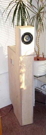

Is there any problem with running a 12" woofer wide open to an Fostex Fe126e.The woofer will be in a BR box and the Fostex Fe126e will be mounted on top of the woofer box in an open baffle...do I need a crossover?
It'll depend on the woofer you select. You should be able to leave the 126 alone & let the woofer handle the LF to an extent, although it's not ideal.
FWIW, I'd do roughly what Martin does on his 2 way OBs; simple 2nd order circuit; high pass the 126 at 500Hz & low pass the woofer at 200Hz, both of which are typically good points to place an XO.

Have you considered bi-amping? One of my systems is a similar setup (FE167E, though), with 4th order active Linkwitz-Riley crossovers before the amplifiers. Bi-amping is more expensive and complex, but does have many benefits - you should seriously consider going this way.audiophile36 said:Thank's Dave,
What kind of crossover should I use...I want to keep the Fe126e crossoverless?
If you don't want to biamp, then I think hm is right - you should consider putting the fostex in a small sealed box to roll it off, and cross the woofer in at the right frequency. Getting the phase and crossover curves right for such a setup will require some careful design.
It occured to me earlier, why a BR for the woofer? If you don't have the drivers already, I'd probably just go for Martin's 2 way (well, FR + woodfer) OB, or a variation on that. It won't lack for LF output, and the Eminence Alpha 15 isn't a pricey unit.

Thank's Scott I have seen some really nice OB systems and I actually have a OB system with Fostex Fe126e and they sound great except the low bass... mid bass and up is great though. I really want to place a 12-15" woofer on the same baffle as the Fostex.The reason I ask about the crossover is because I have owned and heard commercial speakers Like the EPI-100 and MMDecapo's run the woofer full range with a cap on the tweeter to limit bass from damaging the driver.I thought I could do the same thing except I wouldn't need a cap because the Fostex wouldn't be damaged by low frequency information.
This a 12" w/ 5" Seas w/ a 500-600 simple XO, single coil on the 12" & 2nd electrical on 5" which is I think a 3rd anyway with the small 10" wide baffle . You will most likely have to pad the Fostex a little, no big deal , just use Mills etc..or L-pad, transformer, etc..mine is -3db on the little seas mca15rcy, this is a great small OB mid by the way.It is very important to try & acousticaly alighn the drivers, I do it in the primative way shown. Just try the Fostex ran fullrange & 12 rolled & then HP the Fostex & listen. I would strongly suggest 500-600hz on the little Fostex.

More of a wave guide gig than horn. They are simple rubberwood salad bowls. I have many refined OB system's, these are not of course. I think they vibration gig is over rated in OB land. especially if they are mass loaded etc..I usually use 1 1/2" around OB woffers area's. These wave guides provides the best stage & detail I have ever heard in any OB . mid is padded -3db is all. hard to get OB bass wrong if good driver is used IMHO. Bi-amp-tri , single amp doesn't seem to matter, what matters IMO is a good behaved drivers that perform in OB..Once refined I will rebuil, paint & secure in rigid fashion & many other things. Most people seem not to choose to try & alighn driver's . My B200's were not near as good as the little Seas in OB. Keep the mid range baffle narrow & try to get a wave guide on it. It was a eye opener to what can happen. The OB magic stays & everything snaps into focus in very precise & eary way. No honk, no shout.

The 126 is really going to suffer with no XO at all in an OB... your best bet is bi-amping with a 1st or 2nd order PLLXO built into your HF power amp. The woofer is less critical.
