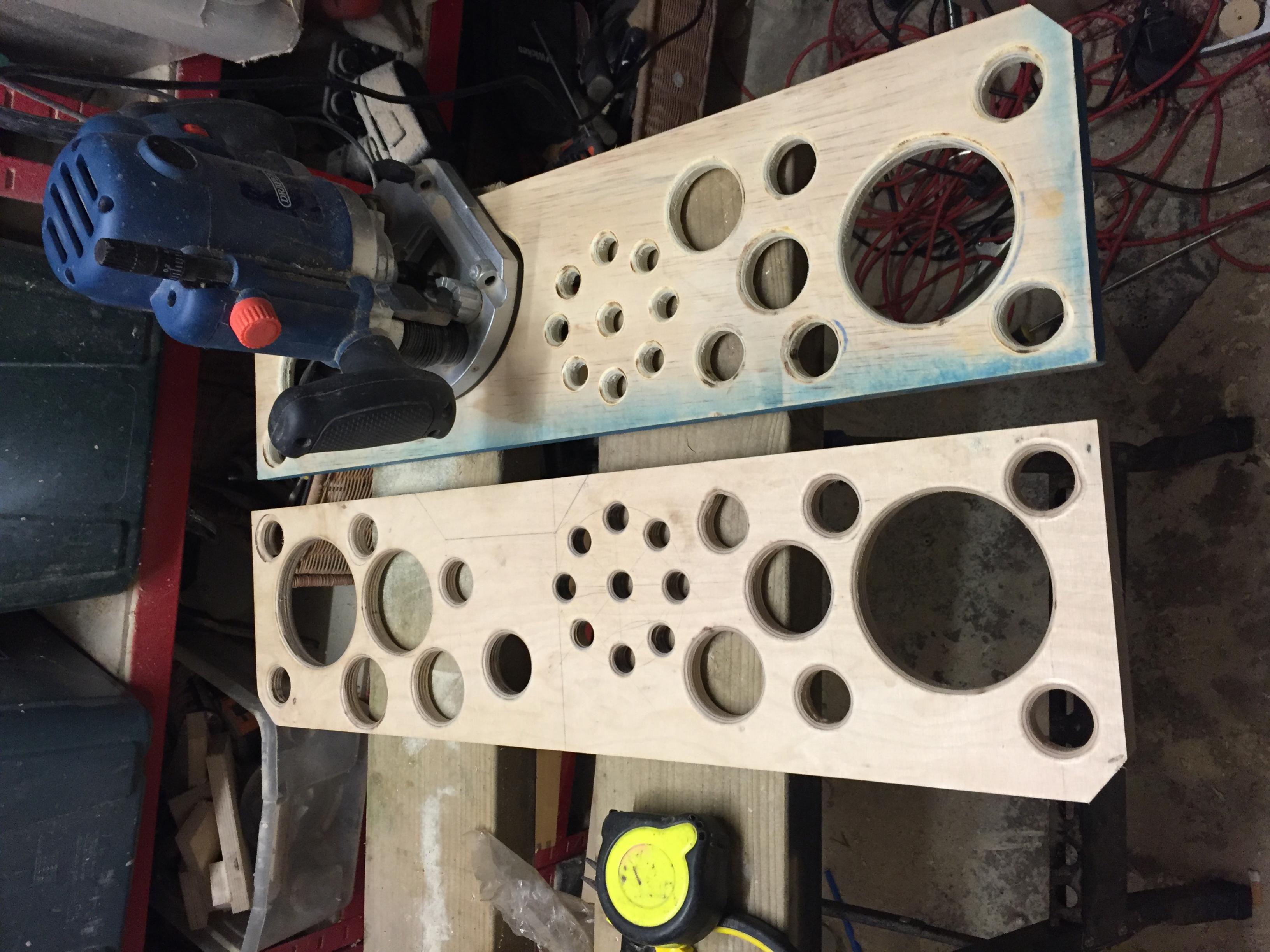

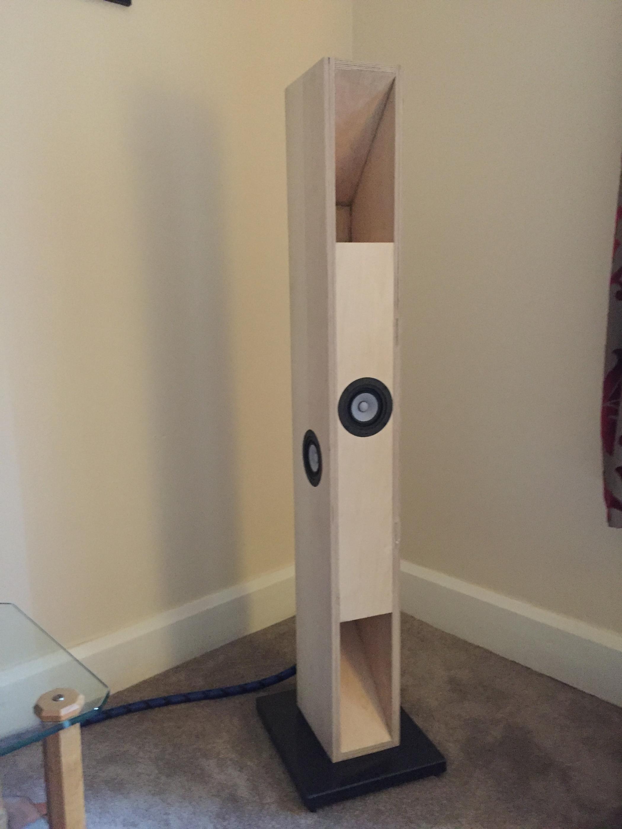

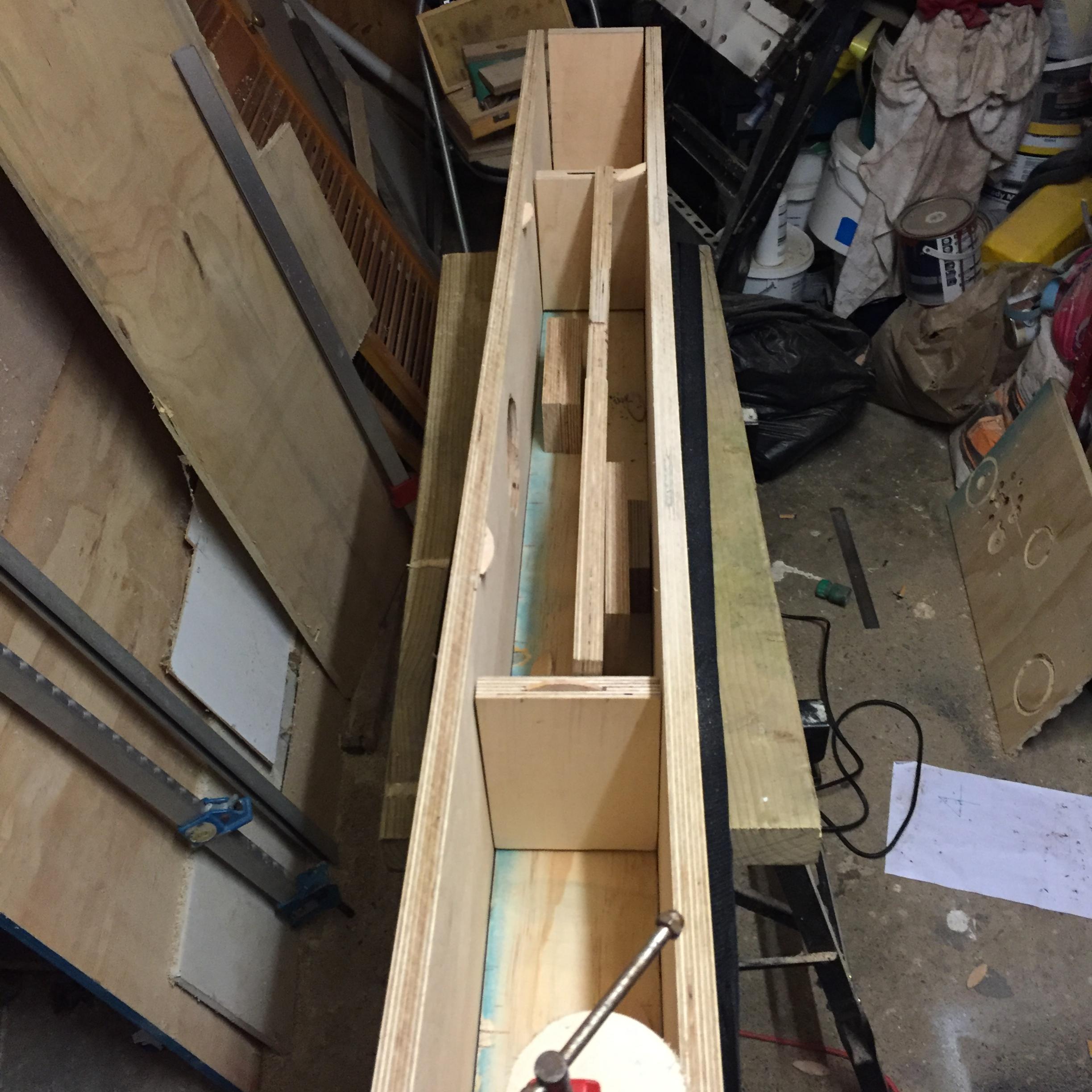

I had Avon Plywood cut the birch ply and then routed the internal braces, speaker recesses and biscuit jointed all side panels. I lined the internals with about 0.5 inch wool panels. Lots of glue and clamps later and after a quick sand the divers were flush installed and binding posts fitted and connected.
All had gone pretty well so far. As I hooked them up to the hifi, fatal flaw discovered. I'd not made them left and right handed! After a bit of magic with the router, problem solved....still hacked me off mind. I've yet to apply any stain as I quite like the birch ply finish but may well veneer them to hide the mistake

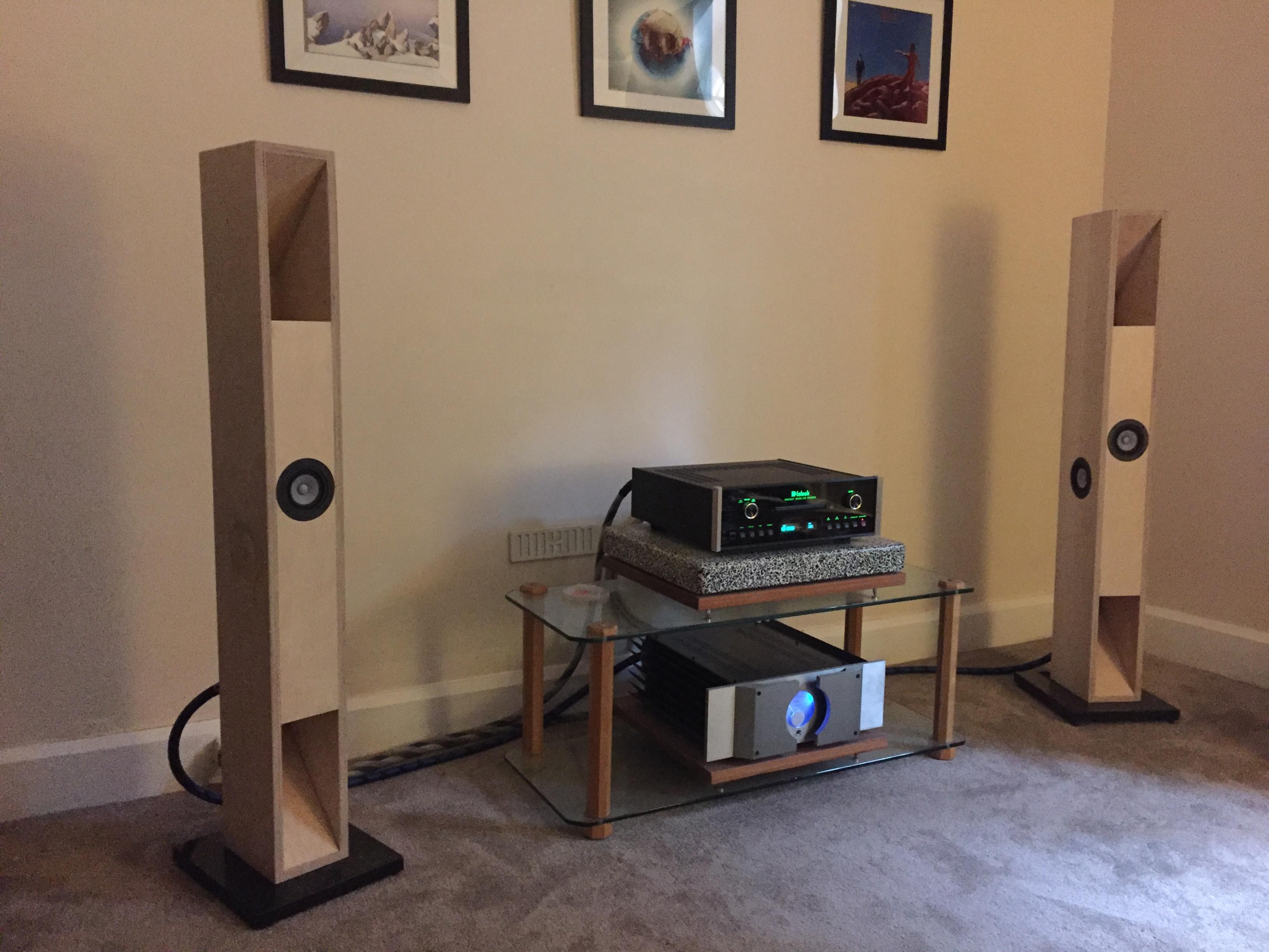

Sound wise I've rather had my breath taken away. Initial impressions were that the bass, although not room shaking, was more than respectable. Detail from mid to treble is a real strength and although the treble started bright I added some additional wool above and below the drivers and the sound is a lot more balanced and treble less shouty. In the blurb from Alpair they mention a 200hr break-in. This is true, they are improving the more they are used. Sound staging is good and rather suprisingly handle all music types.
Overall, for less than £200 these are a remarkable design and I'm now on the hunt for another full range build...... suggestions?
