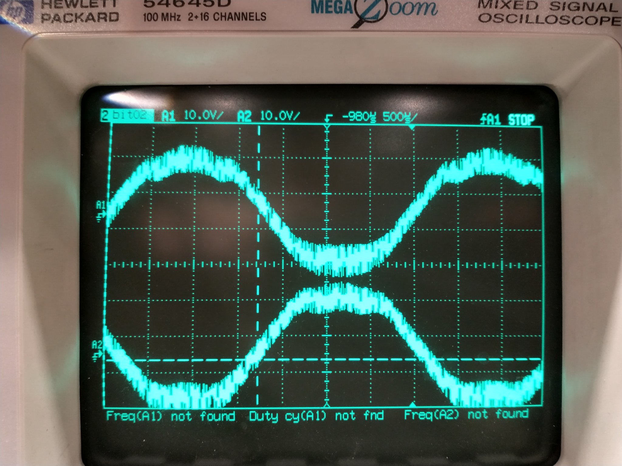

Hi.

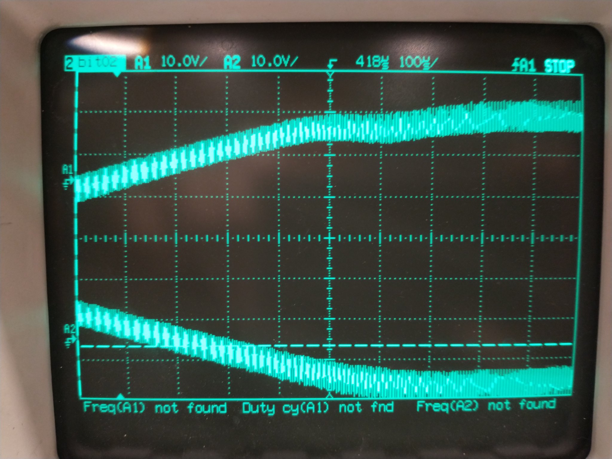

Im struggling with a very basic full-bridge setup. Feedback is a UCD-style back to both inputs of an lm311. No matter what feedback arrangement i try, i get the same odd waveforms when looking at the 2 half bridges individually. When looking at the actual differential signal between the half bridges it looks better, but still odd.
The behaviour is load-dependant. With light/no load the waveform are very good and sine-like. With load and low levels the waveform are also ok. Based on simulator models I have a strong feeling that the change on the sine-wave is where the output inductor goes from continuous to discontinuous mode. Any ideas on what to look for? My control-theory is light-years away from doing a full analysis of this.
First picture is output from the 2 half bridges. Second is a zoom on the point where the sine changes. I realize it's a bit hard to fully see

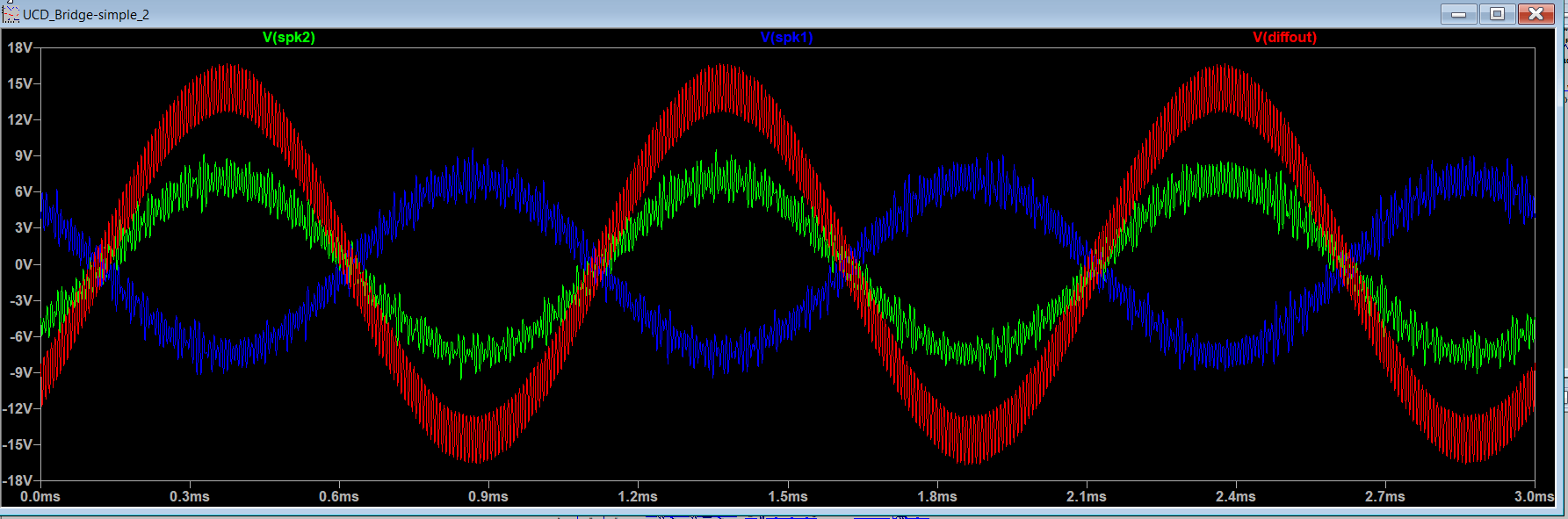

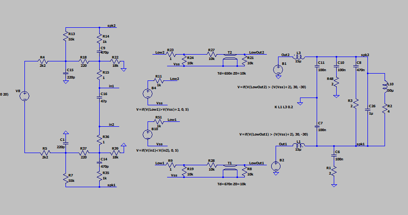

Simplified LT-spice schematic is attached. While not giving identical results compared to prototype, the simulation clearly shows that the waveforms from each half-bridge are not pretty sinewaves, - but the difference-signal is ( at least in the simulation).
Fidling around with the feedback components and will alter the waveforms, but not the overall result: waveforms from each HB appears a bit erratic/random,
I realize that as long as the differential waveform is good, thats all the speaker will ever "see", but the erratic HB-signals appears non-stable, and I like my amps to at least appear stable 🙂
Actual output-circuit is IR2184 + 2XIrf530. While not "good" in any way I have used that exact combination before (in half-bridge) with very fine results.
This is some of best waveforms I can get from the simulator. Proto-type waveforms are worse. - but simulator do not include the large deadtime from IR2184, so there ARE of cause differences.

Bucks: i have scoped the output with an analog scope in dif-mode. Indeed the waveform is better and distortion below 0.1 when level is low, but the "kink" in the sinus is still present at higher levels
I do not see a post-filter feedback in your simu. So, yes, there may be some influence of magnetizing current through ouput inductor. Disappearing magnetizing current stops charging output capacitance and directly influences output voltage ramping. IR2184 is way too slow imho.
Bucks: Pease see the nets spk1 and spk2. That's the feedback after output filter.

Half-bridge circuits are bidirectional converters and therefore always operate in CCM. Even at light loads, excess energy in the output capacitor can still get back to the DC bus.The behaviour is load-dependant. With light/no load the waveform are very good and sine-like. With load and low levels the waveform are also ok. Based on simulator models I have a strong feeling that the change on the sine-wave is where the output inductor goes from continuous to discontinuous mode.
This maybe easily visualised by looking at the converter in direction of reverse power flow (output to input). The observant person should see a boost converter.
Try reducing the dead time to see if the distortion reduces. The blips occur exactly where the load current changes polarity.Any ideas on what to look for?
