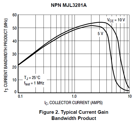

The fT/ic characteristics of power BJTs is rarely published and if, then logarithmic scale for fT because it is close to horrible.
Some widely used fast power BJTs start with a mere fT of 100 kHz at ic= 50 mA
and reach fT 60 MHz at ic= 3 amps.
In terms of compensation, effect of nfb, reactive load this means designer have to take the lowest fT into account.
While the effect can be easily understood from both technology ( such as ring emitter multi-emitter etc.) and semiconductor physics, it is hardly ever mentioned.

For power Mos : fT = gm/(2*pi*Cin)
and also here gm and Cin are dependent of drain current. It should be so that
Mosfets are also significantly slower at low Idrain.

Here is a datasheet which does publish fT versus Ic: http://www.onsemi.com/pub_link/Collateral/MJL3281A-D.PDF I think you may enjoy viewing figure 2.
