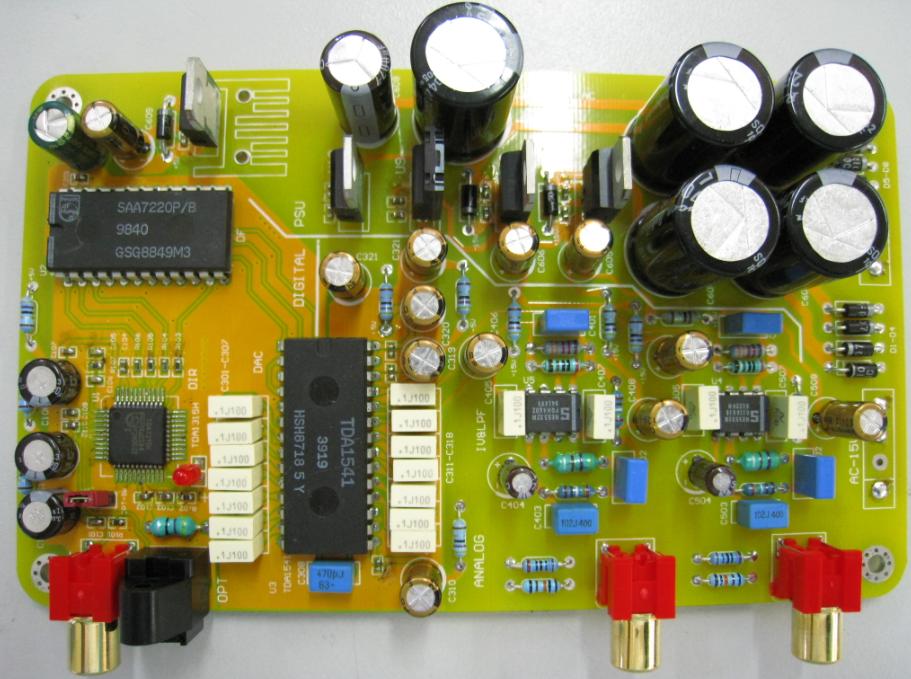

Fully assembled DAC kit based on TDA1541, atractive listening,low cost:D
32KHz/44.1KHz/48KHz input sample rate supported
COAXIAL and OPTICAL input supported
Fully assembled and tested
Fully audio grade components
Easy to build, high performance
Low cost
Dimensions: 89mm*157mm*30mm
*TDA1541, TDA1315, SAA7220 and NE5532N are used ICs
USER MANUAL is ready,just drop me an email :) bbp6604560 at hotmial.com
The kits will be available in 18th,Oct
Price : 70 USD , paypal fee and international airmail registered included :D
thank you alllllllllll :)

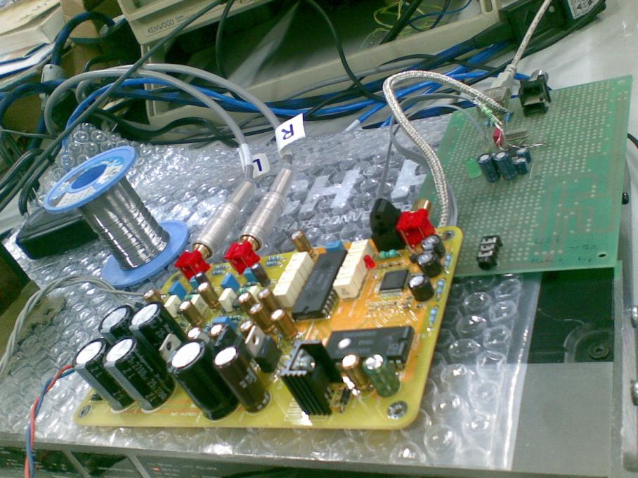

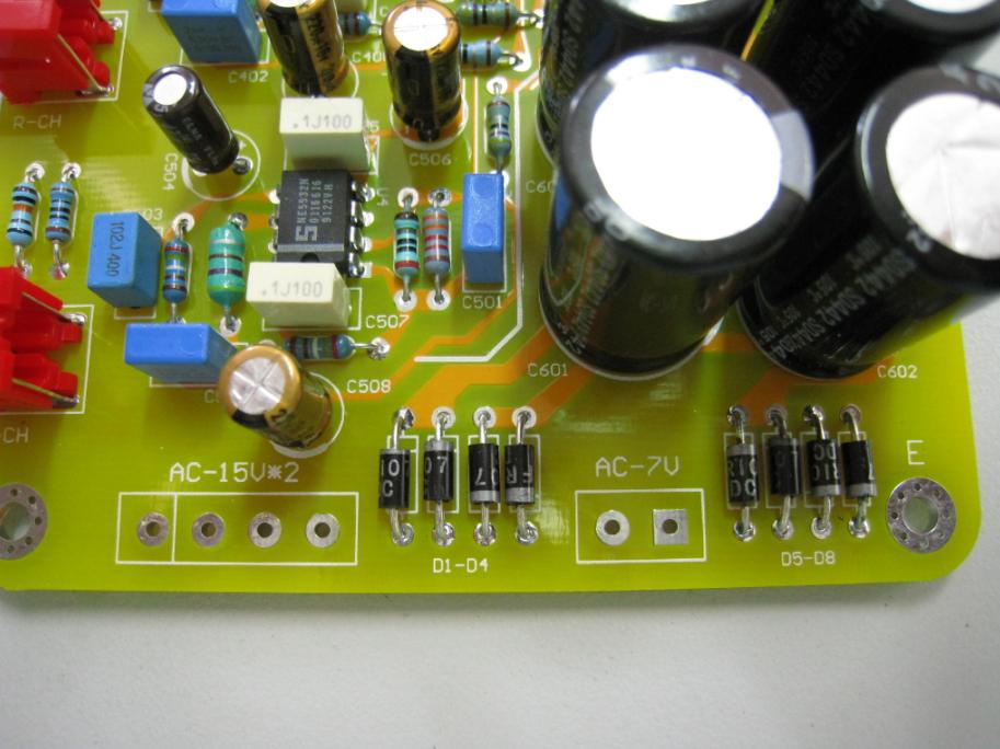

You may need an additional transformer to finish the PSU part,
a 15VA~20VA transformer with AC 15V*2 and 7V*1 :)
