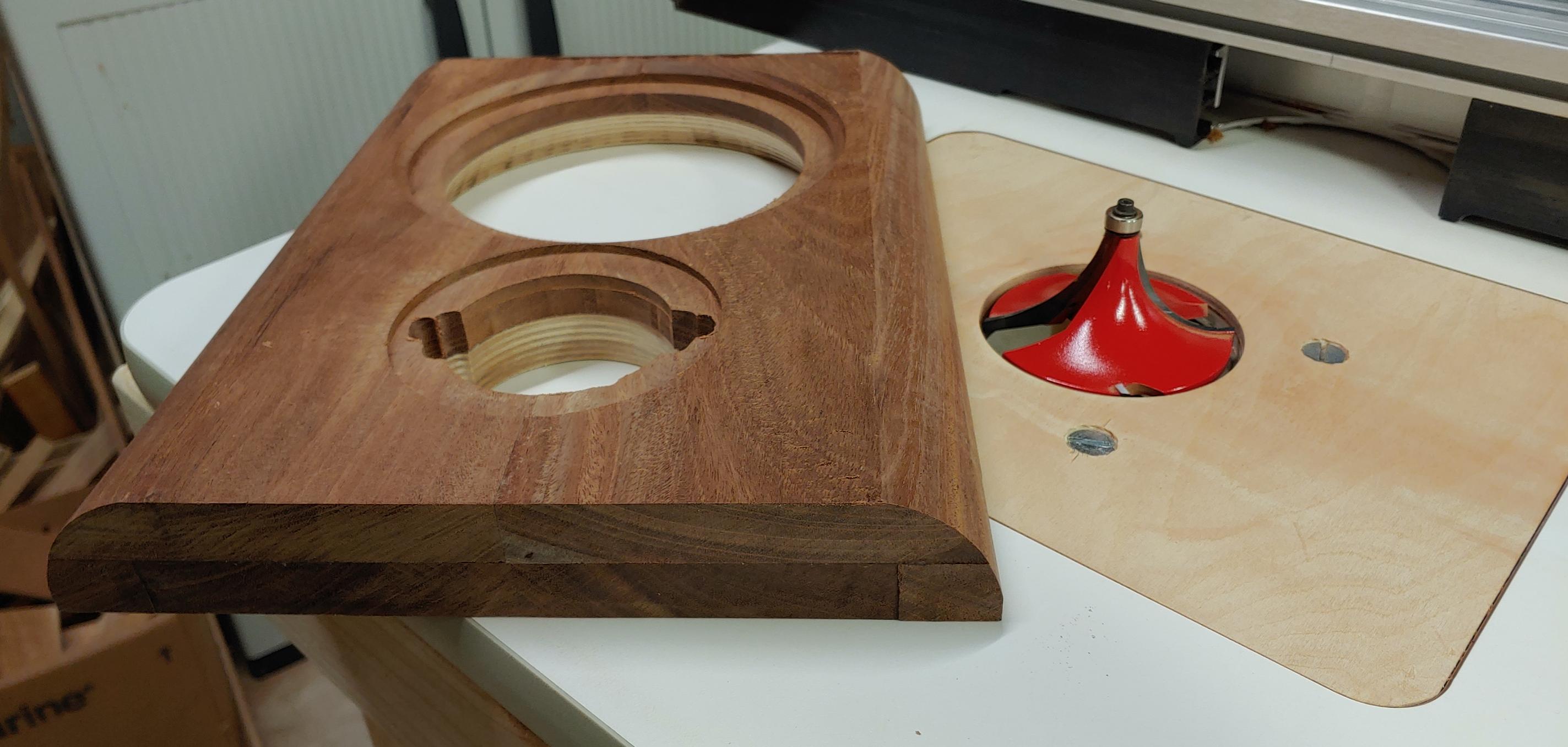

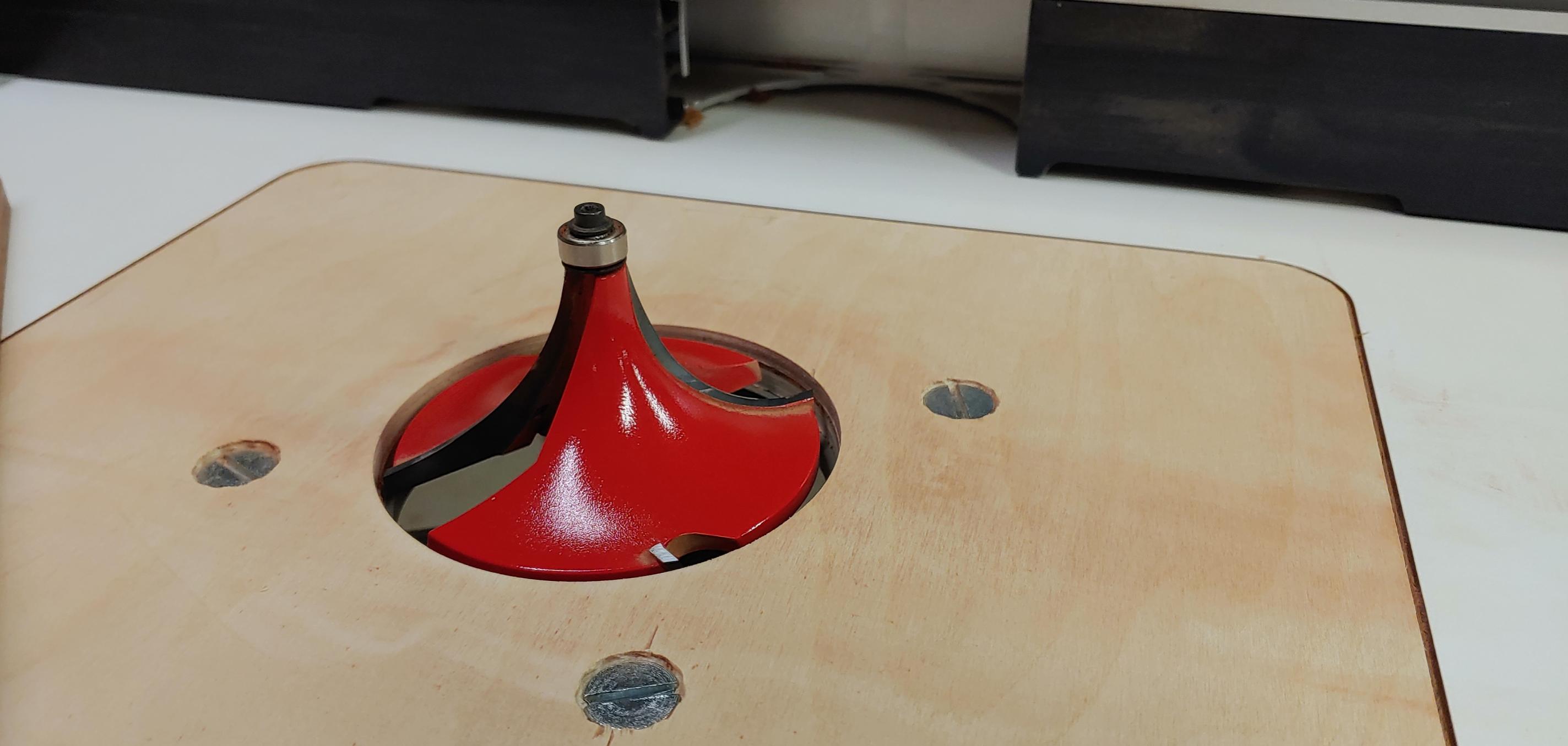

I just finished putting a rounded edge on my baffles. Although I have a lot of experience using a router in various woodworking projects, this is the first time I have used a router bit this large. It is the "Freud 1-1/2" Radius Rounding Over Bit, 1/2" Shank (Quadra-Cut) (34-140)".
I have never been disappointed in the quality of Freud bits. In the US and Canada, Freud bits are one of the higher priced options... not sure how they are priced in Europe, South America, Asia, Australia, etc... This bit is no exception... expensive but very high quality.

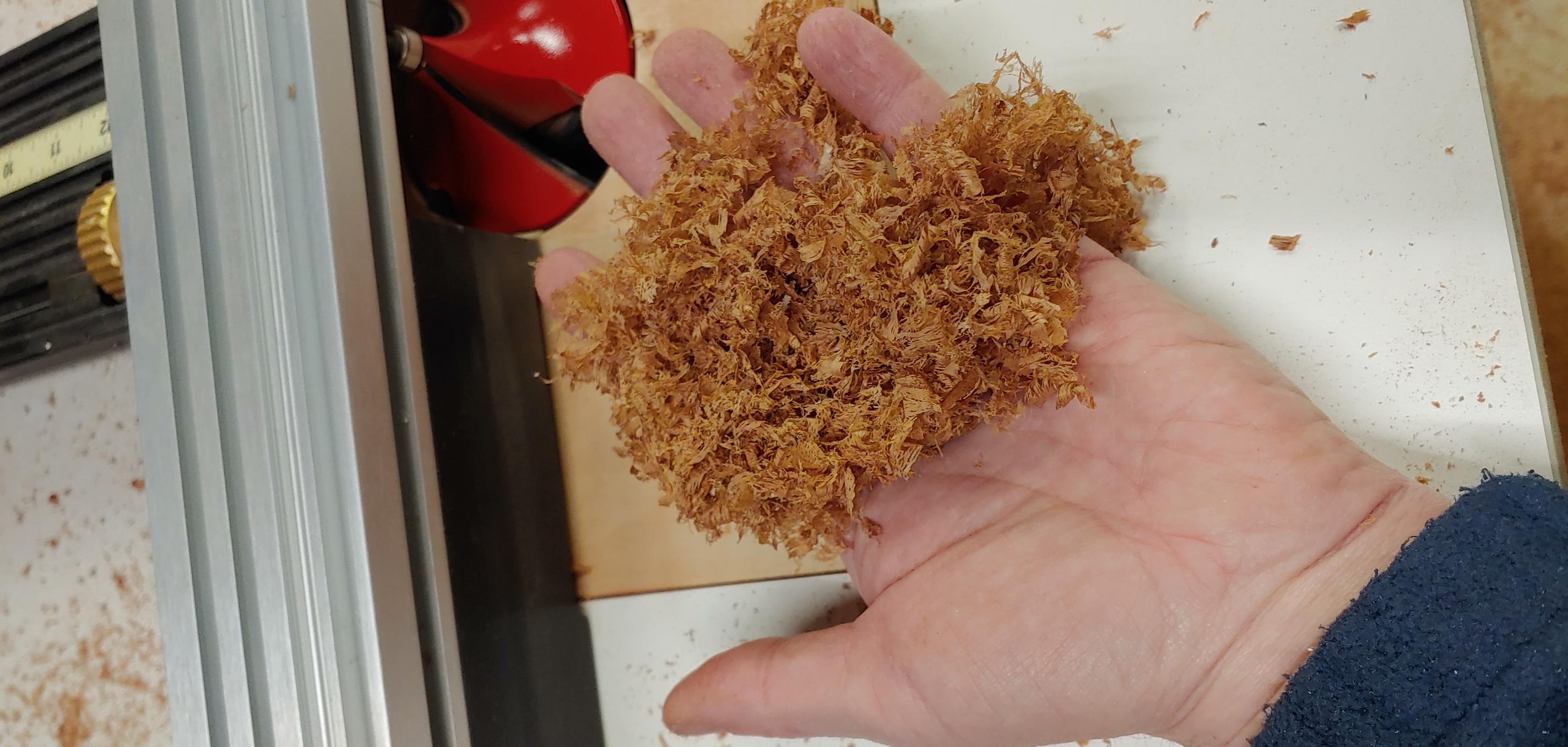

Notice the shavings I am holding in my hand. Rather than dust or fine chips, this bit made huge piles of shavings, similar to a block plane. (of course if I was cutting plywood or MDF, I would get dust and fine chips). The bit performed flawlessly. I was concerned about tearout on the end grain of the exiting side, but none happened. Cut quality was excellent.

I have a 15 year old Porter Cable 3 HP router. Yes power is important, but I was taking a small amount off on each pass, so not a lot of power was being delivered to the bit. The first pass was about 3/8 inch, and then 1/8 inch per pass after that, with the final finish cut of less than 1/16 inch. I fed the stock pretty slowly. If my router was a 2 hp unit, I doubt I would have noticed.
More important is low speed. This bit has a 12,000 rpm maximum. I ran it at 10,000 rpm.
Most important is a good router table and a good fence.

Mine is actually a 7539, which is apparently no longer made. yes it is a beast, but as I said, I think a 2 HP machine would work as long as you take small cuts and spin the bit at 12000 rpm or less.
