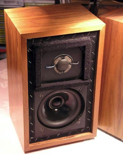

I used to have two pair of Chartwell LS3/5 A's which I was told were better sounding than the Rogers version. I finally sold one off to a friend who was begging me to sell it. Once he got it, he promptly blew it up. The pair I still have, I completely redid the xover capacitors with polypropylene where I matched all the original cap values within 1% - significantly improved inner detail, btw and I recall I had to replace the woofers once. At $1495 for the new ones I wish I still had that second pair to sell of (it was bone stock).
I believe part of the original LS3/5A sound was claimed to be due to the type and thickness of the plywood used, and perhaps bitumen dampening. The woofer mounting behind the panel and the dampening ring around the tweeter were also supposed to be part of it. Even the grillcloth was supposed to be part of the equation, made out of some material they stopped manufacturing a while back, although I always liked the sound of my Chartwells better without the grillcloth on.
I visited Chartwell's factory in Mitcham, Surrey many years ago for a speaker repair. Very small outfit actually. 3 or 4 people IIRC. The carpenter's workshop took up most of the space.

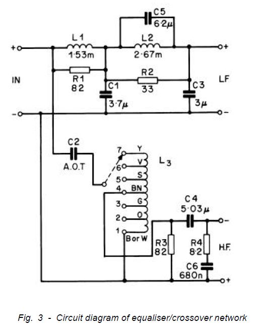

The crossover is interesting. It has huge 4mH bafflestep which makes it bassy. The tweeter is wired negative polarity as is common with many BBC designs. That is why the woofer is recessed and mounted on the back of the baffle approximately half a wavelength at 3.5kHz crossover.
The 1.5kHz LCR midrange notch is the only real complication, the autotransformer on the treble being a level adjustment. It might as well be a coil. The RC Zobel on the tweeter shouldn't actually do much, but corrects impedance so the filter is more accurate.

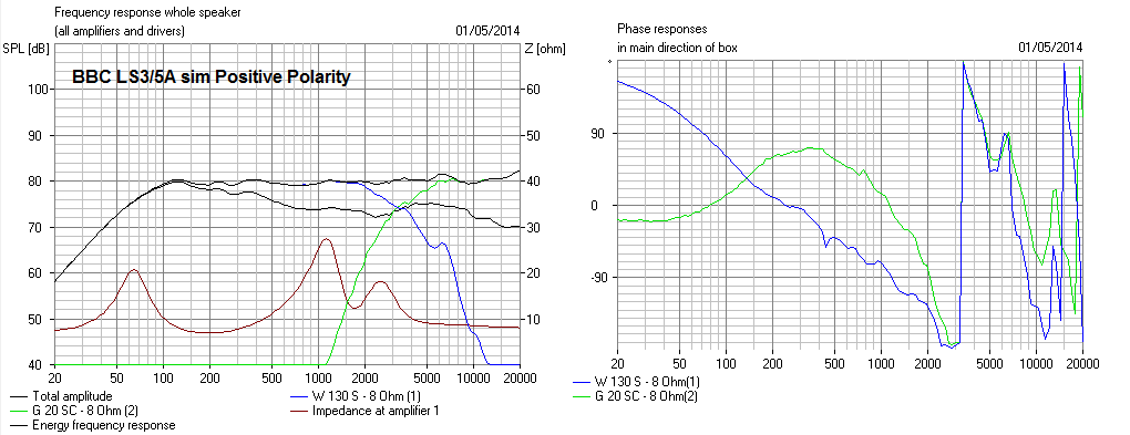

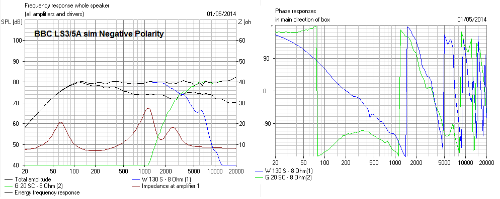

The most significant design decision was the negative polarity filter IMO. It would have worked better on paper with a positive polarity. In fact, all that depends on is how much you recess the bass, the filter itself is unaffected.
Modelling it now with modern drivers, the big 4mH bafflestep makes for a peak in the bass. I got something more balanced with about 2.5mH overall. I kept the midrange notch which suits many 5" drivers, and it was very flat indeed for a 3.5kHz crossover.
The way the BBC aligned phase, it is good at crossover, but wanders off away from there. There may be something to be said for that. The cone breakup tends to null, rather than reinforce. It's a thought!

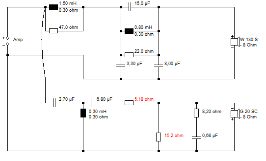

I might as well give you the LS3/5A sim I did. It's interesting for crossover enthusiasts. 🙂
I used paper bass and a 8L volume, which is neither here nor there for the essential features. I played with the time alignment too.
You can see the negative polarity filter works well. Recessing the bass is problematic in practise though. With the lower bafflestep and the shallow chassis I used, it needs near on 5cm recess for negative polarity. That's not going to be doable unless we have a brainwave. 😀
You can see the cone breakup at around 6kHz behaves 4dB differently with the two designs. That's a lot.
The result is very similar to the original, especially on the double hump midrange impedance, the top end being just a question of filter damping:
