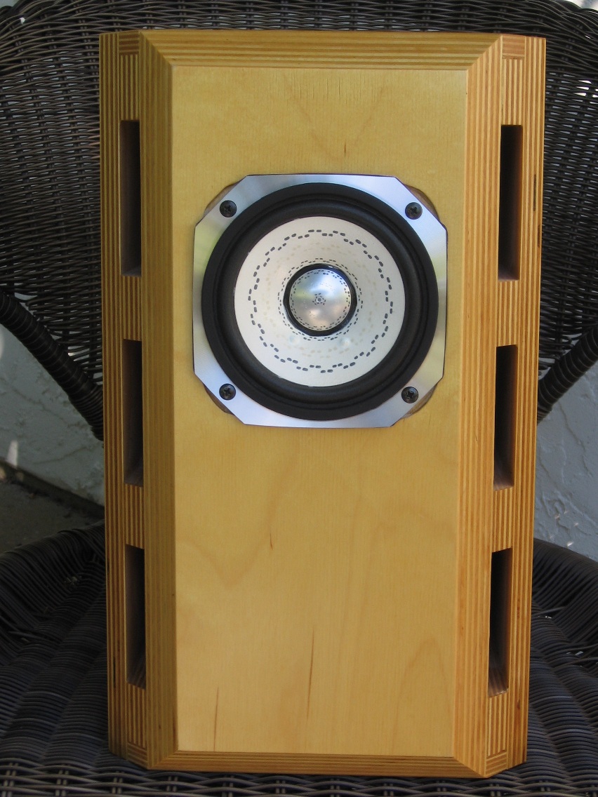

Many years ago I built a pair of mini-Onkens loosely based on Dave's original Fonken for the FE127E. They turned out to be pretty decent, but the 127's were just a bit too forward around the 6-7kHz range. With a bit of routering, I managed to shoe-horn a pair of FX120's into these boxes, and the result was impressive. This box is a little on the big side at ~14.5 Litres, with a bit of a hump at around 70Hz. If I were to build another pair, I'd probably go a bit smaller, say around 12 Litres. Either way they'd be better than the Fostex boxes.😀
BTW, the drivers were EnABle'd by Dave, which takes them to a whole notha level sonically, and they look very pretty too.
Those look absolutely fantastic. Do you use any BSC with them or do you find that they sound balanced enough without it?
Never thought they needed it, but I've never had anything other than tube power amps in my main system with these speakers. With solid state amps, a little bit of BSC might be required. I've run them with a small powered sub thou, as they need a bit of help down low. Quite a good combo, even with the cheap sub.
