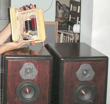

Pic of a 3-way with WR125 & Extremis

My plan was to use this tweeter with the Vifa 5" (P13WH00) for a pair
of fairly inexpensive bookshelf speakers.
zener_diode said:My plan was to use this tweeter with the Vifa 5" (P13WH00) for a pair
5k works fine with the P13 ... we used a modified VIFA with our build. I may still have a set of P13 and i know we are hoarding 2 pair of the tricked out tweeters. We liked them with a single cap on the tweeters (see the diyAudio Ref thread/Wiki article)
