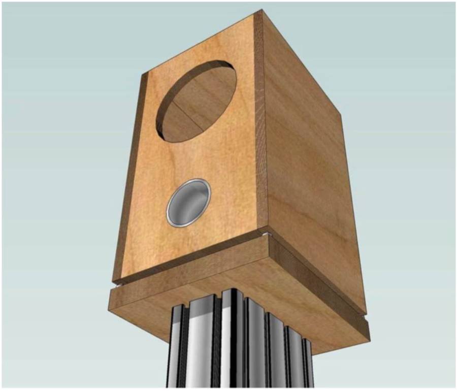

Plan for FE207e in 45 liter box?

Both the 206e and 207e will go into a ~45l box. The result are quite good, although not as good as putting them in my big MLTL. The 207 needs a rather high tuned step filter and the 206e needs some serious attention to the rising FR. I haven't tackled a filter for the 206e yet. I am using the equalizer in Foobar2000 to tone it down.
