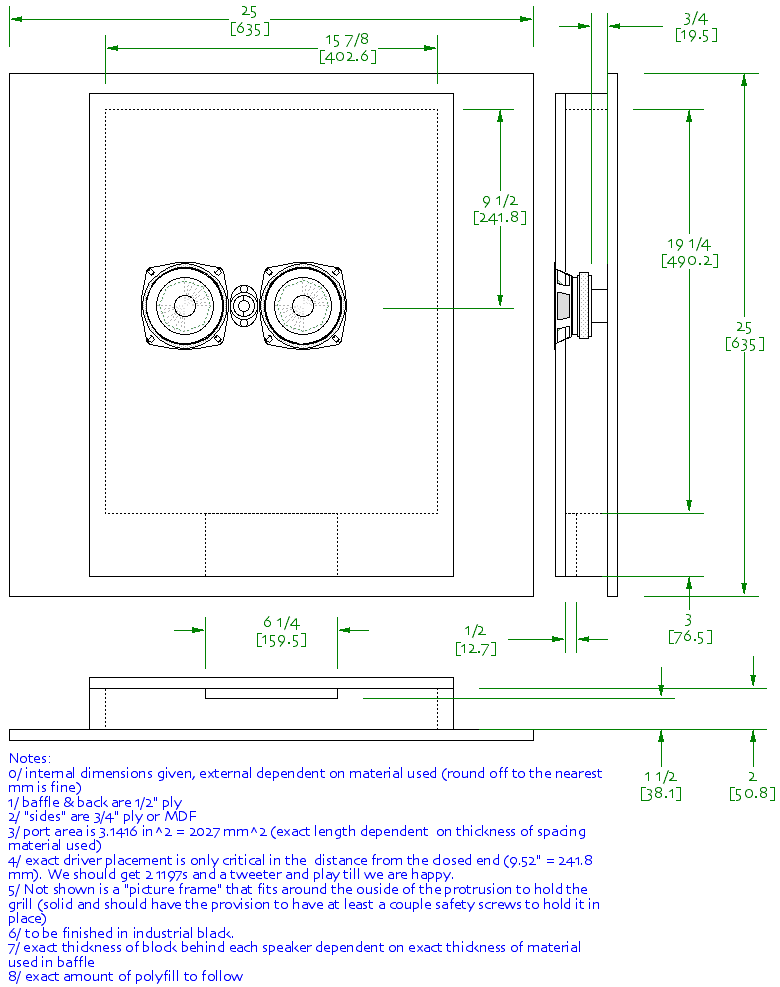

Greets!
Is this what you arrived at with the 40-1197? 'pancake' pipes?
GM
Nothing is ever black & white... the deeper you can make the cabs the lower yoou can push the effect of the damping. Treating the driver cone also helps. Making the back wall irregular helps (but tricky with no depth).
The PAWOs are 3/5" (89mm) deep. We have/had 2 pair, one with a 3/4" thick supra-baffle, and one without. There is a midrange coloration (hollowness) we attribute to the rear wall bounce in the one without. Either the extra 3/4" made enuff difference to push the LF corner, or the MDF on the back panel of one without (vrs BB on the other) is the culprit. We'll know for sure once we have added a supraBaffle to the mules.
dave
dave

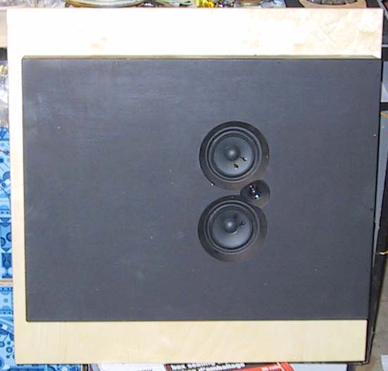

GM said:Is this what you arrived at with the 40-1197? 'pancake' pipes?
Yes, we used that technique there (as well as puzzlecoating the cones). I learned the trick from Bill Perkins, who was using it 30+ years ago, to try to achieve a Nautilus-like 1/2 wl line characteristic in his midrange cabs (at the time he was working on an improved design loosely based on the then popular Radford S90.
I've been playing around with it since then, and as a matter of course line critical walls with 1/4-1/2" wool or cotton felt before adding any polyfluff (if any)
dave
PS: GM is talking about a quad of ceiling speakers i made based on his bipolar 1197 centre channel ML-TL design (which works better than the MTM by a bit). BTW all 4 of these could likely be picked up for a song by anyone in LA willing to drive by and pick them up.
