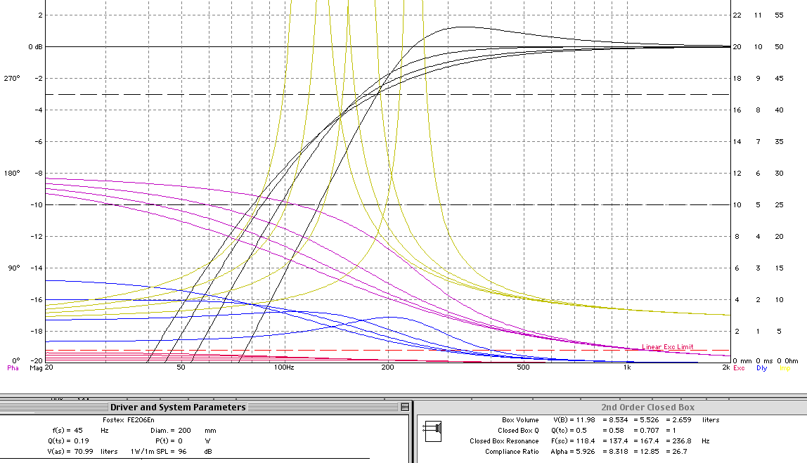

I have a pair of Fostex FE206en full range drivers, which I previously installed into a pair of self-made double bass reflex type floorstanding enclosures. They were fine for a time but have been sat for a couple of years unused gathering dust.
I’m looking to re-use the drivers by sealing them up in small stand mount boxes, using a couple of separate powered woofers to fill in the bass.
Can anyone recommend a suitably small enclosure size?

About 5 litres damped… with that small a box you may have issues fitting the driver in the box. XO 2nd order to the woofers at about 165Hz.

if the amp driving the 206en has low output impedance, than a 250uF low loss capacitor could kick up the 100Hz output using a 5 liter closed box;

Wow that’s small! 5 litres internal volume? So roughly a 20cm cube made with 15mm mdf.
I was thinking a little bigger - maybe around 15litres?
Is there anything in that range that would work?
5 litres requiring careful consideration of the volume of the actual driver. As volume goes up the box Q drops (unless you do as GM suggests), eventually very slowly. A slower rolloff means a less easy to deal with natural rolloff if you want ot use it as part of the filter.

Here are the 9 Litre vented dFonken Centre channel box for the FE206En.
http://www.planet10-hifi.com/downloads/dFonken206-centre-190118.pdf
Intended for those who have FE206En in big horns for L+R. But will give an idea of a vented box that works. Meant for a typical amplifier. F10 about 90 Hz.
