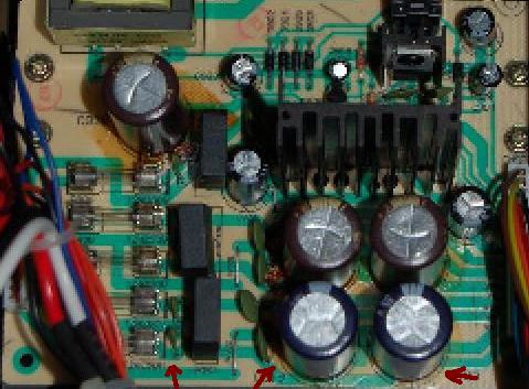

First up is a photo of the stock power supply which uses inexpensive Wincap electrolytics and ceramic bypasses for the audio rails, as well as a generic bridge rectifier.

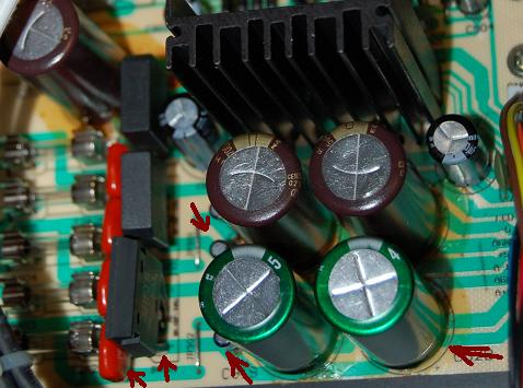

Did the following parts upgrades on the main PS board:
1. Removed the ceramic capacitors right before the Bridge rectifiers and replaced with Polypropylene radial caps(orange).
2. Replaced the #1 bridge rectifier with an IXYS FRED bridge.
3. Replaced the ceramic bypass caps with B.G. NX types.
4. Replaced large cheap electrolytics with Nichicon Muse series.
After a couple days running -in, while playing familiar tracks I noticed what I perceive as an improvement in dynamics and it sounds as if the noise floor is lower (silences between notes seem cleaner); Overall a subtle but noticeable improvement.
Next up is Phase 2, the capacitors around the voltage regulators on the audio board...
-chas

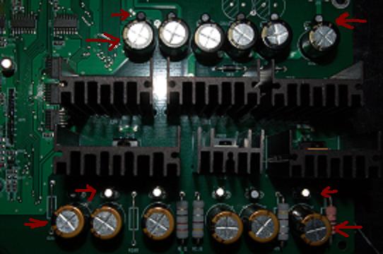

Phase 2
Here is a photo of the main audio board, which uses inexpensive electrolytic capacitors and ceramic bypasses both before and after the voltage regulators, which are decently decoupled otherwise.
There is definitely an opportunity here for improvements in both quality and quantity of capacitance used here, in my opinion.
I will be selecting the parts on the basis of cost-to-benefit as perceived from prior experience with disc player and power amp mods.
-chas

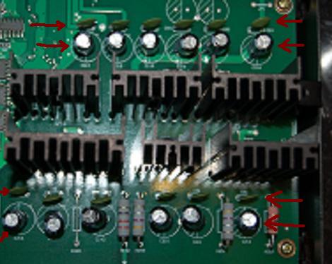

Did the following parts upgrades around the voltage regulators on the main audio board:
1. Removed and replaced the large electrolytics with Nichicon Muse series.
2. Replaced ceramic bypass caps with B.G. NX series caps.
Continuing this upgrade will be replacement of the local decoupling and bypass capacitors in the audio section.
-chas

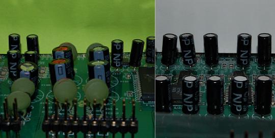

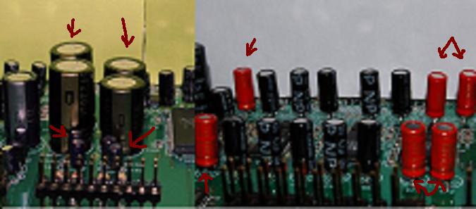

Phase 3
Here is a photo of the audio section, which uses inexpensive electrolytic capacitors and ceramic bypasses for local decoupling and bypasses, along with generic non-polar electrolytics for input and output coupling in the line stage.
Again, another opportunity for better quality parts, as the circuit design is quite nice, using a digitally-controlled analog (resistors) volume control and OPA2134AU op amps.
-chas
-chas
Completed these parts upgrades on the main audio board around the audio section:
1. Replaced inexpensive electrolytic caps, used in decoupling network around audio stage, with B.G. FK series and Nichicon Muse series for the other circuits.
2. Replaced ceramic bypass caps with B.G. NX series (all stages).
3. Replaced generic non-polar caps, used for signal input/output coupling, with B.G. N series (front channels).
4. The line stage op amps are biased into class-A, using 4.7k resistors between the output and V-, at about 2.7ma.
BTW, values for many of the power supply decoupling caps were increased from 20-50%, for improved filtering.
Completed unit has been running-in for some time, although I understand that capacitors-especially Black Gates- require some time to sound their best.
I can already tell that the sound has been improved noticeably, especially in clarity, dynamics and image specificity within the broader, deeper soundstage; Furthermore, the sound is now more "open" and, as best as I can describe it, "flows" with an effortlessness reminiscent of good tubed gear, yet retains the bass control and treble clarity of good solid-state.
Once fully broken in I hope to do more critical listening with familiar tracks to see how much better it gets.
Anyone else out there have one of these, and if unmodded, how do you like the sound of the stock unit?
-chas
