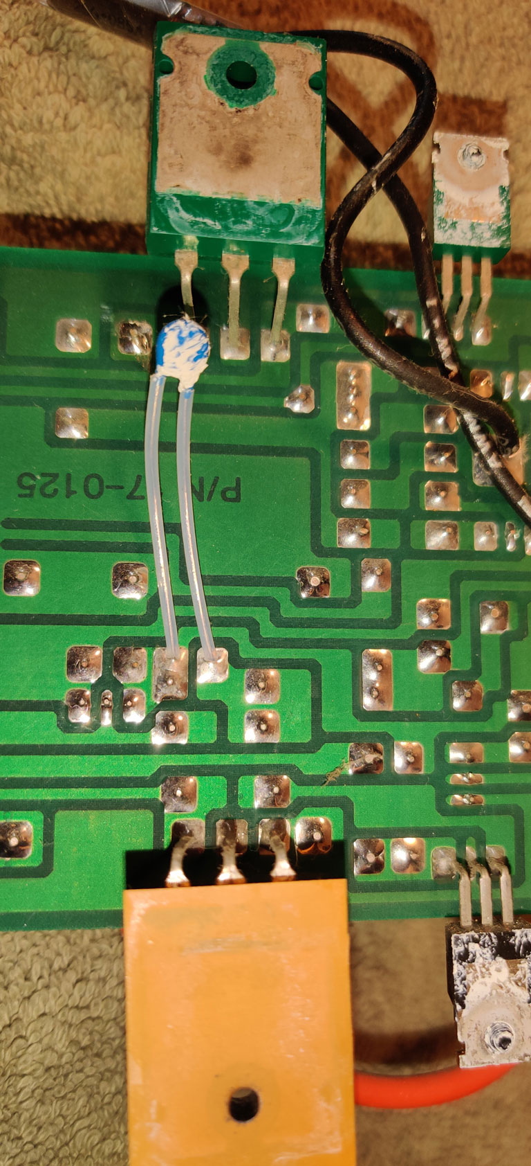

Ok. Very nice!!! So I tested. Results are below. On the bad side of the amp, one of the resistors showed 0. And then it went to a higher measurement. then the top leg came off. I was figuring it was a cold solder joint but now I know.
Meter set to VDC 200mv
Left side (good side)
Top Row: 43.3, 50.1, 43.3, 41.1, 47.8
Bottom Row: 34.8, 41.1, 47.7, 30.9, 71.1
Right side (bad side)
Top Row: 66.0, 56.4, 50.3, 0, 39.5
Bottom Row: 47.5, 46.6, 47.2, 38.9, 42.2
Here is a picture of the broken one: Shared album - Ed Rockwell - Google Photos
Do all the values look good except for the one that came off?

do you know how to dismantle output transistors (together with pcb) from heatsink , and later to clean old and re-new goop and put transistors back ?
and , considering that sooner or later , all externally linked pics are going to vanish - show some respect to collective - shrink them properly and attach here

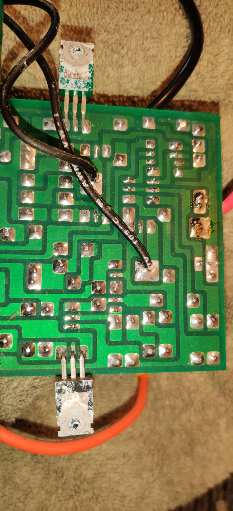

big ones - just unbolt and you're good - no special process with putting them back , because they have silycone pads , no goop
smaller ones - also unbo;t , but you need to clean them , mica pad and heatsink from old goop and apply new, when putting everything back ( at least , by pictures it seems they have white goop applied)
idea is to dismantle bad channel pcb and inspect all solder joints and renew them; if in doubt , just suck old solder and solder again .....
post pics of copper side , when you are in process
one thing more - I hate to see bolt directly on transistor case , without any washer ..... if bolt length permits - put both big washer and split washer , on each ttransistor

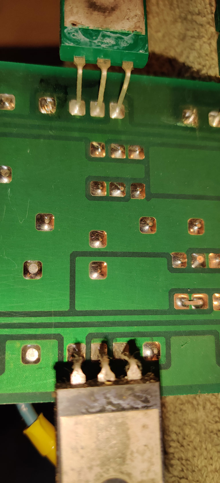

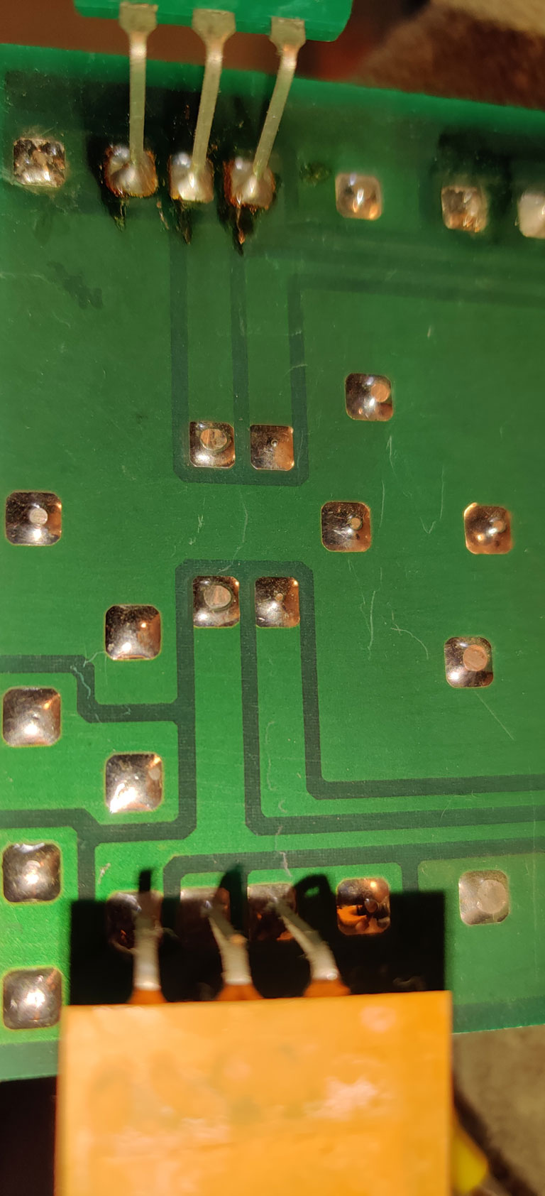

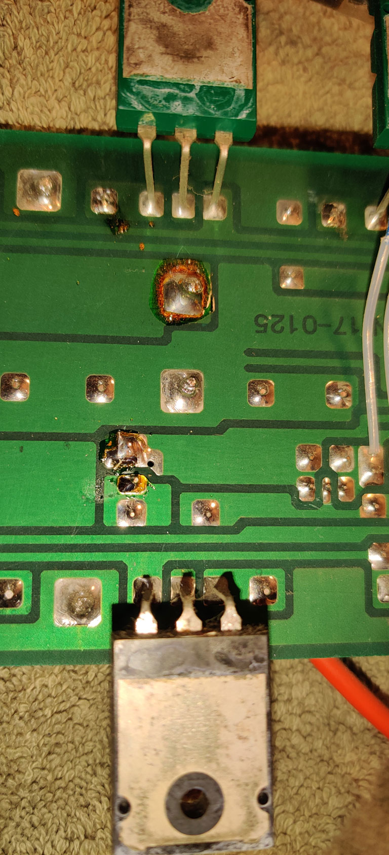

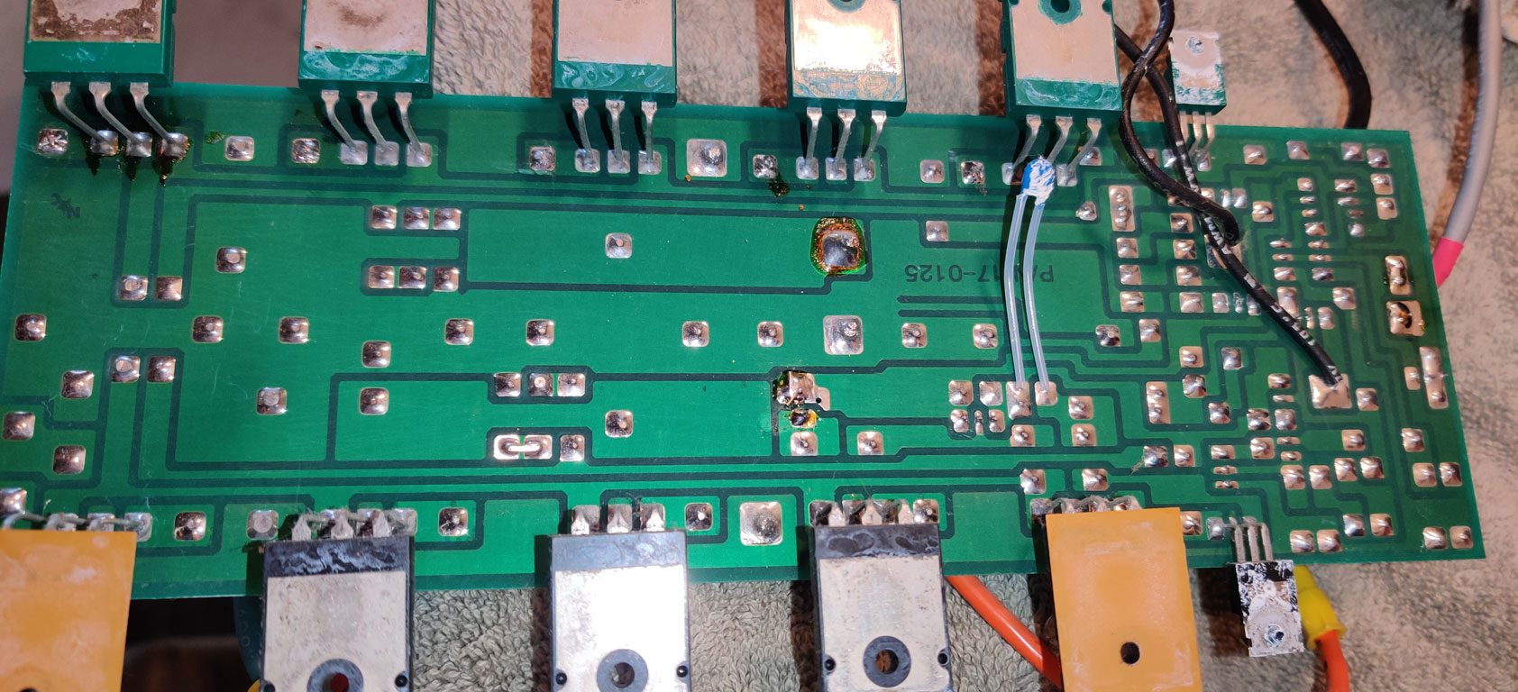

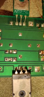

Here are photos of the copper side (as you call it). I'll inspect closer as well. Should I replace/verify anything else before I fix the resistor and put washer/lock on the transistor case and button it back up? I'll move on to the other side and verify the soldier joints there as well.
I found 3 other cold solder joints that I repaired as well.
Per request, see attached pics.

So, I've completed the other side. there looked to be a couple cold solder joints that I touched up.
Am I good to power it up @ZenMod
Ed
Ed

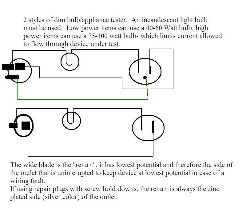

don't forget to clear old/put new thermal goop to smaller transistors , and do the same for these thermistors (blob with long legs) , straighten their legs a little to be sure that they're in contact with heatsink when everything is in place
after montage , check mid pin of each big transistor for shorts with heatsink
if good , power up , preferably with Bulb tester , for first time

Thank you ZM for your help!!! All went as planned. Since I work in the computer field, I had heatsink compound. Used that on the small transistors and the thermistors (the thingy with legs that was just leaning against the heatsink).
The large transistors I didn't add any compound to. If there was some on them, it may have been part of the silicone pads.
On the right (bad) channel, I think I fixed something like 4-5 cold solder joints. On the left (goodish) channel, I fixed 3-4 (I think) bad solder joints.
I had a lightbulb ready to go but... Forgot to put it inline. But, I was very careful and remembered what I had to take apart (with lots of pics).
I hooked it back up and she just sang like the old days!! I listened for a while with a critical ear and did not notice any issues.
I really really appreciate the help! I'll be donating to the forum shortly 🙂
