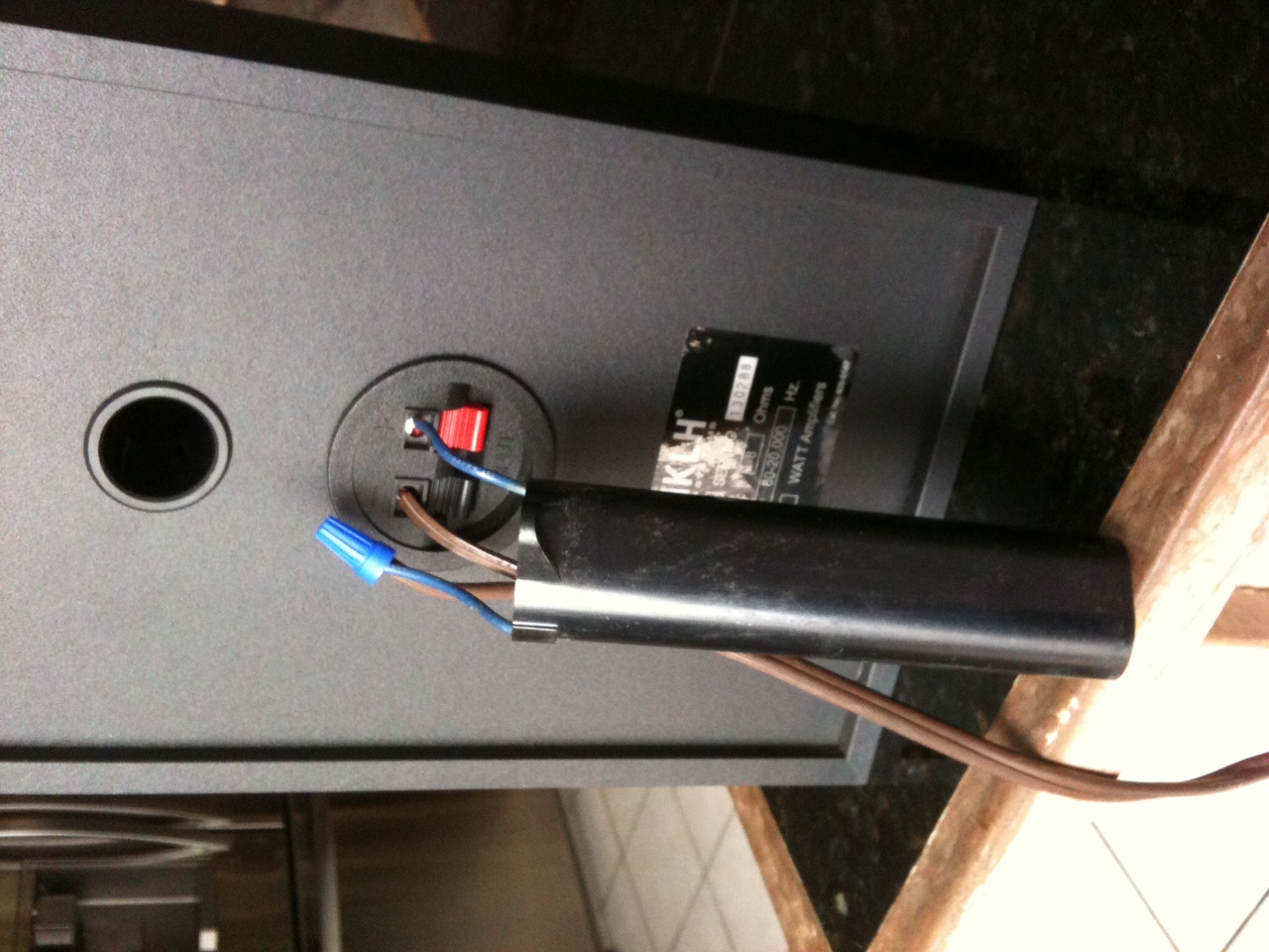

Here is a device I used successfully to get a handle on trouble amps. Amps that have DC offfset issues. Amps that run hot, fad in and fade out, take a while to warm up and stabilize, amps that won't turn on due to having their short circut protection activated, or that blow fuses either in the amp or in the speakers. It's basically a 250uf 250V film capacitor. 6" long and about 1.5" in dia. This is not an electrolytic cap, it's a film cap. It block the DC from going thru your speakers and shorting out your amp. amps run cooler since less current is flowing thru them. Granted, you ideally want to get your amp re-capped or repaired, but if you don't want to spend a few hundred dollars on repairs, this will do the trick. its good for about 100watts. If you need more watt handling, you will need 4 of them since you will have to series parallel them. Of course, the 250uf cap, will roll off the low end in the 70hz area. You can parallel 2 of them if you want to recover that. if you have 12inch speakers in a 2 cubic cabinet, this is a non issue since your speakers can't reproduce below 70hz anyway. if you get the series parallel version you can battery bias them. I have a few of these and I am selling them dirt cheap to my forum buddies. In the pic, the cap is installed in line, on some 6" woofer bookshelf speakers powered by a 200W class A amp that has a DC offset issue. it's simple and it works. you can build a box for it, install it in your speakers, or just connect it in line like the photo below. keep that vintage amp going , buy your self some time.
1 pair, 20 bucks plus 7 bucks to ship - great for 100watt amps and 2 cubic foot speakers that house a 12" woofer.
2 pairs, 40 bucks plus 7 bucks to ship - if you have a large speaker with 15" woofers, you can reproduce probally down to 40hz, so you will have to parallel 2 of them on each speaker.
4 pairs, 80 bucks plus 7 bucks to ship - if you have 12" or less woof's in a 2 cubic ft or less can and need to handle more than 100 watts, you need 4 per side to series parallel them. This will get you to a little ove 200 watts per channel.
8 pairs, 160 bucks plus 7 bucks to ship - you need 8 per side if you have 15" woofers in a large cabinet and want to recover frequencies down to 40hz and you need more than 200watts power handling.
email mail me if you want one.

Wouldn't it make more sense to repair the broken amplifier rather than add a bunch of Band-Aids?

sure....if you can do it yourself...and/or can afford the rates. recent example...an amp bought used for 300 bucks.....costs to repair in the nyc area 385.....or use a dc blocking capacitor solution....medium size speakers at 8 ohms...1 pair of caps ....costs of 20 bucks plus 7 to ship...amp has been working for months with no issues.
it's not the ideal perfect world solution...but it works.

sure it would work with a smaller cap, but the lower the voltage, the lower the power rating.
as far as costs, take a quick look to find a film cap in the 250uf value range, it will surprise you. I bought 4 30uf film caps for 40 bucks recently, 10 6uf film caps for 25 bucks. I think, you will find, 10 bucks for a 250uf 250volt film cap is a bargain. you don't want to use electrolytic caps. the sound quality is very poor and they break down very quickly. If you want to use electrolytic's, you can get a 250uf 100volt bi polar cap from partsexpress for 4 bucks.
