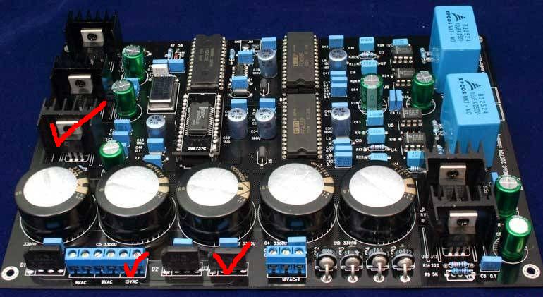

Well, we bought two of them and both has the same fatal for sound error: instead of -12V analog supply for PCM58 there's only -5V. It still works but completely out of parameters. You can easily check your KIT for this BAG - just compare resistors value near 3xLM317 stabilizers and if they all the same ( blue-white-black-black = 690 oHm and red-red-black-black= 220 ohm) then you are in
! Or just check U on pins 9 or 20 of PCM58. Please, note that LM317 is POSITIVE stabilizer but in spite of this it is in NEGATIVE configuration (on attached picture there's stabiliser on right side of board just near the 3300uF Kenwood (Elna) capacitor). All you have to do is to change resistores value: 690 ohm on 1,3 kOm and 220 ohm on 150 ohm (1%) and you will be suprised

As this post reffered to another forums too I want to define more exactly:
The PCM58 chip has four power supplies: +5v digital on pins 2 & 13 and -12 analog on pins 9 & 20. Negative supply on pins 9 & 20 goes direcrly from "-" of diode bridge (checked red on attached picture) and output of LM317 (checked red) positive regulator that responds on -12V attached to the "common" ("ground"). This is correct configuration.
The only thing is that person who assemble this DAC put incorrect values of resistors to this regulator. If you read on pins 9, 20 the same -5v as on mine board then change resistor from OUTPUT pin of marked LM317 to ADJ pin to 150 ohm (1%) and from ADJ pin to ground to 1300 ohm (1%). After doing that BEFORE you'll put the mains on UNPLUG carefully the PCM58 chips from their sockets, then put the mains on and check your voltage on pins 9 or 20, it has to be someting like -12,1 v (and it's O.K. between 11 - 13V as max permissible as meanwhile you are happy with -5v
). If it's O.K. then put PCM58 back at their homes and now compare the sound with your favourite CD. Enjoy!
