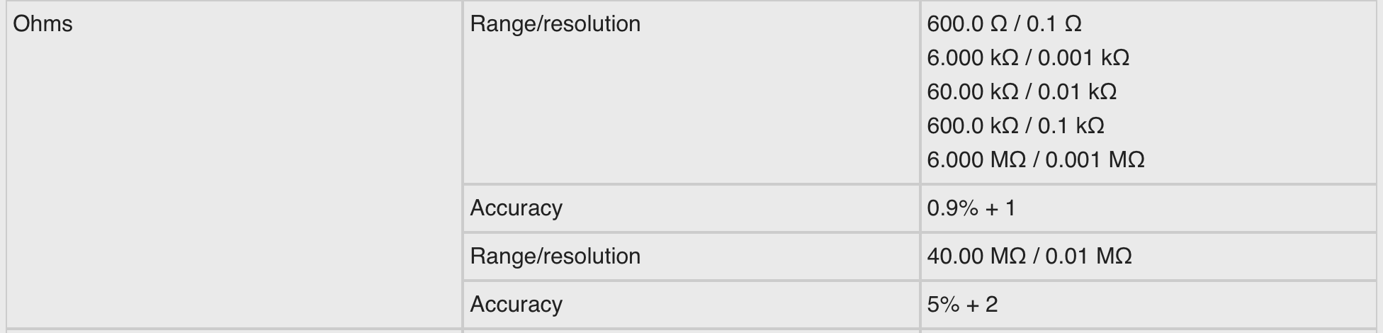

I cannot figure out how to get an accurate measurement of a .47 3 watt resistor and a .56 3 watt resistor.
.47 3watt; cpf3r47000jnb14 and erx-3sjr47v
.56 3watt; rro3jr56tb
The .47 measure .6 sometimes .5. The .56 measure .7 sometimes .6. Is this as close as I can get with this type of mulimeter?

Range/resolution | 600.0 Ω / 0.1 Ω resolution 6.000 kΩ / 0.001 kΩ 60.00 kΩ / 0.01 kΩ 600.0 kΩ / 0.1 kΩ 6.000 MΩ / 0.001 MΩ |
Accuracy | 0.9% + 1 |
Measuring low resistance resistors (say <10 Ω) can be a challenge with hand-held multimeters. The contact resistance between the probes and the resistor leads will vary depending on how you hold the probes to the leads, contact pressure, etc. Then add that the meter isn't terribly accurate at low resistances either. Below is from Fluke's website:
If I interpret this correctly, you have 0.1 Ω resolution at the lowest range, 0.9% + 1 digit accuracy. So a 1.00 Ω resistor may read 0.8-1.1 Ω on the display.
If you want greater precision measurements of low-ohm resistors you should look into setting up a 4-wire measurement.
Tom

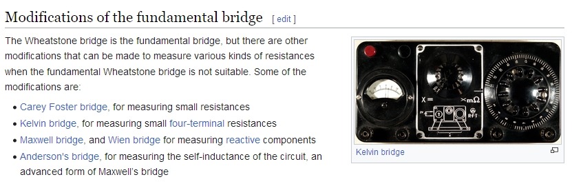

The Wheatstone bridge is one approach. I was referring to 4-wire sensing (aka Kelvin sensing) though: https://en.wikipedia.org/wiki/Four-terminal_sensing Many bench top DMMs (such as the HP 34401A) offer 4-wire sensing.

The Wheatstone bridge would be a good option if you're trying to match the resistors but don't care so much about their absolute value.
Tom

Thanks Tom, I'll have a closer look at all the variations. I wasn't aware of their existance and love the look of these old instruments.
