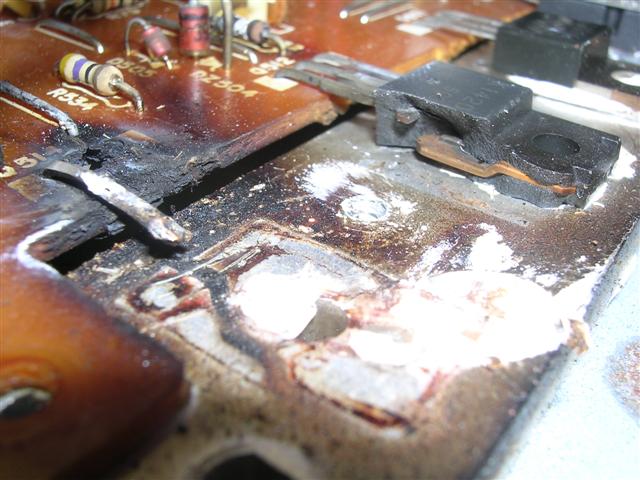

my friend gave me a broken mosfet amp...to see what's the problem...
well...some of the transistors were blown up totally
i really know nothing about mosfets...
the amp is 100Wx2 (stereo)...both sides are dead...
the blown trans. were k1420 ( 2sk1420 ?? )
or... at least 2 of the 4...
the other two were blown up to pieces...hehehe....I could'nt recognize them.... 😕
i think they were k1420 too....

Very nice of Derguteton to help with this. I get the feeling these particular MOSFET's might be out of production. That was a cool picture of the blowup. Is this thing a complementary design? Are ther 2SJ's in there too?

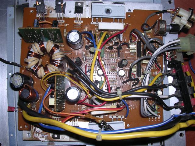

btw, the amp is a car amp- "JENSEN ALX2000" or something like that 😀
hmm...i really hope that these transistors are the only problem...
what do you think?
everything on the board looks good...not black or something like that...
what do you think i need to test first?

.....Hmmmmmm, the explosions seemed to be in the vicinity of what looks like the power supply. That would make sense that they'd all be N-Channel MOSFETS. ....although, lot's of car amps don't use complementary outputs (K's and J's). These switcher supplies don't really reliably start with slowly feeding them a ascending DC voltage. I would at least check your output devices (The one's that don't look blown up under the heat spreaders.) and rectifiers. If the output transistors (or rectifiers) are shorted, the power supply' new devices might re-fry trying to dump into a still blown power amp section. If the output transistors are BJT's, you can lift the middle pin on all of the outputs (Collector), replace, your exploded components and fire it up and see if there is still a problem. If the power amp's output devices are MOSFET's, you might have to consult a datasheet and lift the Drains. Since you're paying for shipping and handling, you might consider getting extras

btw the output devices are KTD718(NPN) and KTB688(PNP)

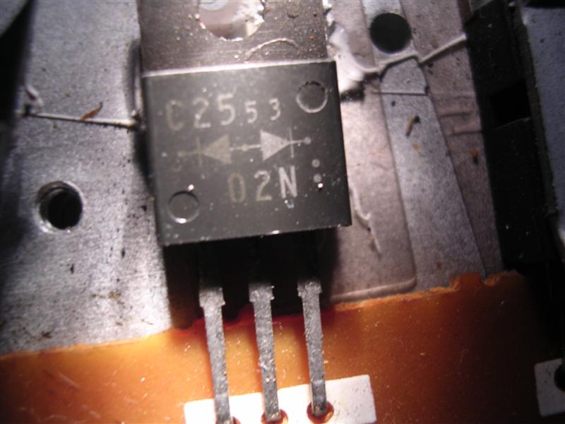

this ( 2sk1420 ?? ) >>>>>>>>>>>irfz44n is ok & are 4 pz. all same tipe
this c2553 02n>>>>>>>>>>>>>>>>> stpr1620ct or similar(200v_16A )

Yes, that thing in the picture you'll definitely want to check those. That is a a double diode with the anodes tied together. If those are shorted, you'll definitely want to change those before turning things on again. Make sure you replace those with equivilent or better. They'll be Shottky diodes. They're unique in that they are very fast. This is required because the power supply uses a high oscillation frequency. Anything with that double diode insignia will be important to check!!!
thank you rodolfo!
the part that i quoted is what i need but i need the oposite of it too...
i mean that the diodes are on the oposite side...
what is the name of that part?

OK....I have checked all the output transistors and the rectifier diodes...everything looks good, no short circuits......
anything else to check?
and..... can i use anything else instead of 2sk1420 or irfz44n ?
