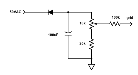

Too complicated. Since negatively biased grid draws no current, an adequate bias supply is a single diode charging a single capacitor. The capacitor is charged to peak voltage and maintains it. There is no ripple. This circuit was used in many commercial fixed bias amplifiers, for example Scott. If you want adjustable bias voltage, use transformer with secondary taps.
If one tube's limiting grid resistance value is 50K, for two parallel tubes it is 25K. You should seriously consider a grid choke.
The FWB rectifier circuit is fine, and will not have 60 Hz ripple like a half wave rectifier.
A half wave rectifier from a HV secondary tap is used in many circuits mainly for its low cost.
The resistive bias divider definitely does discharge the input capacitor, so there is 60 Hz voltage ripple.
There is indeed one 47k grid resistor per output tube, not per pair, in the circuit given.

Half-wave bias rectifier + capacitor will not have any ripple at all. No current, no ripple. Capacitor charges to the peak voltage and maintains it, since there is no discharge current.
So in this example bias circuit, you say there is NO ripple, and no discharge current from the capacitor?
At 60 Hz line frequency, and for t = 0 to 16.7mS (one cycle), at max voltage setting of the bias pot, we have:
Vout = 50 * sqrt (2) * e^( - t / ( 30k * 100uF ) )
That looks like voltage ripple to me, but it's been a long time since EE 101.
If you want to know how much ripple, plug in t = 16.7mS and see how much the bias voltage sags from (50 * sqrt 2 ) volts.
I get about 0.39 V sag in one cycle. That seems like ripple to me, in fact too much ripple.

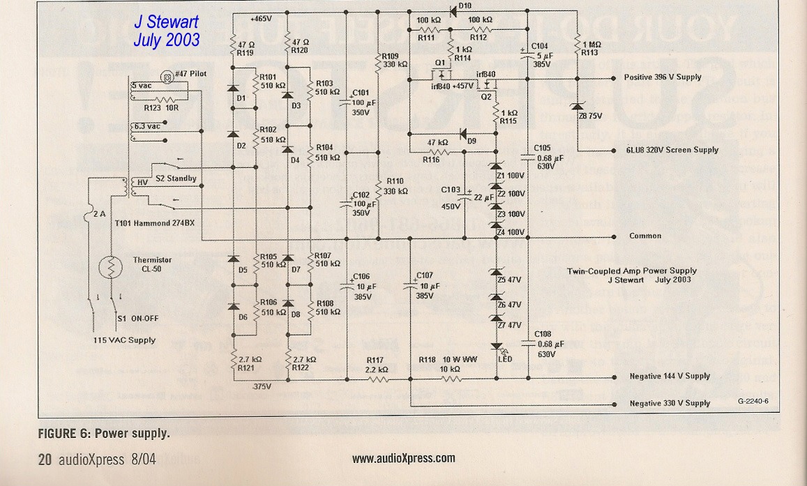

When designing the circuit, I was inspired by this site: https://www.valvewizard.co.uk/bias.html
I haven't used a separate transformer or a tap off the HV winding since just after the Earth cooled & there were Silicon rectifiers at reasonable cost.
The negative rail can easily be got to fill the requirements of most amplifiers from the same HV wdg as the B+.
The negative rail in the year 1965 Reg PS example provides the negative reference voltage & operating voltage for the AX7 error amplifier.
In the more recent supply the negative voltage supplies the tails of a 2-stage diff amp & negative bias to the amps PP 6LU8 output stage.

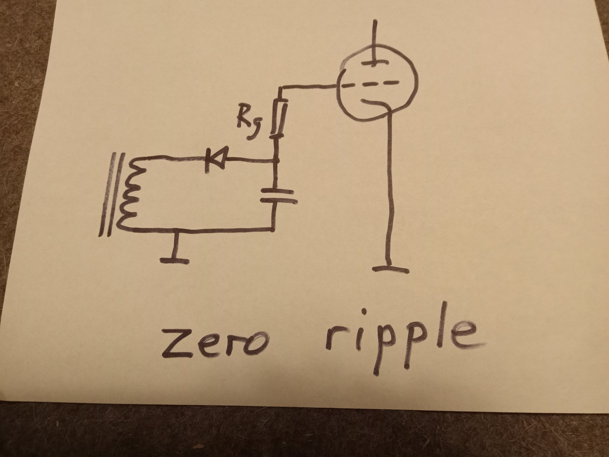

Zero ripple.
The interesting and simple solution.
Is this used in any tube amp? I have a few doubts:
  • Zero ripple is impossible to achieve. This is because it takes forever to fully charge a capacitor with pulsating current. However, the more time passes, the smaller the ripple will be. The LTSpice simulation shows 0.000008V PP after 8 minutes (cap: 100uF). My circuit provides 0.00006V PP.
  • There is no way to change the bias voltage.
  • Something to discharge the cap after the amplifier is turned off would be needed.
  • Grid current can be positive or negative (reverse). Sometimes the electrons flow into the grid, sometimes out of the grid. In the picture above (zero-ripple) electrons can only flow in one direction? Grid current is described in this post: https://www.diyaudio.com/community/...eed-grid-leak-resistance.261130/#post-4570389

sser2,
Congratulations, your scheme works.
But not very well . . .
Are you going to add or take turns off of the secondary to get the proper bias voltage you want.
That would be your special version of "fixed Adjustable bias".
Be sure to have individual transformers for each output tube (if you do not use extremely well matched output tubes).
A modern output tube with a transconductance of 10,000 microMhos will change plate current by 5mA if a single extra secondary turn adds 0.35Vrms, which would add 0.5VDC to the bias voltage.
(That is 0.5VDC bias per single secondary turn, most secondaries do not have that much voltage resolution)
Are you willing to go to that much trouble?
