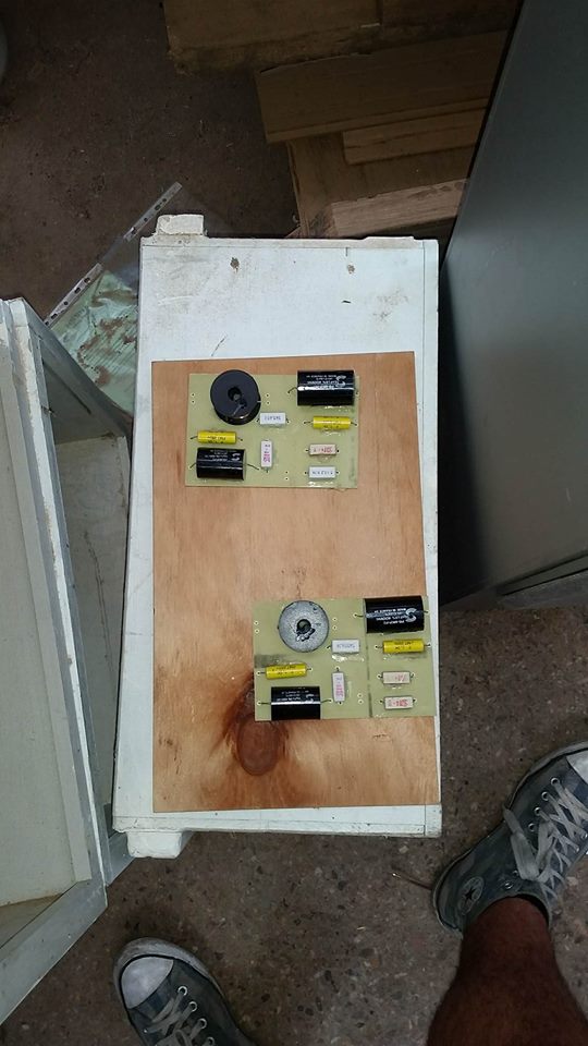

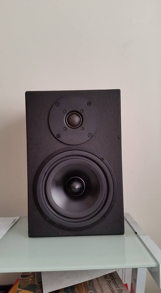

Hey guys,
I'm not exactly new to audio stuff in general, but this is the first time I've had a go at designing/building crossovers from scratch and finishing off some smaller full range enclosures to an acceptable level.
Basics are:
*Tweeter - Seas 27TFF
*Mids - Seas P17RE/P
*Crossovers: first order, l-pad attenuated tweeter, custom wound inductor, zobel-correct mids - all designed using this guide. I actually struggled with some of the numbers I was getting from measurements on the spreadsheet so I worked everything out by hand - chances are I was just doing something wrong but a 400uf capacitor for the zobel seemed a bit crazy 😱
*Enclosure: 17mm structural ply with ample bracing, 7.5L, airtight sealed with silicone internally, truck bed liner painted (what I'm most disappointed with - the finish didn't 'set' in 8hrs so I installed everything while it was a bit tacky. Probably did a great job for sealing around the tweeter, but not so much for random dust that got stuck in the paint).
Overall, pretty damn happy with how they turned out and a massive improvement over what I replaced (AIWA 2 ways that I've used daily for almost 12 years - they don't sound amazing but I haven't had a single issue with this or the attached amplifier). Anything below 60Hz is a bit lacking, so with the next few sets I'm building I will go bigger to either twin sealed mids, or porting a single.
I have one last question about crossover design - when calculating values for parallel/series mids, do you just treat the measured impedance and stated voice coil inductance as being twice/double, or would you double up on zobel/lpf components (ie. separate resistors/caps and inductors for both)?

FWIW the ESP article is a terrible guide to doing x/o's properly,
but a tour de force in describing some of the theory you do need.
The theory is fine, but not enough, for most practical examples.
The approach is too electrical, and not enough acoustics by far.
The theory you do need, look at designs at : Zaphaudio.com
rgds, sreten.

That's a very nice combo of drivers and a pretty decent build, even with the problems.
Personally I would have gone a little bigger on the cabinet (14L box with a 1.5" x 5" long port, tuned to 40 Hz) and you would have a competent full-range speaker, that's gets down into the mid-30's and wouldn't need a sub for music.
I would also agree with Sreten, that although the site you linked is good for the electrical XO theory, you might have left some performance on the table by not using a completely optimized XO design. Beauty of DIY...learn more every time you build.

Will do, thanks man.
Simple fix for next time is to flush mount the drivers. Particularly the tweeter. Zaph|Audio
I thought about that, but my portable router just broke and the table-mounted one is too unwieldy. Thankfully I found a hole saw the perfect size which made everything easy - for the next build I'll definitely be flush mounting everything to make it look a bit better.

I have another heap of these to build so definitely will be going ported with better crossovers - luckily I have a good bandpass sub that helps fill the gaps. The first one is a weird, 3D cross with a slanted face to be hung up inside a gym - we have one with 12 drivers already in my workshop and it sounds pretty good despite being sealed so I'm hoping that the bass response will be better with 3/4 the drivers.
Have you tried XSim? It's a great crossover simulator, and really helps learn about concepts. It makes a great experimental lab for crossovers and drivers.
Best,
Erik
Unfortunately I found this after I made all the boards and finished the inductors. I'll definitely be using this to design the next lot though!

Sometimes adding is easier than taking away.
If you get some 5mm MDF (or similarly easy to cut material) material, you can cut it to the correct shape with hand tools, then laminate it onto your existing baffle to get the drivers flush.
A layer of felt or similar would probably be better again, if you'd be happy with that appearance. I'm curious to try this myself, for some oval drivers that are difficult to flush mount neatly. I have some of this stuff to experiment with:

I've actually got a heap of 5mm MDF so that might be the way to go. I've had a quick look but can't find an 'easy' way route them in - I could have sworn I've seen some router bits with a bearing on top and a flat cutter (like a dado/spoil board bit) that would have worked but I can't see them anywhere in any of the online stores I normally look at.
Side note: anybody know something easier to paint them with? I'm guessing because the ply wasn't undercoated the paint just sank in and didn't keep any texture. I've seen a few different types of plasticized/rubberised paints for automotive purposes but wasn't sure which would work best.
Anything that's easy to finish will be ideal as I HATE painting haha
Router bits - maybe look at the CARB-I-TOOL catalogue.
I wouldn't bother, though: 5mm MDF is easy enough to cut with a Stanley knife or even a retractable knife from a $2 shop. Take it slowly, do each curve in multiple passes, cut ~1 mm deeper each time. It takes a few minutes, but less hassle easier than setting up a router, putting on a mask etc, then cleaning up afterwards.
Regarding paint - look at the Cannonsound website: DuraTex. That's meant to be easier to work with.
