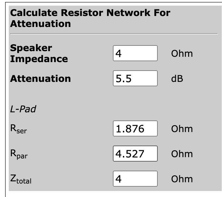

Maybe I'm missing something, but how do you plan to reduce the Woofer output by 5.5dB in a passive design to match the Midrange and not get a bump in the bass region? You'd have to design for burning off a lot of power when doing it passive...

Since it's 5.5dB too loud, I'd have used an L-Pad network in front of the speaker output (just 2 resistors, one in parallel, one serial to the speaker)
That woofer is a 4 ohm model but its SPL is measured at 2.83V, so it's really more like 88 dB/W. Still, @wgh52 has a point.

ah my bad, thought we were talking about the tweeter. With the woofer that's going to be more power ofc... with 8 ohm it's a 4 ohm and a 10 ohm resistor.

You don't want to pad the woofer! But you will loose 4-6 db due to baffle step loss anyways. Consider going with the 8 ohm version of the RS225.
