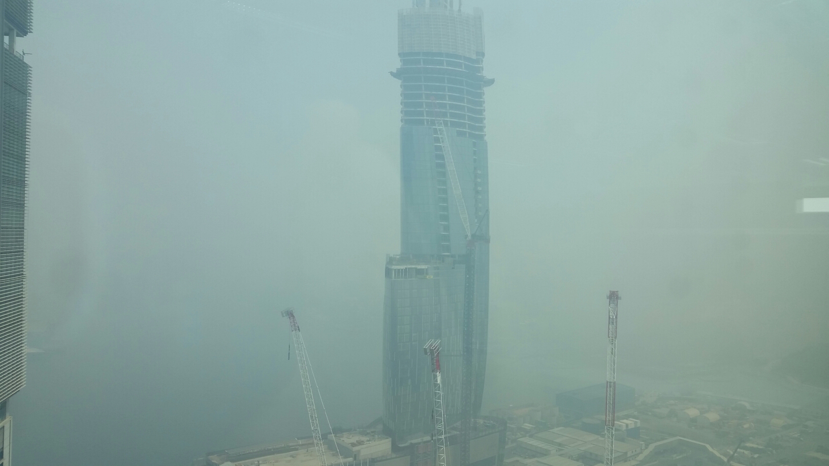

Hi Dave, things have not been too bad the last week or so, but we had two weeks of terrible smoke. At the moment it is just hot and muggy but no rain. Had a brief downpour on Christmas day but that's it.
Edit: two photos attached looking out the window at work. First was the worst I saw it get. Second on a fairly clear day for comparison.
Tony.

Edit: two photos attached...
Canberra today is even worse than your first photo.
I am lost for words.
