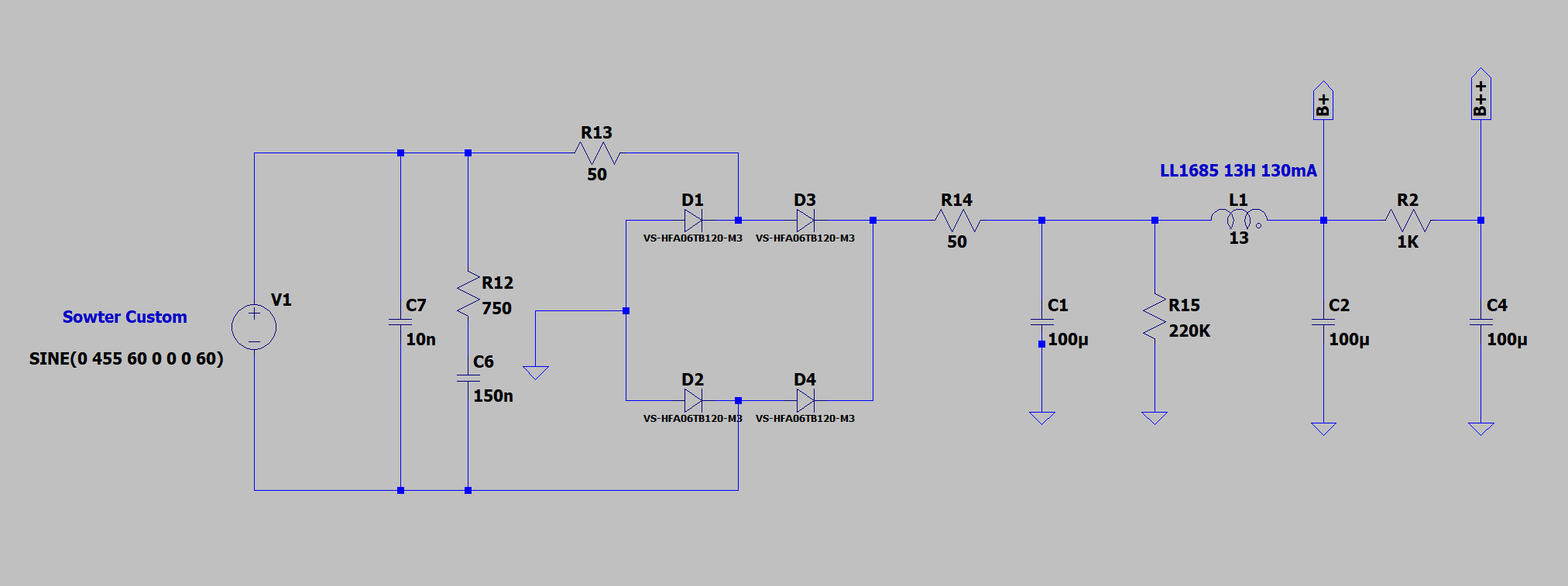

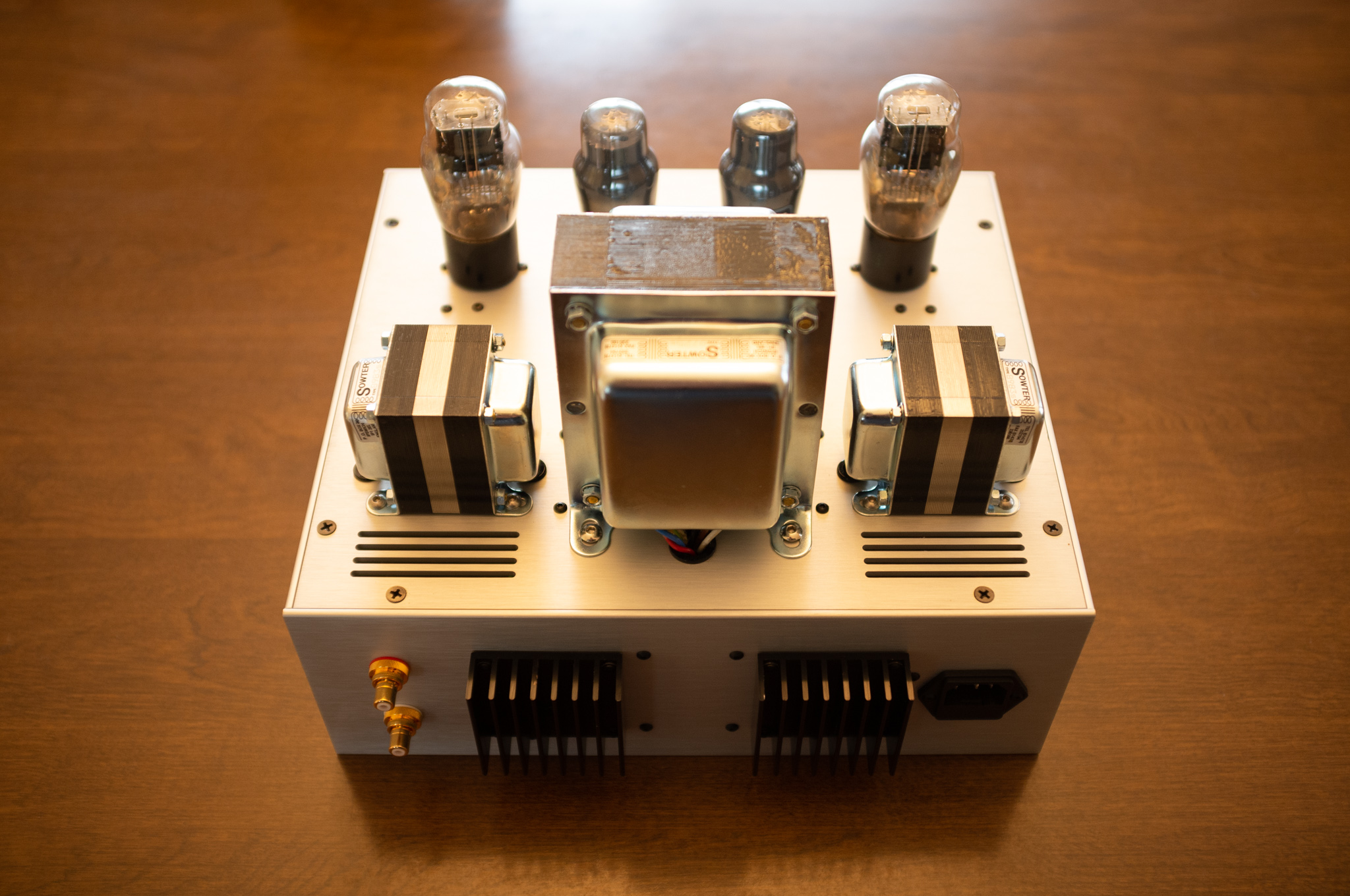

Finished my 45 parafeed headphone amp today, nothing innovative, but wanted to share it, I think it turned out well. Been at this hobby since January, so this is my second from scratch design-to-build amplifier, the other being a 6A5G-based SET.
It is a MOSFET cascdoe CCS loaded 6J5 input, MOSFET cascode CCS loaded 45 output parafeed design for high-end headphones. Mains transformer is a custom job by Sowter to my spec, OPT are Sowter 8983. Filament regulators are Rod Coleman's, coupling and parafeed caps are Rike Audio S-Cap 2 (paper, poly, aluminum, oil). Power supply is a single rail CLCRC.
Here is the schematic, although it is not comprehensive. Parafeed capacitance was determined experimentally by taking FR sweeps of various capacitances (courtesy of cheap Solen caps), along with subjective listening impressions. Ultimately decided on 6.6uF made up of two 3.3uF in parallel.
Bias points:
6J5 B+: 380V
6J5 plate to cathode: 200V
6J5 cathode: 6.2V
6J5 plate current: 8.5mA
45 B+: 398V
45 plate to cathode: 206V
45 cathode: 35.5V
45 plate current: 35mA

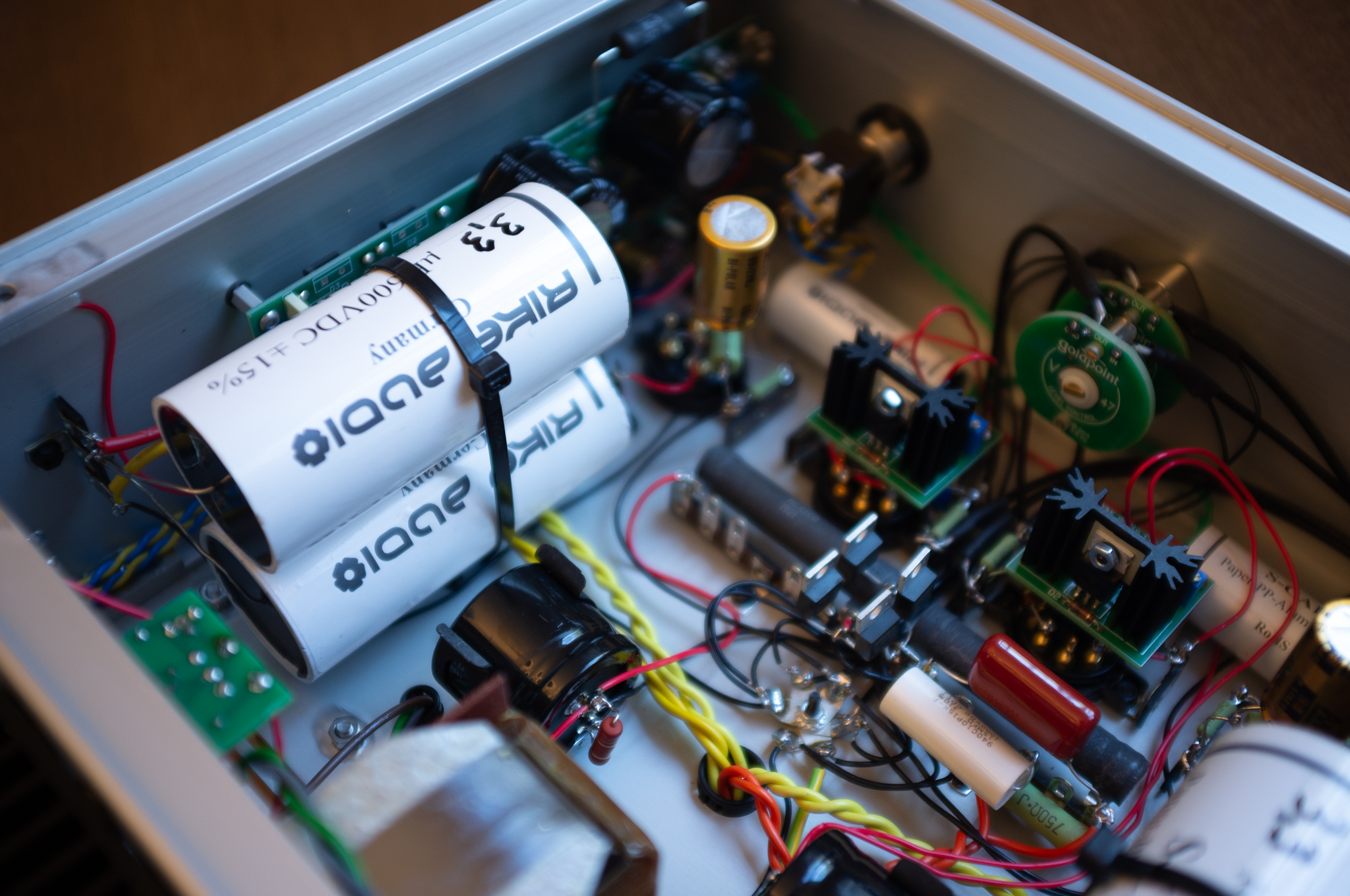

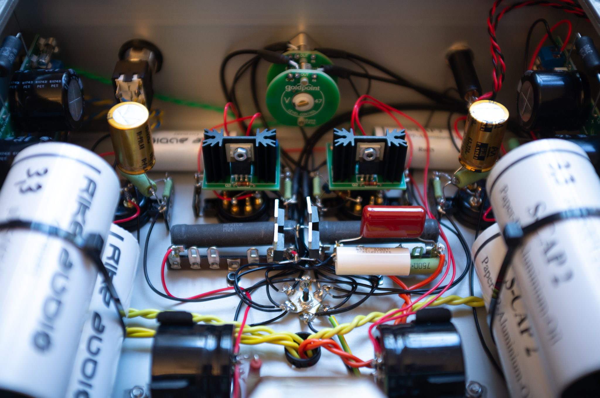

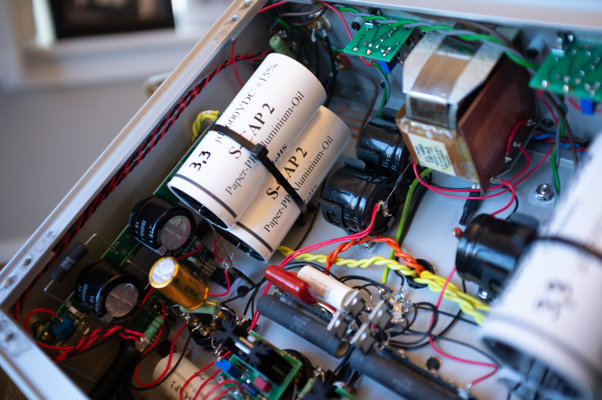

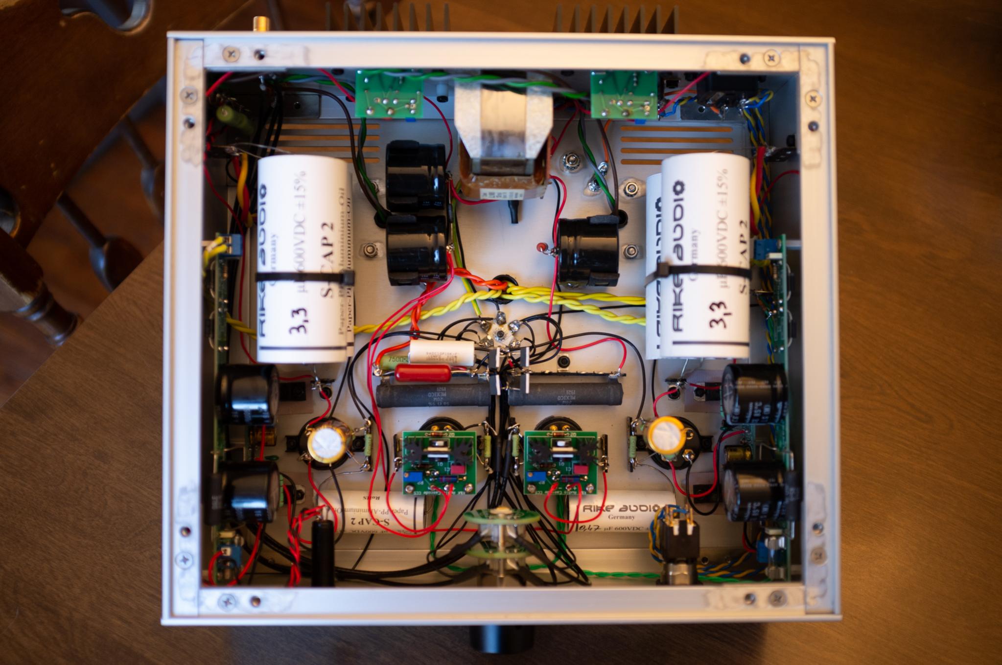

Here are some shots of the interior. Bottom plate is perforated aluminum sheet for ventilation.

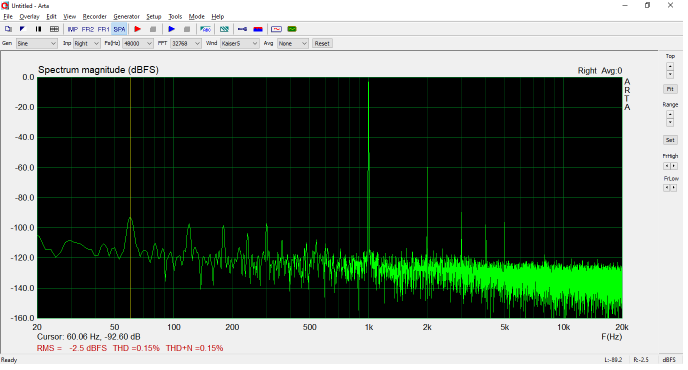

Here is a FFT of the left channel at 350mV into 300ohms.

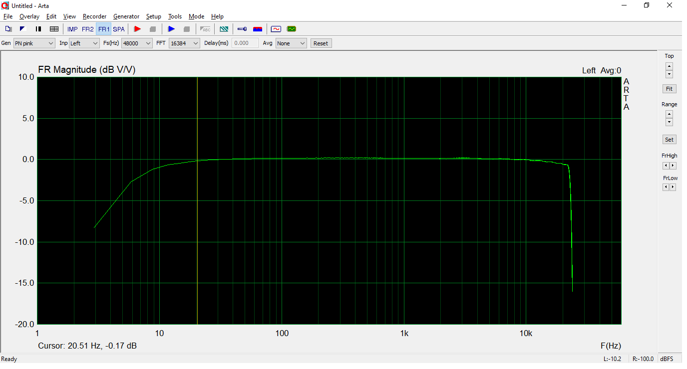

And the frequency response.

Hi L0rdGwyn,
Very nice build indeed. Just a quick question: why do you use two CCS’s in series? What’s the advantage when measuring (spectrum/THD) and when listening?
Regards, Gerrit

I love seeing what people make, nice! And a 45 to boot, wow. Can I ask where you sourced the spring clips holding down the black electrolytic caps? I need a bag of those.

Apologies if you are already aware of some of this, but the CCS load affords the triode a near ideal load, an "infinite" AC impedance (more on the order of 50Mohm), in parallel with the grid leak resistor of the following stage, this gives the 6J5 driver tube a near flat load line, which lowers second harmonic distortion. In addition, the CCS has exceptional PSRR. So from a listening standpoint, lower noise floor, lower distortion, better imaging, soundstage, and detail, from my listening.
Most parafeed builds use some sort of constant current source on the output tube plate, more common use is a plate choke, which allows the plate voltage to swing beyond the B+. The advantage of using a MOSFET CCS load here is higher PSRR than a plate choke and size. The disadvantage is a higher B+ requirement as this will determine the maximum plate voltage swing when the grid is at its most negative. The MOSFET CCS also has to dissipate a significant amount of heat, around 7W in my amp, which is why there are heat sinks mounted to the back of the chassis.

Thanks very much! And sure thing, they were very helpful in this build, nice to be able to mount a 35mm diameter cap with a single screw. They are pretty expensive though as far as parts go.
TH25 Cornell Dubilier - CDE | Mouser
This is actually a single current source with the two devices coupled through the gate resistor.
